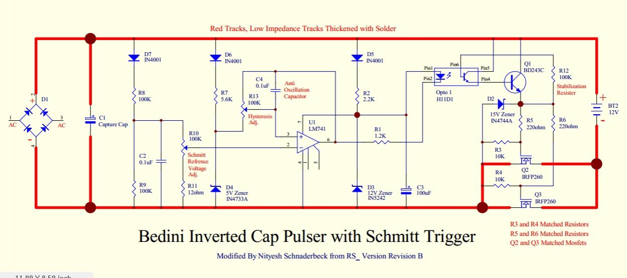

"RS_" and "Volty" you have spent a lot of effort on this circuit. And I could imagine that many experimenters have built this.
"RS_" you have modified the original non working circuit to a more functional circuit with many fixes, thankyou for the you time that you have spent on this.

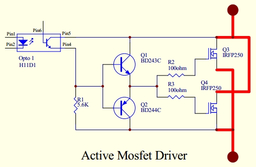

It could be possible that there are more modifications needed for this circuit. I do not know why "John Bedini" has this style of mosfet driver circuit. It really does not matter how you drive the mosfets, as long as you can achieve clean switching.
I have modified this circuit and converted the comparator to an adjustable schmitt trigger with adjustable hysteresis. With only 2 additional components(R13 and C4), it is a very easy mod. I have also added a stabilization resistor(R12) to help stop "Opto 1(H11D1)" from false triggering and to improve switching.
Bedini Inverted Cap Pulser with Schmitt Trigger.pdf
So for those who have built this circuit, all they have to do is add 3 components. So you can have an adjustable charge threshold and an adjustable discharge threshold of the capture capacitor. The value of C4(The anti oscillation capacitor) may need experimenting with. As this op-amp based schmitt trigger can be vulnerable to oscillations if not designed properly.

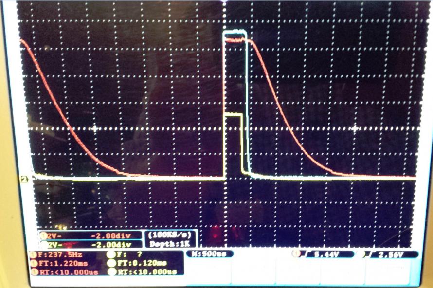

The scope across the capture capacitor will tell the truth of this mod.
