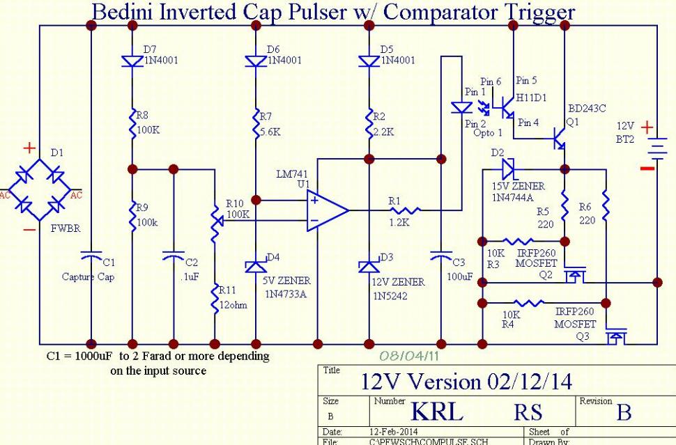

Hi adys15, the simplest solution to lower the pulse freq is making cap bigger. 2 times bigger = half freq. but not the pulse rate is important. try to get a discharge voltage of approx 24V !Originally posted by adys15 View Postthanks Tom,my meter is a analog ammeter and the dump is done once 2sec.so its not too fast.Do you know how to make the circuit discharge longer?
And another fact i figured out: The battery to cap ratio is 1Ah/ 3000 uF = 20Ah needs 60.000uF . just my experienced params - hope this can help...

Hi adys15,
I have been using the circuit you posted in post #13 of this thread. And with the battery and the caps I was using it was discharging not to the point I wanted. It was going down to 20 or 19 volts and I wanted it to go to 16 or 15 volts. After I played a little bit with it I changed the value of the C5 cap on that circuit first to 10uF, than to 50uF, 100uF, and 1000uf. In the circuit posted by RS that would be the capacitor C2.
With the 1000uF the ON time went to around 2 seconds which was too much. With that much time it discharged the cap to the battery voltage of course and the interesting was that the battery gets a punch from the cap discharge and than some radiant pulses during the rest of the ON time.
I say it was interesting but I don't think it is a desirable.
A 100uf in my case did what I wanted. Capacitors (a bank of 2200uf) filled to twice the battery voltage and than discharge them in a single pulse to a few volts above the battery voltage.
Hope that will help with what you are looking for or tune better your circuit.
In the Bedini Monopole 1 - Advanced section of the forum there are a few more threads about Cap Dump so you can read there as well and learn from the experience of other users.
Lman

Lman thanks very much i will try that.The circuit posted by me in post 13 has a flaw.Pin 5 of h11d1 and colector of bd243 should be conected to the +of the batery,like in RS's skematic,if conected after the 5w resistor,the freq of the coil interferes with the dump freq.red led blinks haotic

Thanks for telling me about the flow in that circuit. May be that was the reason that it was not discharging well at first as probably it did not open fully the gate of the MOSFET. But after I changed that C5 capacitor it was ok or at least it seems so. Since RS has been at the conference I believe his circuit is closer to the truth and I will have it in mind the next time I play again with the cap dump.

Lman,in the past i changed all the caps but they were small and noticed no change.Now i replaced the c5 with a 47u and the dump is longer now!!about 1secound....Now i can discharge 3A instead of 1.8,thanks verry much man!!!

Hi adys15,
I am glad that this helped you achieve what you were looking for, but do not get confused. It does not make the dump longer, it makes the On time on the inverted input longer. 1 second is wa-a-ay too much. I am sure that now your capacitor discharges to the battery voltage and that is not the way it should be. Plus all the components in the chain staying On for a whole second is a big loss of energy and time. People are dumping 3 times a second. Just make sure that you charge the cap to twice the battery voltage, the gate of the mosfet fully opens, and you discharge to a few volts above the battery voltage.

adys15,
You still wrongly call it a dump time while it is not. As hobbyrobotik said several posts ago we cannot control the discharge duration of the caps with the circuit. That depends on the capacitors themselves and their characteristics. Some capacitors discharge slower, some have lower ESR and discharge faster. The only other thing that comes to my mind regarding the discharge is the internal resistance of the MOSFET. John Bedini uses like 5 mosfets in parallel (matched) in his circuit not only to share the huge current spike between them but to lower the total internal resistance as well. At least I think so.
In my circuit I am using just one IRFP260 and I was happy that I managed to get a sharp pulse in the range of 100 milliseconds just by the look at the LED. If you manage to do the same you will get more pulses per certain amount of time. Otherwise your cap might discharge fast and the rest of the time you are seeing that LED lit and all the components wasting the energy instead of filling the cap again. Hope you get it now.
