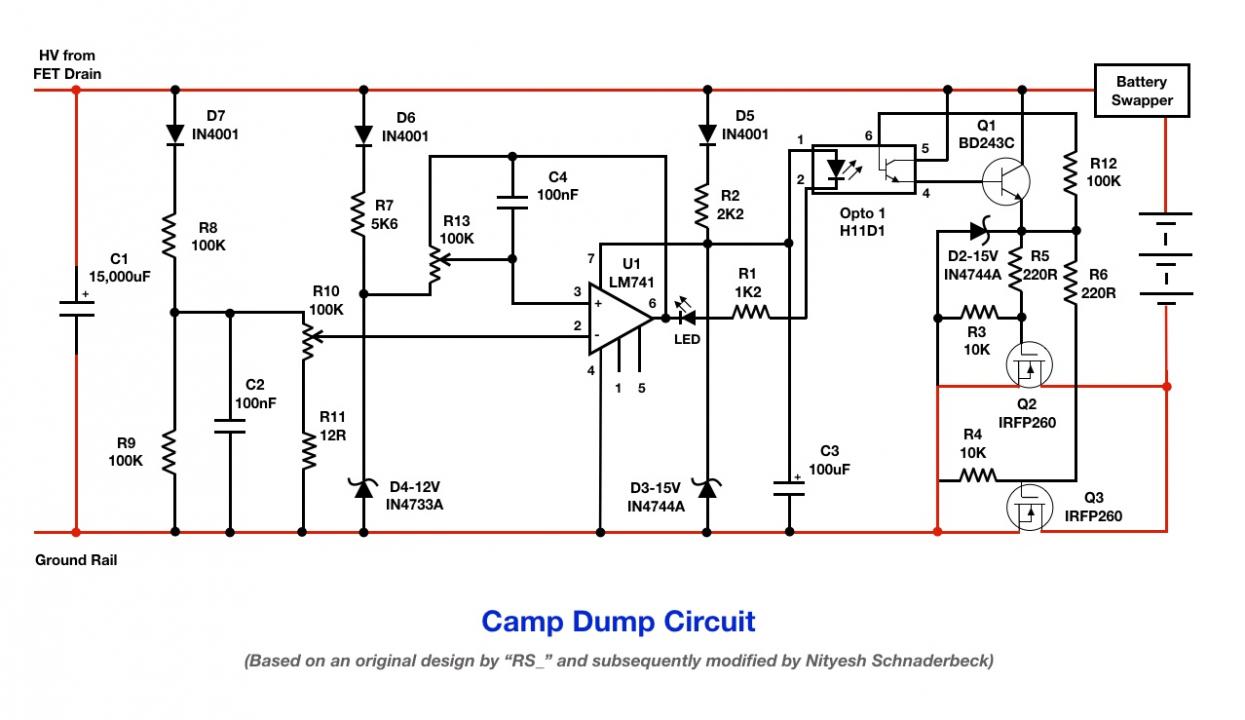

Thanks for all that information and the 12V Circuit.

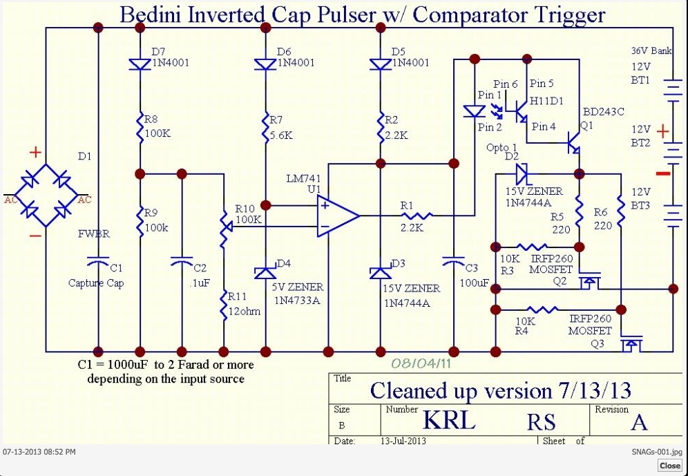

I have 2 Questions please:
I am not sure how the Opto is connected.
Pin5 -> + charging
Pin4 -> Base Q1
Pin6 -> "nothing"
Pin1 ??
Pin2 ??

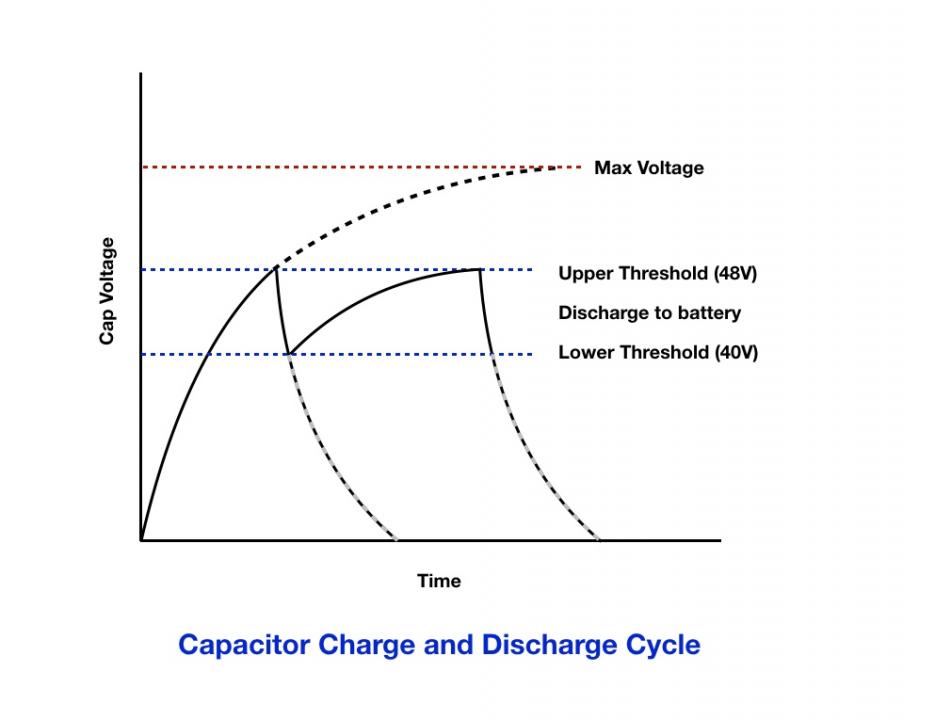

second:
Is there a different if i use my SSG with or without the cap dump on the charging battery? Charges faster or what does it do?
Thanks so much.
