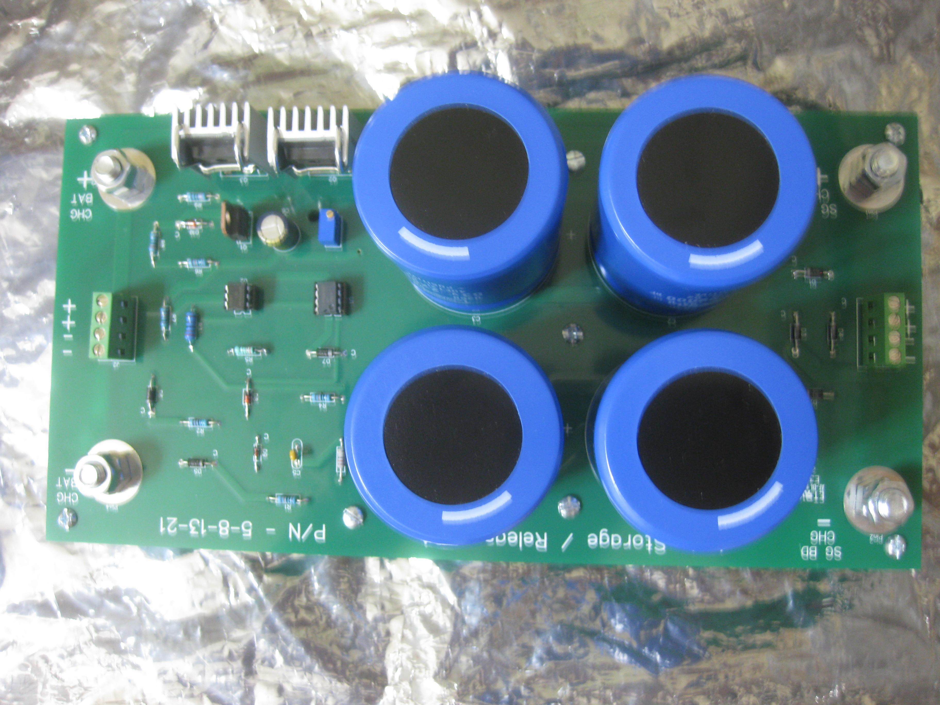

For the FET's it really depends on how much current you capacitors are going to store before
you let them dump. I used a part that was rated at 200 volts @ 130 Amps. The IRFP260MPBF
will be fine if your capacitor total is not to big.
It is best if all the capacitors are rated at the same voltage. I used four totaling 88,000 ufd.
The voltage rating was 63 volts. See my completed board assembly running on AC house
current. It also works off the back of the SG Machine.
James McDonald

thank you much for the pic. I redraw the SNAGs-002 diagram back to Altium Designer and my friend will help me with PCB design and milling.
By the way do you have *.PcbDoc or *.SchDoc of yours ? Would help a lot ,I have issues with parts library in altium. The schematic is ok , but the PCB part ,oh boy...
