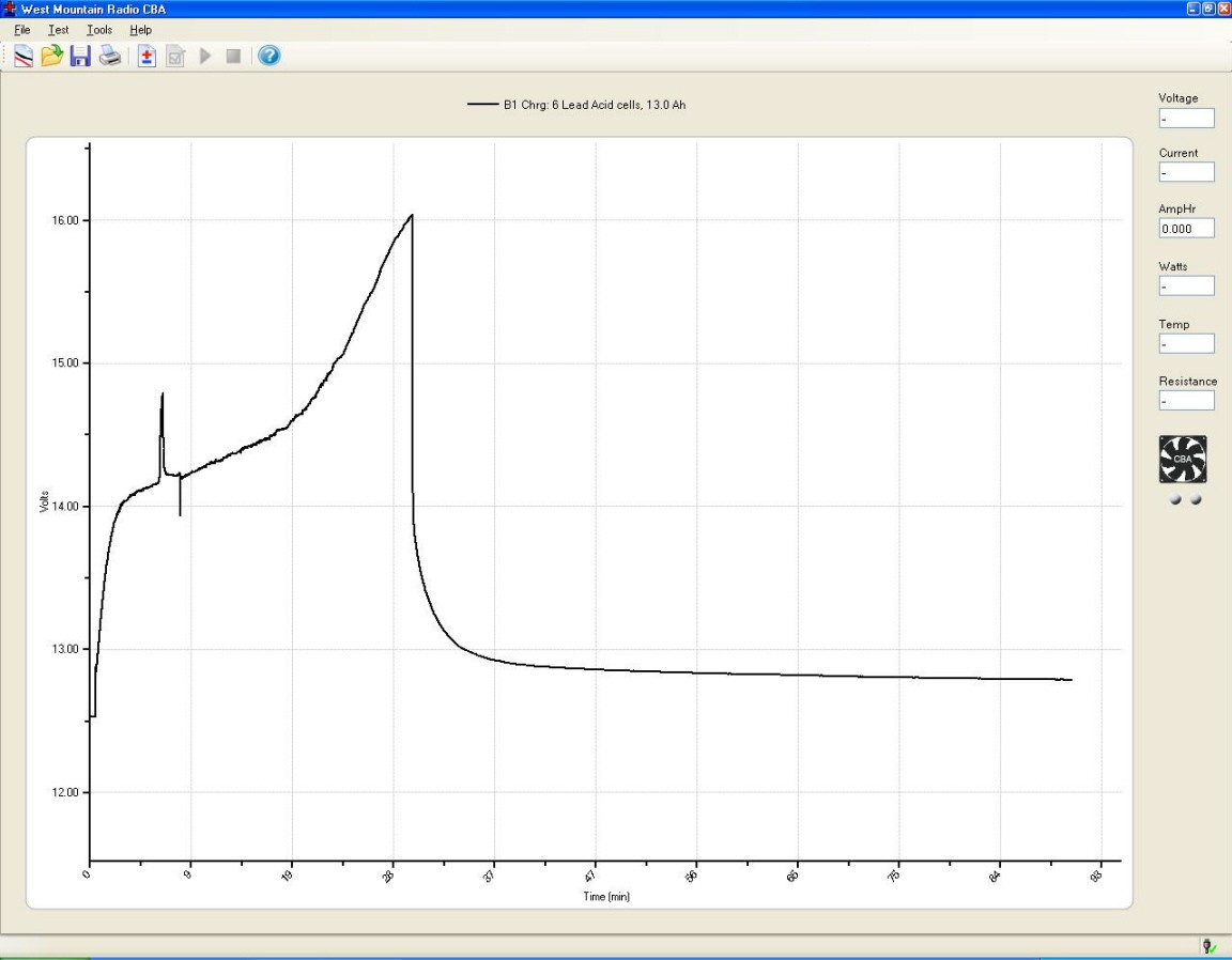

Hi Rodolphe,
Just a point for you or anyone else that's following this thread to remember is that comparing AH recovered to AH in is not actually a true measure of the COP. The average voltage of each process must also be considered and watts out vs watts in is the true measure of COP.

. Next run with higher starting amps!
