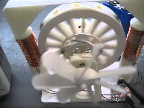

            This film is a short demonstration, by John, of the ZFM motor model we are discussing.
            https://www.youtube.com/watch?v=4TICXxP1jI4

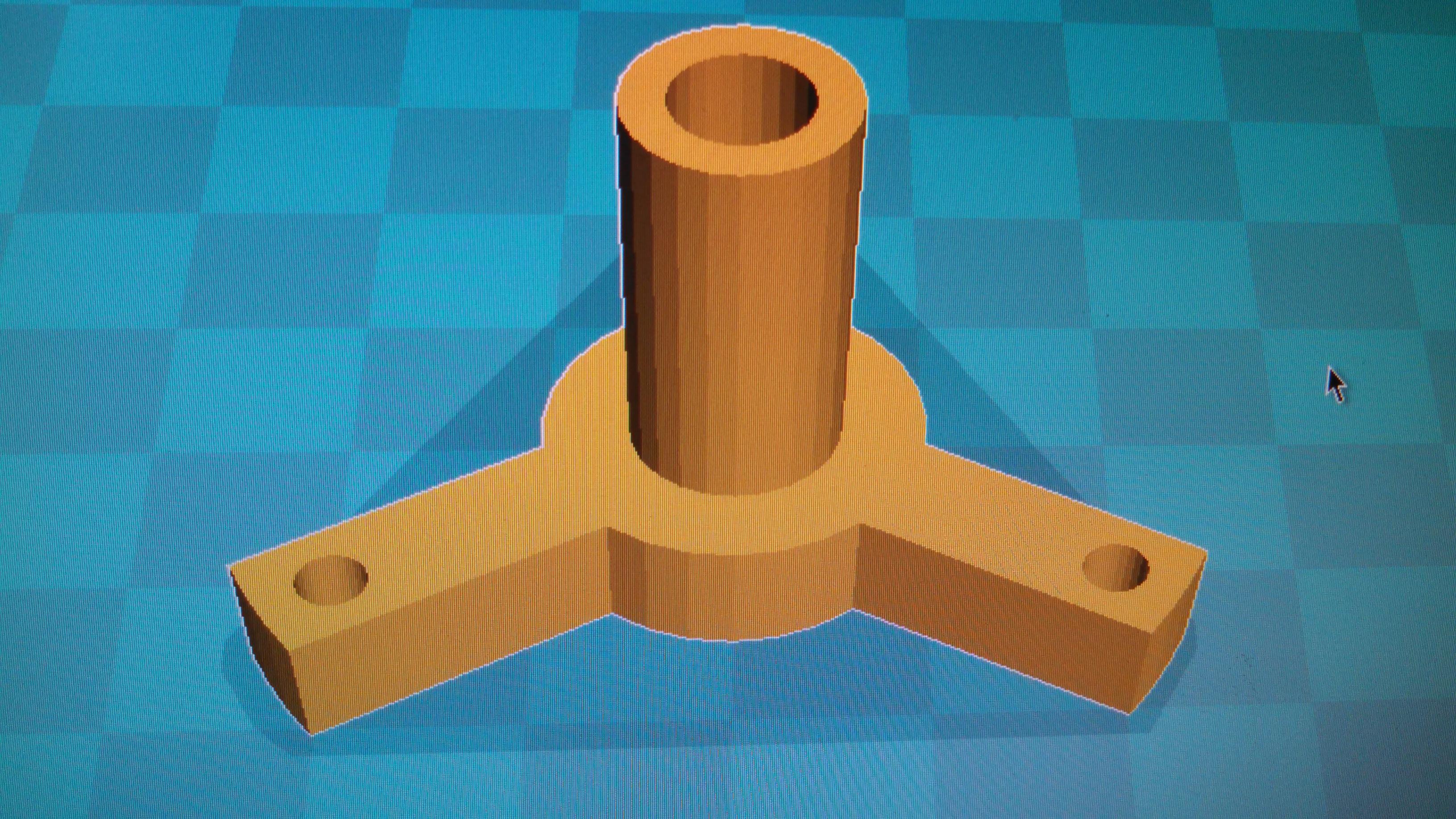

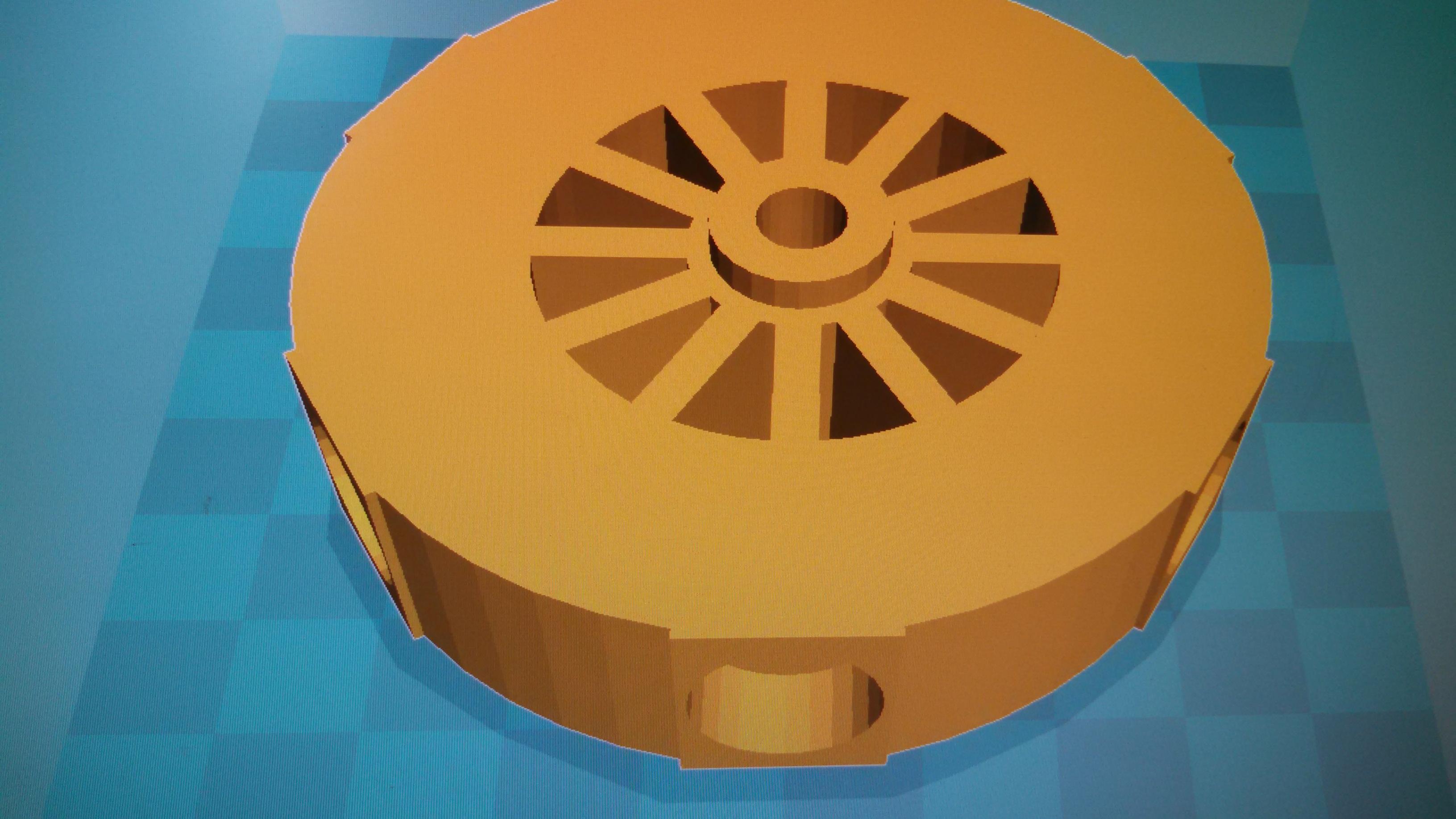

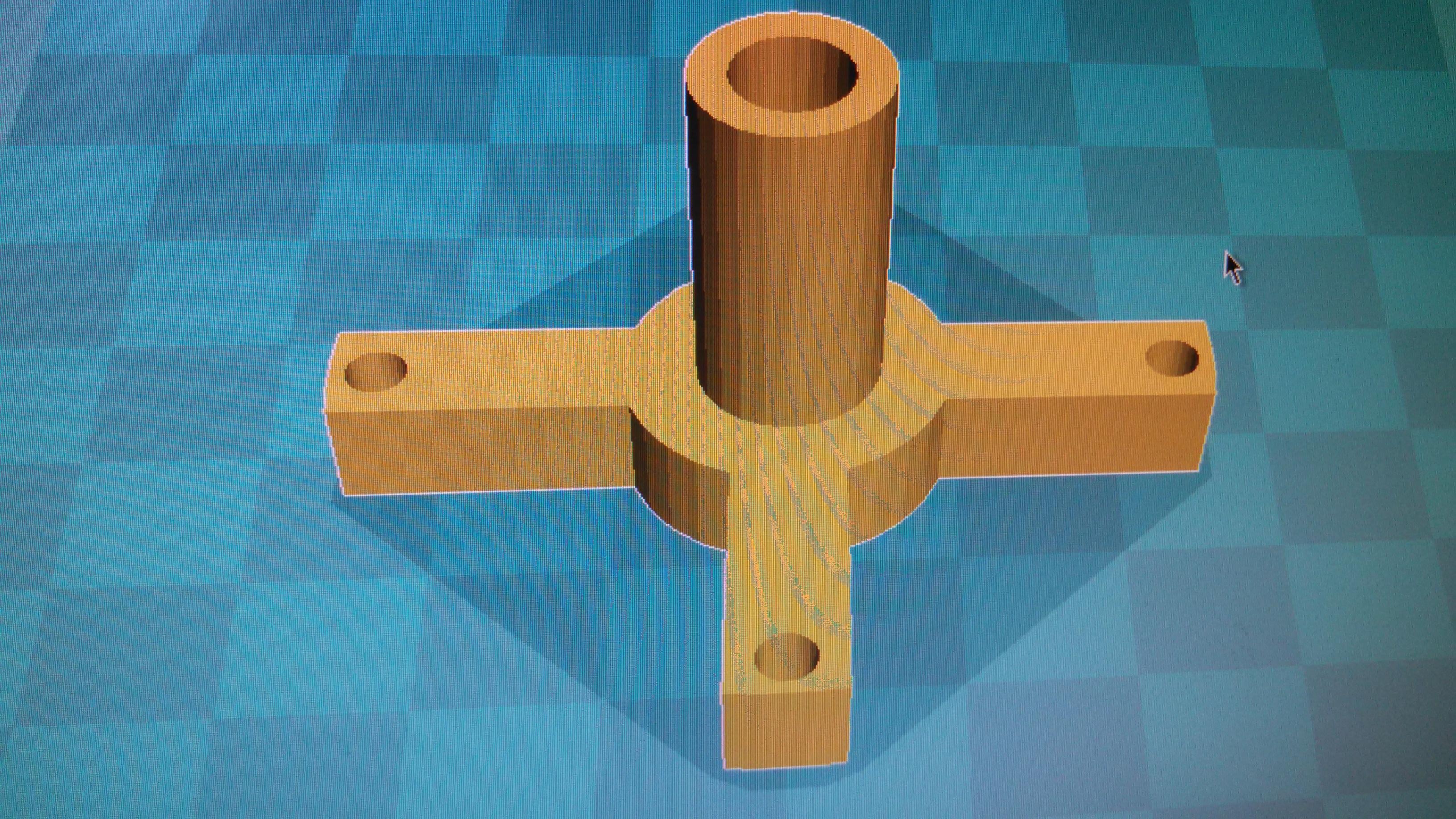

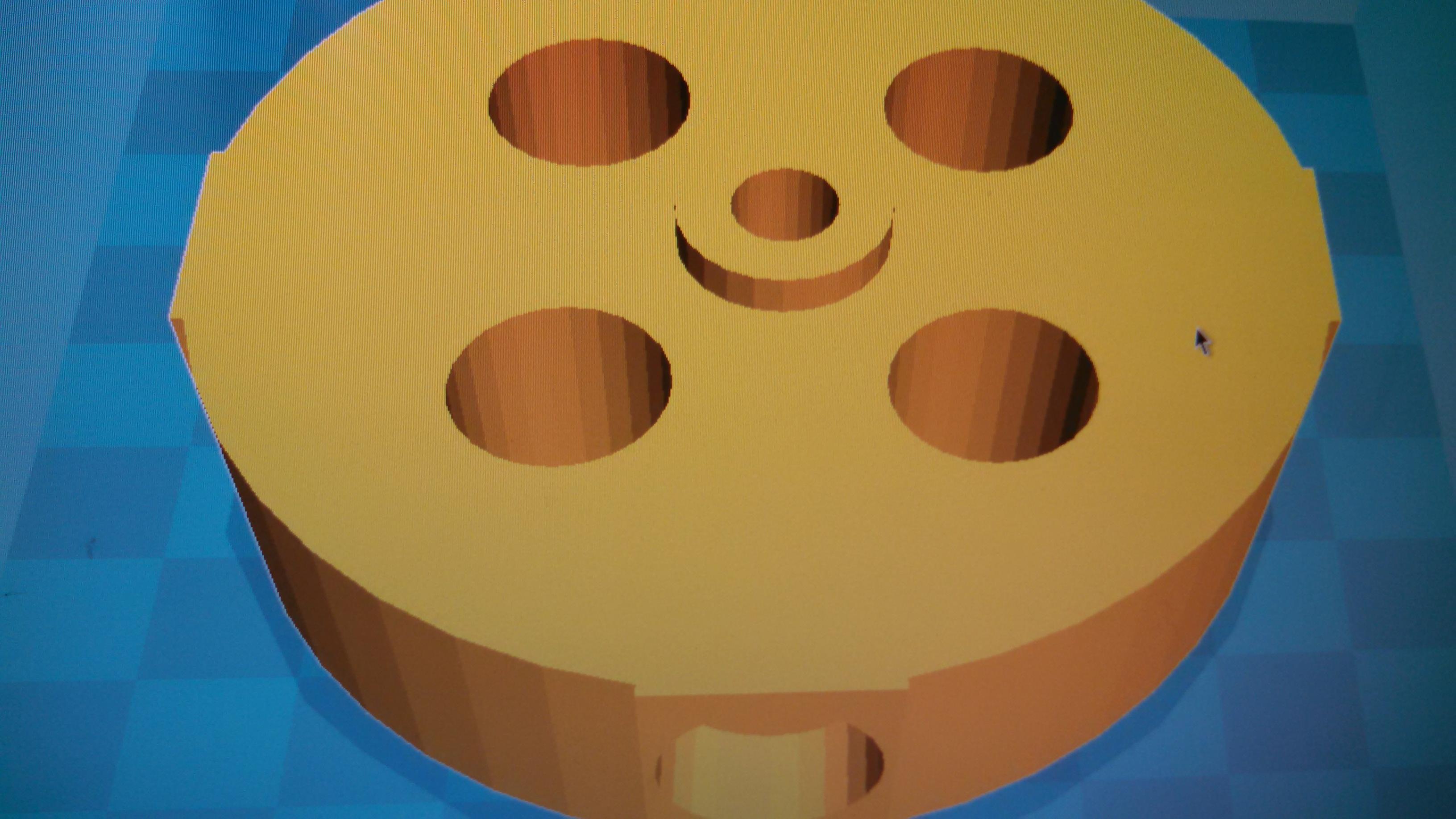

                      • I put a file together for anyone that may be interested in a small build. It is about 4 inches square. It is here: http://www.thingiverse.com/thing:1940207 I have started here with a two magnet rotor. If someone wants a rotor with more magnets just let me know. I do not have any plans to build this until after March 2017.
                        DMann
ID:	49081Click image for larger version
ID:	49082Click image for larger version
ID:	49083Click image for larger version
                          12/05/2016 at 11:07 AM est: added two more rotor options with corresponding reed/hall switching rotors. The magnets for the rotors are 1/2" X 1/4" disc magnets. The reed/hall magnets are 1/8" X 1/4"D cylinder magnets. I cut pieces of 1/4" inch tube to use as bearing stand-offs. Once you determine which set-up that you want to use permanently you can lightly sand the shaft and apply a minimum amount of Gorilla Glue to secure the rotor.
                          Enjoy!!
