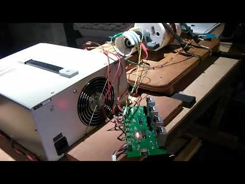

        Hello to all and Happy Spring,
        James McD and I had our annual Bedini fest where we devote three days to various experiments related to our current experimental interests. This year's fest was devoted mostly to the ZFM and we managed to accomplish many different and interesting experiments. The more interesting results will be presented in late spring and then in early summer at the 2018 Energy Conference.
        The experimental results of a couple of them will require verification from other experimenters due to there unusual nature. These will be revealed at the Conference.
        Anyway, James came up with a fun experiment where one would take the reversing polarity voltage that is fed to the ZFM's coils by the Bipolar switch and then also input this directly to an AC-DC power supply. The input to the ZFM's coils is a high frequency DC voltage that can be described as having an AC type of nature and the AC-DC power supply should convert this input to a DC voltage output that can then be fed to the another ZFM's power input. Whew! Will this work?
        Well the JZFM was cranked up and the input voltage adjusted to 28.38v yielding 5315 RPM at 1.01A. The output from the AC-DC power supply rose to about 50v or so before the other ZFM was powered up. Upon power up of the other ZFM this AC-DC output voltage dropped to 28v or so. The other ZFM accelerated to 8074 RPM at 25.7v and 0.5A. The amperage on the primary PS jumped to 1.717A to reflect the increased load and voltage remained relatively stable.
        So everything worked as James had envisioned and the experiment was a tremendous success and a very fun test. BTW nothing blew up and everything continued to run smoothly without any excessive overheating. No OU was expected here and none observed. Not all experiments end this well...
        Yaro
