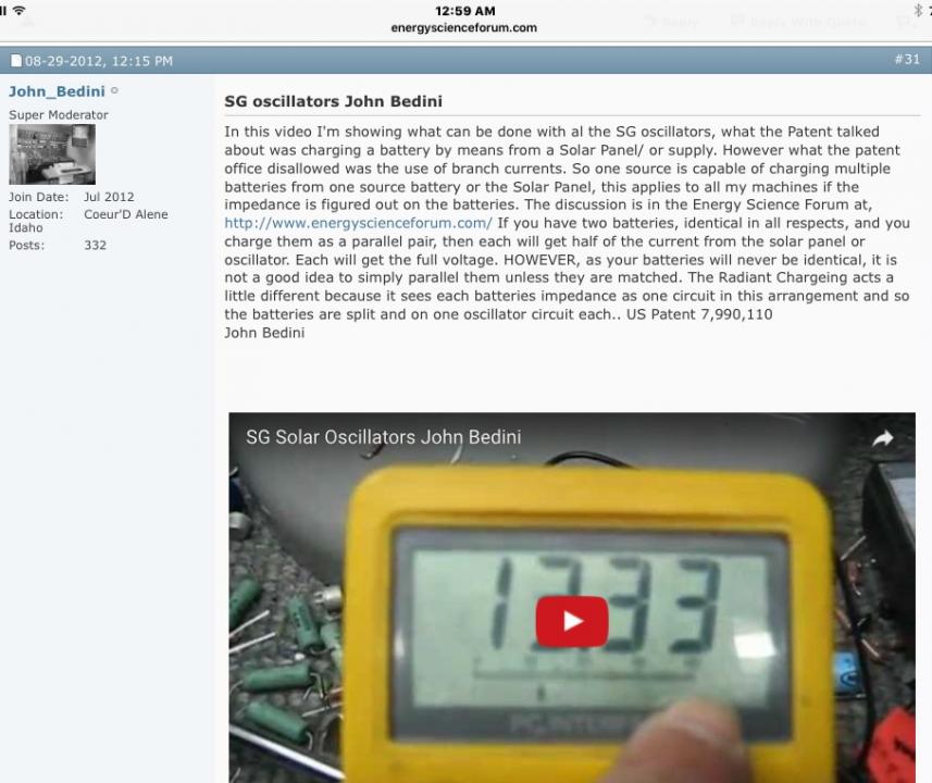

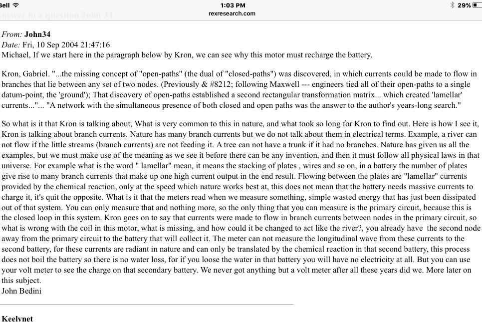

        • The importance of branch currents....
          Here are some more posts to solidify the importance of multifilar windings....
          • Hi Dave,
            Those images seem to open up to small sizes instead of large. Would you mind double checking how you posted them? Hope there isn't a problem with the attachments.

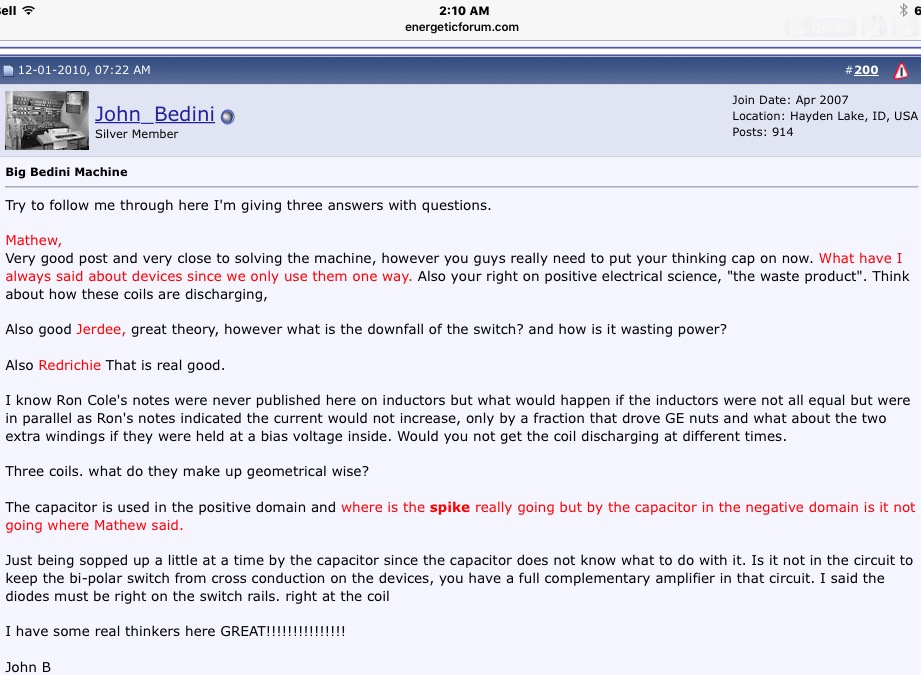

                Thanks Dave,
                These were, have been, and still are big head turners. Reading these keeps me grounded and it really makes sense as to Tom's thread on Self Runner.
                KR - Patrick
                3rd image - "and what about the two extra windings if they were held at a bias voltage inside, would you not get the coil discharging at different times" sorry for the quote here in this thread, it has more to do with the Ferris Wheel coils bias in ckts... https://en.wikipedia.org/wiki/Biasing

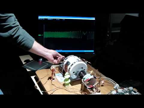

                    • ZFM Proto Video 6 - Max RPM Demonstration
                      Hello all,
                      The last series of tests with the ZFM Proto continue to show the capabilities of the machine with the Aluminum Rotor. For those who may question the performance of this motor the following will present a good picture of the capabilities. Even with the AL rotor it is capable of driving a small pump.
                      In the video the influence of a concentrated magnetic field was not demonstrated - my bad - but when the motor is sprinting at maximum speed the influence cannot really be noted. A quirk of the motor?
                      Test results for AL rotor with maximum firing arc duration of 70-75 degrees:
                      36v 7900 RPM 1.30A
                      24v 5695 RPM 1.32A
                      24v 5748 RPM 1.24A.
                      12v 3061 RPM 0.81A
                      12v 3124 RPM 0.81A
                      24v 5900 RPM 1.04A Adjusted advance
                      36v 8135 RPM 1.20A
                      The total advance in the above is ~ 15-17 degrees. The static firing arc (as measured with a degree wheel is 70-75 degrees). The ZFM Proto is drawing between 10 and 45 watts depending on its speed.
                      So this ends this phase of testing of the ZFM Proto. More than enough information in this thread to get this effort going for the interested experimenter. Up to you and your capabilities.
                      Onward to the next phase of development and stay tuned.
