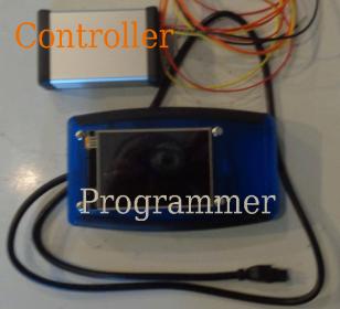

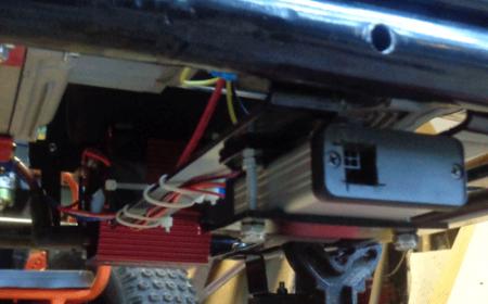

  • I wish I had pictures of the simple version, but here are a few of the timing controller with the hand-held programmer. First pic is of the controller. Second pic is of the controller & coil mounted to the underside of the genset. Third pic is of the carburetor modification necessary to get a vacuum signal.

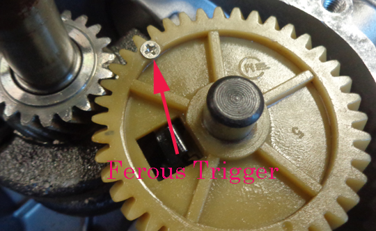

              I'm doing a different generator project where I disassembled the engine, removed the camshaft, drilled & tapped a hole in the plastic cam gear, added a ferrous screw for a trigger, then drilled & tapped the housing to mount a mag pick-up. With a positive cam signal, I KNOW when I'm on the compression stroke.

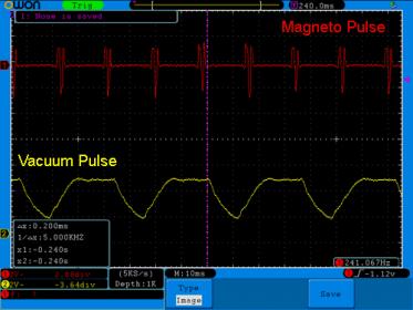

                Attached is a scope shot of the "kill wire" in the top red trace with a vacuum signal on the bottom yellow trace. This is with no load. I used a 5 HP Honda engine from a pressure washer for much of the development work. (Pressure washer died & the whole shebang was free. Engine still works.). If you used a comparator feeding into a CD4013 Flip Flop instead of a MCU, you may be able to rig something up for waste spark elimination. Don't know how you'd actually be able to alter timing with analog electronics. The PIC processor just makes the hardware much simpler for me.
