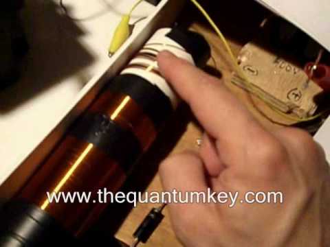

                  • Recently I overhauled Suzuki Maruti F8B 800cc 3 cylinder engine running on contact points distributor ignition system. Along with overhaul, I did some of changes including increasing compression ratio from 8.8 to 10.4 by shaving engine head by 1.26mm, power lynz https://youtu.be/vT7kdwbEG8s
                    , power ringz on the back of intake valves, and later on spark duration enhancer made exactly as per the patent and used non resistor plugs along with it.
                    A spark prolonging device having a winding on an electrically inert core and connected at one end to the secondary coil of an ignition system and at the other end to the distributor, a first portion of the winding comprised of coils spaced on said core and a second portion of the winding comprised of tightly wound coils; the second winding portion consisting of three sections with the direction of winding reversed between the first and second sections and between the second and third sections and the second section having approximately twice as many coil turns as said first and third sections.
                    This improved engine response really so much and solved all vibration issues inherent with F8B engine.
                    There is noticeable power difference about 30 percent difference in acceleration time in all engine rpms. Engine cranks to life in half a turn and is smooth at all rpm
                    Due to increased torque, to improve fuel consumption and to save tires from wearing prematurely I tried reducing carburetor secondary pilot jet from 92.5 to 90 and secondary main jet from 175 to 150
                    No one could identify difference in power compared to stock after reducing the carburetor jets. In fact, even with reduced fuel, engine is eager to accelerate at all rpms. Without spark duration enhancer, engine struggled to climb speed after 80kmph, now after this mod, there is no problem for the engine to club speed upto 100kmph (we don't drive that fast, keeps speeds less that 70kmph since the car is 25 years old)
                    Fuel economy prior to overhaul was 9 to 12kmpl prior to modification. Right now its in the range of 20 to 30kmpl depending on driving condition.

                      Peter Lindemann told me about Bergstressor's spark prolonger quite a while back and I built one but have very little experiments with it to mention. Looking forward to your progress. I never used it together with the plasma in any experiments that I can recall. Are you using the plasma ignition still when you removed the spark duration enhancer?
                      Just realized you are using this on a car - what kind? That is quite an increase over double!
                      • that's one massive inductor. the spark prolonger.
                        • I never used plasma on the car yet, just the spark prolonger
                          Car is light weight city type car with 800cc 3 cylinder kettering ignition F8B engine.
                          But what I noticed when I experimented with bike is that when I hooked up spark prolonger on my bike without plasma, exhaust smell was very much similar to with plasma (very less irritating to eyes and nose)
                          I did try hooking up spark prolonger and plasma in series on my bike and did not notice any more differences.
                          Which means it is the next best thing to plasma if not closer without the additional load put on alternator by the plasma inverter.
                          I may try putting a small inverter on the car to try and replicate plasma on it, but not anytime soon. It requires a lot of effort compared to bike.
                          1 thing I noticed is that bigger the capacitor on plasma that much better the efficiency becomes but at the expense of spark plug life.
