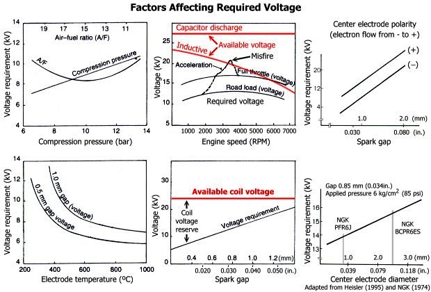

The Torquemasters may be better without the resistors, try it if the resistors are not a must for your system.
They work better than the conventional J strap spark plugs because:
#1 With 2x gap take advantage of the "coil voltage reserve", as you can see here, (second row, second graph):
