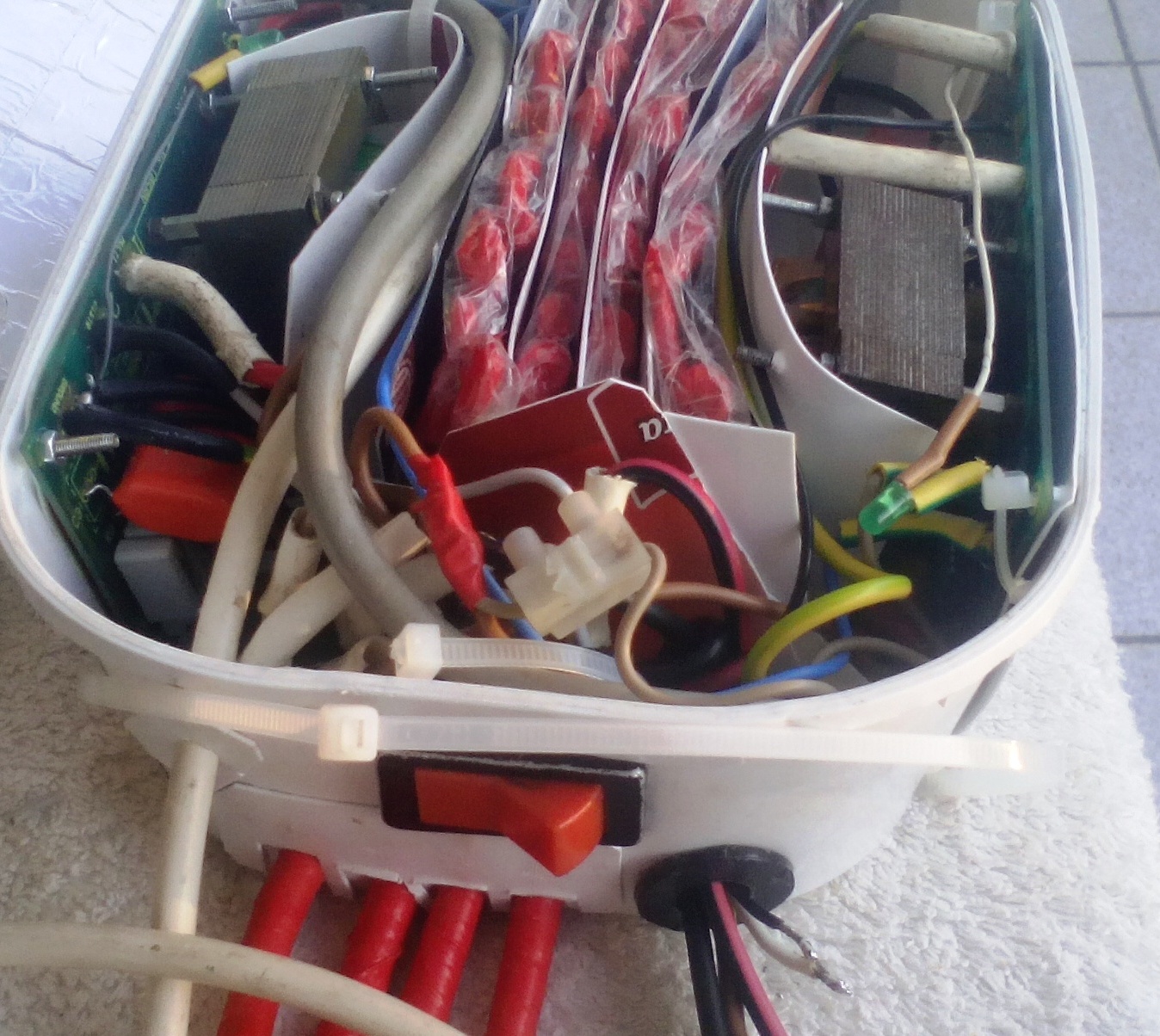

            • My Plasma mkIII Cordon Rouge is here:http://www.vwsyncro.eu/p/blog-page_34.html

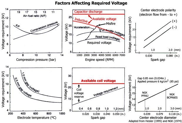

                              The Torquemasters may be better without the resistors, try it if the resistors are not a must for your system.
                              They work better than the conventional J strap spark plugs because:
                              #1 With 2x gap take advantage of the "coil voltage reserve", as you can see here, (second row, second graph):
                              The Syncro Heresy
