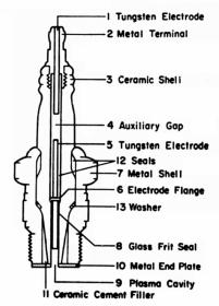

      Even with tungsten, I don't believe they will hold up long term to the plasma. The entire geometry needs to be changed.
      This is the kind of igniter the plasma is intended to be used with but I don't know know anyone who has done this. Small recessed cavity in end of plug where the plasma detonates and it shoots out like a jet. I have the pic in the Ignition Secrets book and video presentation.
      I've tried this with off the shelf non-foulers but the cavity is too big but anyone should be able to weld some material in the non-fouler to take up space. They look like this - could be put on end of non-resistor plug and with cavity filled to make it smaller, could work well as a plasma jet igniter:
      This is the original preferred method but of course a single plug made that way to begin with.
      The Firestorm plug has been tested with the plasma ignition and some reported long life - the patents are expired so it is public domain.
      Read this: http://www.hho4free.com/spark%20plug...lasmaplugs.pdf

          I know those people that make the Torquemaster.
          No matter what material you use, the geometry is just wrong for a long life plasma plug.
          The Firestorm one is the only one proven to last longer than any other geometry but the jet plug still needs to be tested.

            How is the geometry wrong?
            and where can I find proof about the firestorm?

                The bottom line is if there is a sharp edge, the high speed current impulse will destroy the high potential electrode.
                That is one of the primary concerns.
                Krupa wanted people to believe the spark plug geometry was responsible for those large plasma blasts you see on the left (right is normal plug), but the truth was that he cap a plasma ignition setup on the plug - the benefit is long lasting plug.
                • That was supposed to be an animated gif but didn't work.
                  You can see it here: http://www.hho4free.com/images/Fires..._animation.gif
                  • definitely looks like it's blowing the ignition plasma energy well into the cylinder compared to "standard" ignition, but what I was looking for is the proof/evidence that it leads to longer plug life.
                      You have to go thru the energetic forum posts from 11 years ago from those who made those plugs and tested it.
