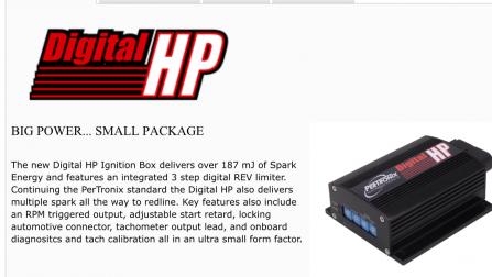

      Hope this works

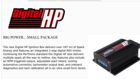

        • 250FE5E8-9376-4B73-B2C1-0DB5713F3FD3.jpgAaron the picture above is the one I spoke of.
            Hope this works
            https://www.amazon.com/gp/product/B0...SIN=B071PBX2XC
            $234 for module and all harness, etc. pretty good price.
            However, 187mJ per discharge is really strong and would eat your plugs more than twice as fast as the Street Fire if you use it for a plasma ignition system. Keep in mind that even with the smaller 89mJ discharge with the Street Fire that under compression with a lot of air/fuel getting crammed onto the spark, when the cap discharges over the plug, the plasma gets bigger than what you see in open air tests. The air/fuel and mositure in the air feeds the plasma. I think 100mJ per discharge or less is the way to go for regular driving and with good plugs.
            For performance where I don't care about how long plugs last, I'd definitely go with that Pertronix unit.

              • Thanks Aaron, I did a little more reading on the Digital Hp and found another interesting capability of this unit. And that would be that it has 2 power output settings and on low output is 145mj and high is 187mj, still higher than the Street Fire though. In your experience what brand plugs hold up the best with plasma?
                    That's a great option to have - still a bit hot on the low setting, but really depends on the plugs.
                    I've used simple off the shelf non-resistor plugs.
                    What I found that I still haven't had time to test are the iridium and/or paladium non-resistor plugs by WeaponX Performance - something like that. Easy to find online. About $15 per plug or so. They look the most promising but of course will not know unless they're actually tested.
