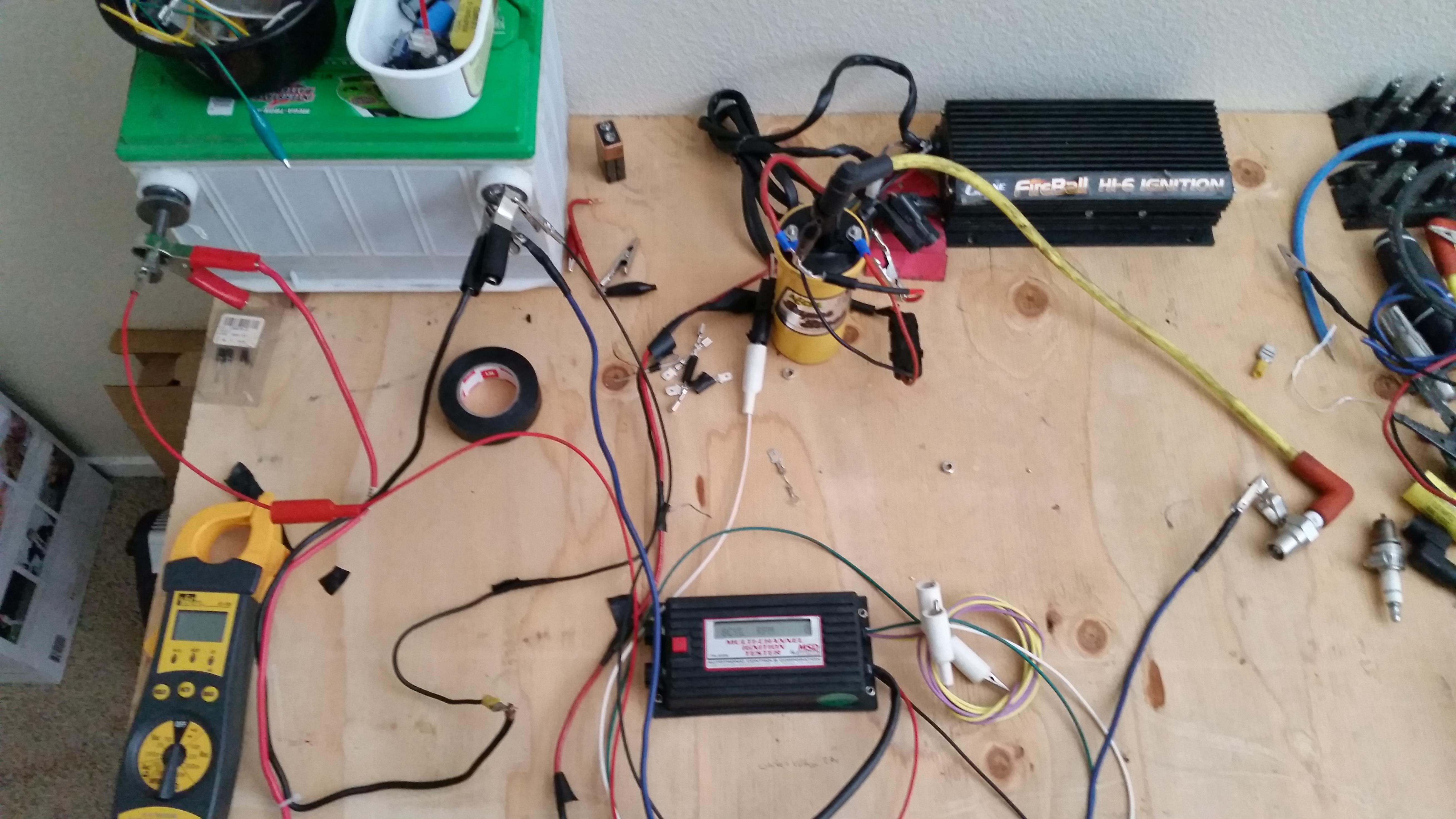

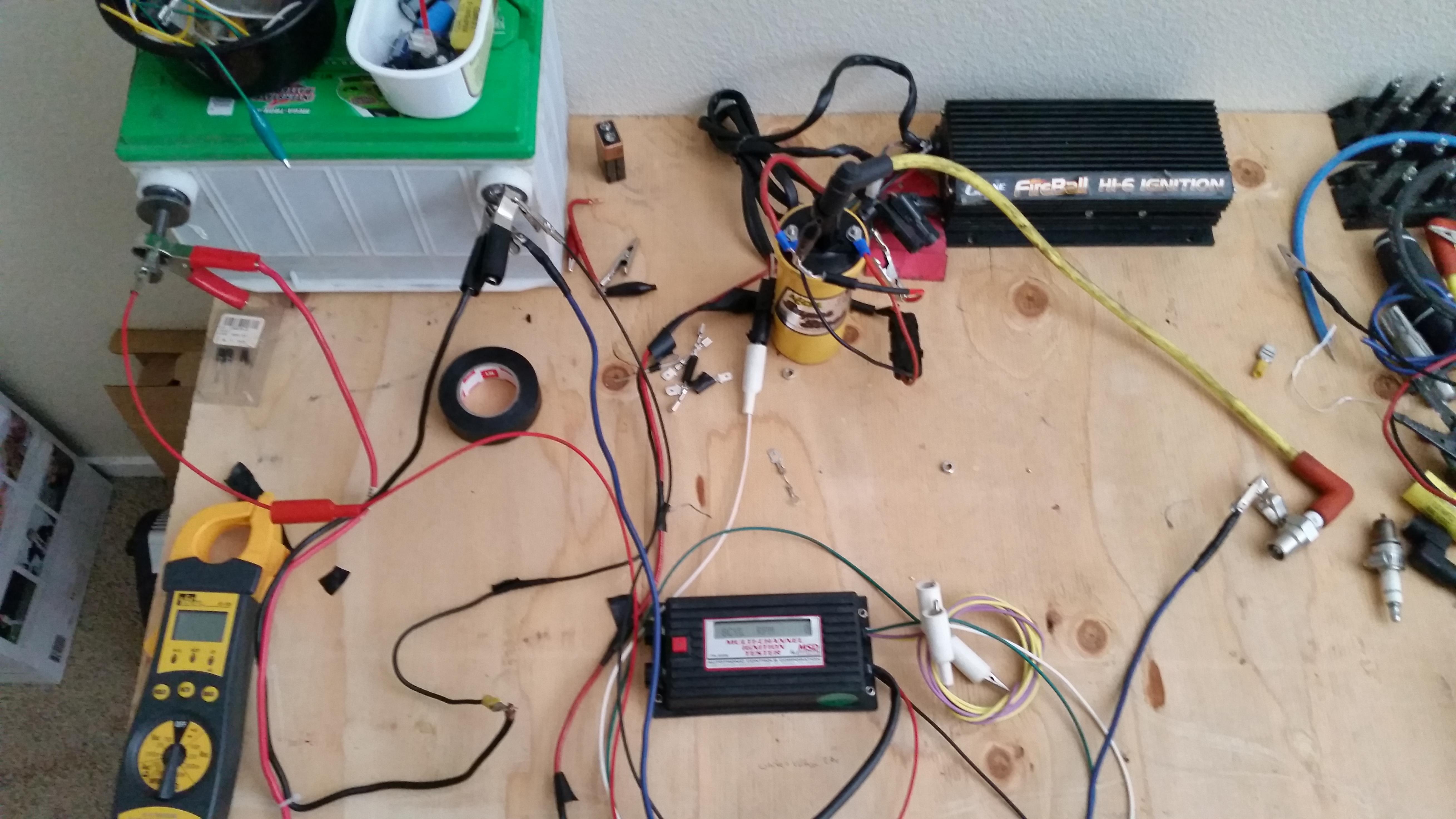

              Greetings Aaron, I am using a MSD ignition tester Model 8998 (in place of 555k timer), an Accel Super Stack coil, a Crane Cams Hi 6 Fireball CDI powered by a 12v car battery. I can get plug to fire without diode but as soon as diode hits HV of coil can hear CDI box triggering but spark stops. Using HV microwave diode but have also tried a string of 3A100. Tried new coil and new MSD CDI with the same results. Any ideas?
              • Originally posted by HitechLLC View Post
                Thanks for sharing your work here.
                Do you know for sure that the HV output is positive? If it is negative, you have to reverse the diode's directionin.

                  • When diode is flipped, so grey band is facing + of coil, CDI will fire plug normal. Have also tried diode in between + of CDI and + of coil, also 2 HV diodes from + of coil to HV of coil. Get same results of CDI triggering but no fire.
                    • HitechLLC if you post a little video, I am sure you can be helped a lot more easy. In the picture you posted it looks like you only have the HV to the top of the plug. You will need to just add a wire containing a diode or a bunch, from low voltage positive on the ignition coil to the top of the spark plug.
                      Also it could be good help to ground the battery as well, just to make sure the High Voltage goes to ground. I have learned the painful way that HV likes to travel all over the place.
                      Hope this can help you!
