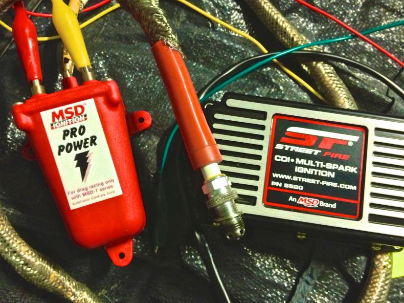

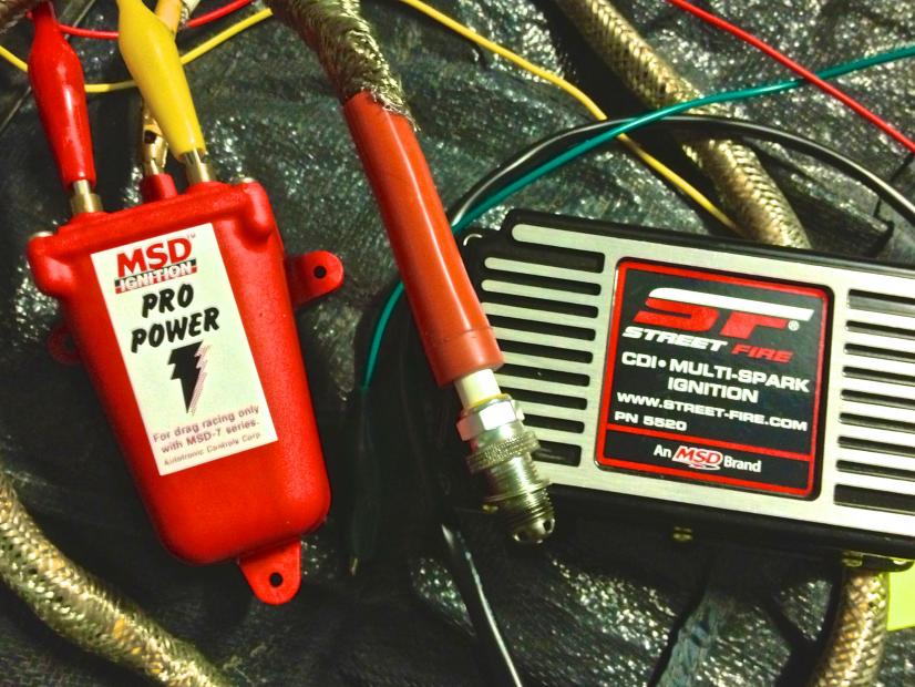

                      I have tried two set ups and none of them gives me plasma. I am getting desperate...
                      I'm using resistorless Accel Superstock leads. Resistorless Torque Master from extremespark.com
                      First set up
                      MSD 62153 DIS-4 HO ignition box http://www.msdignition.com/WorkArea/...id=15032386156
                      MSD 8232 Single Tower Cil Single Tower Coil, CPC Ignition - 8232
                      20x 6a100
                      Second set up
                      MSD 5520 ignition box http://www.msdignition.com/WorkArea/...id=15032386133
                      MSD 8201 Pro Power Coil (for drag racing and not entirely compatible with the 5520)
                      20x 6a100
                      Battery is properly charged. Ground is good. I get good sparks from the CDI boxes. Diodes directed as in the book and on the shortest possible path as described. Coil polarity is positive. No plasma.
                      I've come to the point that I've tried almost everything and I can't figure out what's wrong. I have tested the diodes one by one and they are OK. Have 2 other strings that show the same values that I have tested with as well....
                      I'm thinking that the coils are not good for creating plasma, but it's two brand new and different coils with totally different properties. That both of them can't do plasma is a bit far fetched... Another thing I'm thinking of is that the wire I'm connecting the diode string with to the terminals is too thin.. As you can see, there's not so much left to try...
                      Here's a pic of the second setup:
Name:	plasma setup 5520 with 8201.jpg
                      P.S.
                      Diode string temporarily disconnected as you can see...

                        Rikard,
                        Please post a full clear diagram of the second setup. It works every time with that Street Fire module.
                        • #42
                          The diagram is as follows:
                          plasma setup revision 2 | Flickr - Photo Sharing!
                          I called MSD last night to double check the HV polarity and it's positive for all my coils in both set ups.
                          • #43
                            Your plug diagram looks a bit odd. Are all the striped lines the threads of the plug or the ceramic insulator?
                            Other than that, assuming that the ignition coil is really HV + output, and your diodes are good, I think it should work fine.
                            It would be identical to what I did but I used a different coil that has HV - output so the diode(s) were in the SAME place, just reversed.
                            If you remove the diode, does it work as a normal CDI if you manually trigger it?
                            Let me know the answers to the 2 bolded questions first and lets go from there.

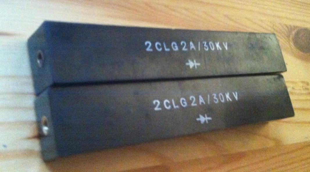

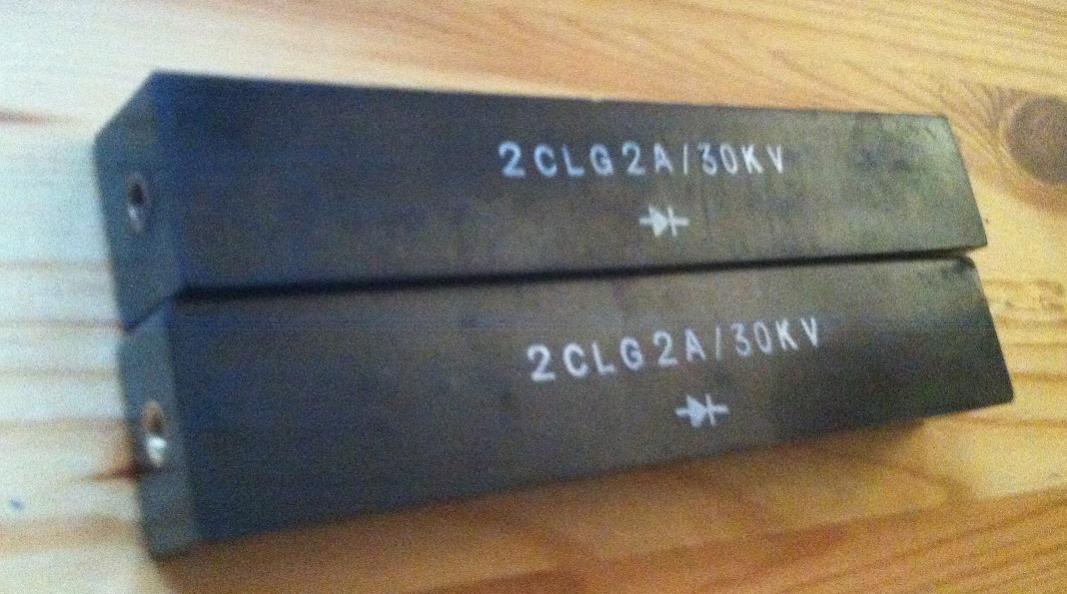

                              These are some diodes I'll be testing when I can free up some time. I plan to use these on my Subaru with wasted spark ignition so my diodes have to be opposite polarity from each other since half the coil is + and the other half is -.
                              They're 2A 30kv high frequency ham radio didoes. You can get them from Ebay for about $25 a piece delivered.
                              They have different ones with different amp ratings and voltages.
                              I think the voltage is fine and 2 amps should be more than enough. I use the 6A100's normally because that is 6 amps at whatever voltage the strings is and it is VERY INEXPENSIVE.
                              If you want to try these, search ebay for HV diode ham - but buy at your own risk. I'm not making any claims since I haven't tested mine.
                              They have threads on each ends for screwing a connector to so that's handy. They're potted so it may be made of multiple smaller ones, not sure, but if they work good, can be a time saver.

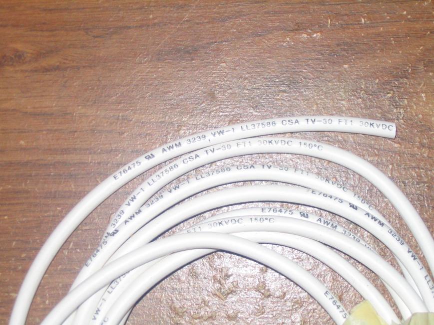

                                HV wire for diode strings

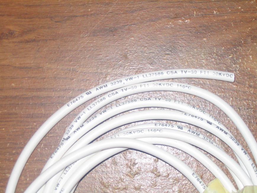

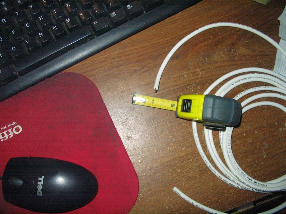

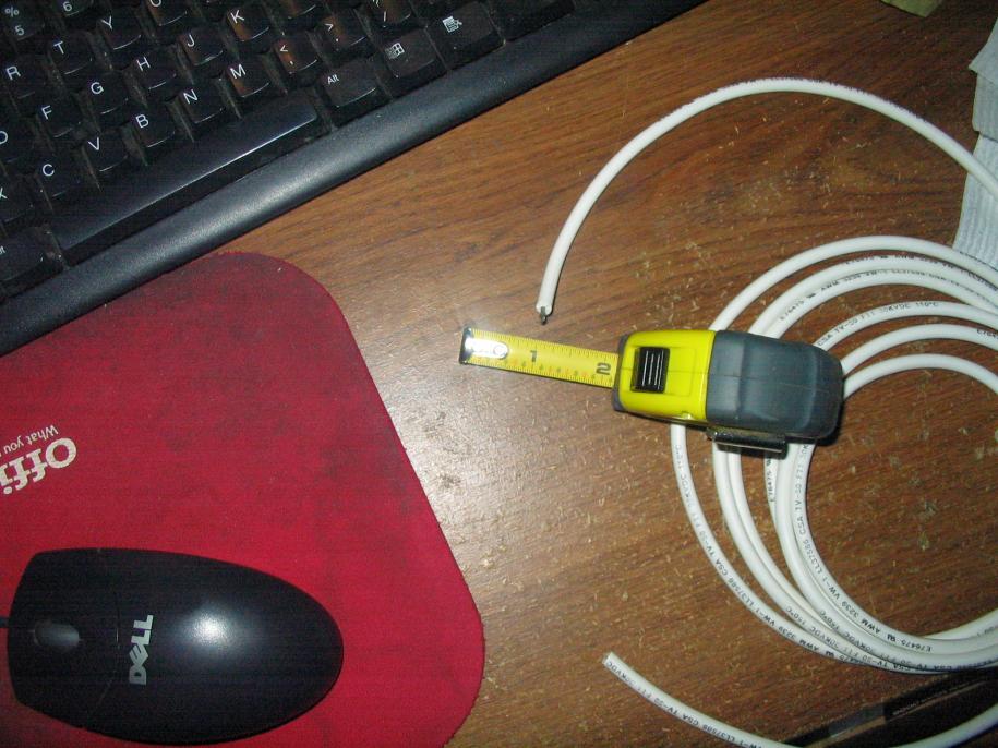

                                Hi everyone my first post here...
                                Rikard and Aaron, one detail I caught someplace in the Ignition Secrets info, was using HV wire in construction of the diode string. I haven't even got my diodes yet, but I found an online auction and bought 10 ft. of HV wire rated at 30 KV. Tinned stranded copper wire w/ white silicone insulation, 7/32" O D, rated 30KV. Cost about 20 bucks.
                                I'm not an electronics guy, I bought this wire for diode strings, thinking to err on side of caution.
                                I don't know just how important this detail is...?
                                Here's a couple pics, in case this may help.
