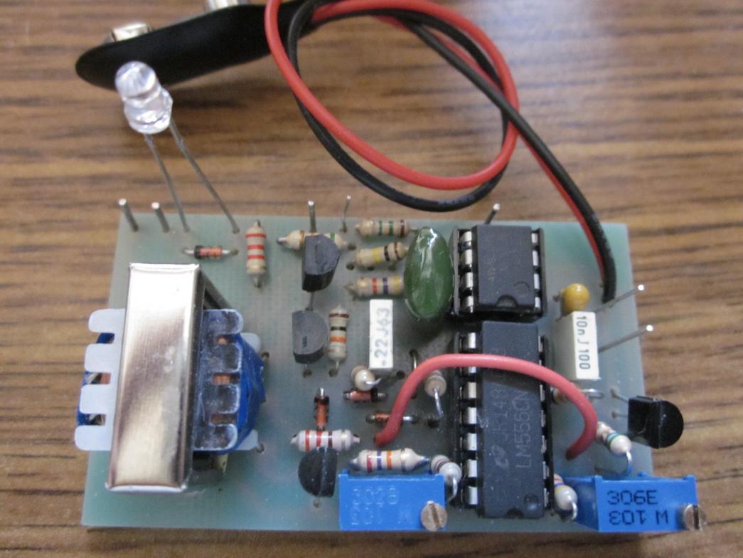

      Vtech
      Assembled BT as per original 556/555 circuit -

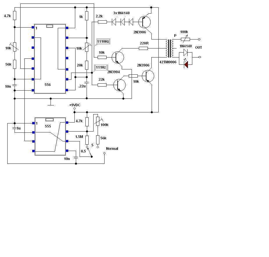

                  • Sir, please kindly post the BT v2's components and their values list because in the PCB layout I found values of some components was not mentioned.I compared your PCB layout with schematic of Mr.algorythm where he has pointed all the modifications suggested by you in red color posted in page 26 in order find the missing values but didn't matched.Saturday I will have my new multimeter ,so I was hoping if you post the component's values list I can start building BT v2 from where I left it.So please kindly post the component's value list.
                    And I am very sorry,earlier I said I couldn't see the IC's pin numberes because of the hazyness of the PCB layout but that not true the schematic is alright ,my printer was the problem.

                    • Mr.algorythm you said the pin 7 of 4047 have to be connected to the GND,which line is the GND in the schematic.
                      • Here you go, values of components as I have in four assembled and tuned units -
                        Parts List:

                        • Sunshiner the schematic has been updated, check it.
                          • Thank you thank you very much both of You sir.
                            • Where I will connecte the 9v- in the circuit Mr.blackchisel.
                              • Originally posted by sunshiner434 View Post
                                To the common connection with a "ground" symbol.
