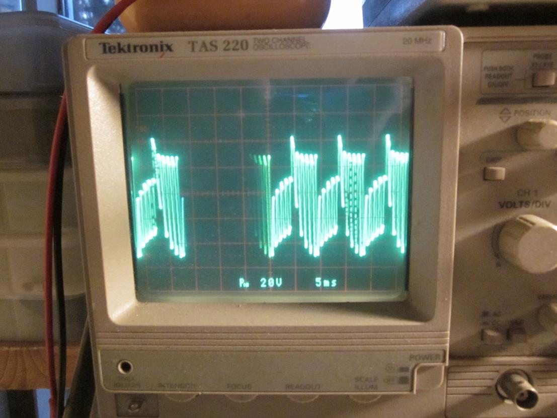

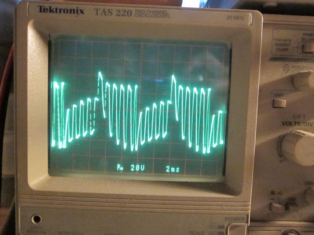

                                Nick, it seems that you're not getting signal to the one terminal of transformer secondary. Can you scope all three of them. Something isn't right here.
                                I attached the output scope shots as they go out to the ear electrodes in two different time settings.
                                Also, the current draw seems off the chart.Click image for larger version
Name:	BT output wave2.jpg
ID:	45543Click image for larger version
Name:	BT output wave1.jpg
                                Vtech
