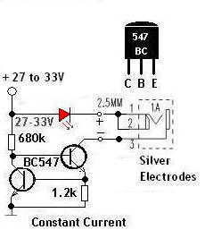

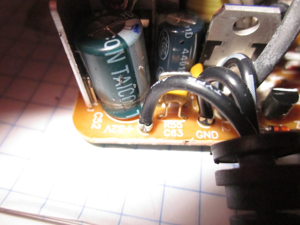

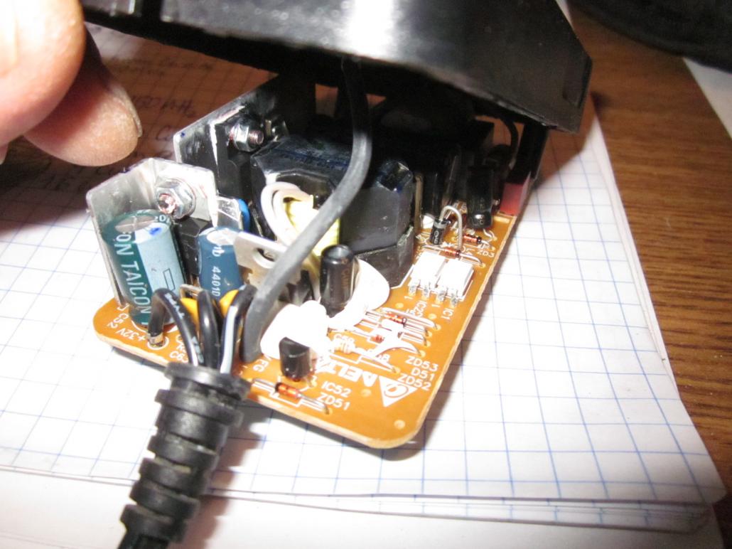

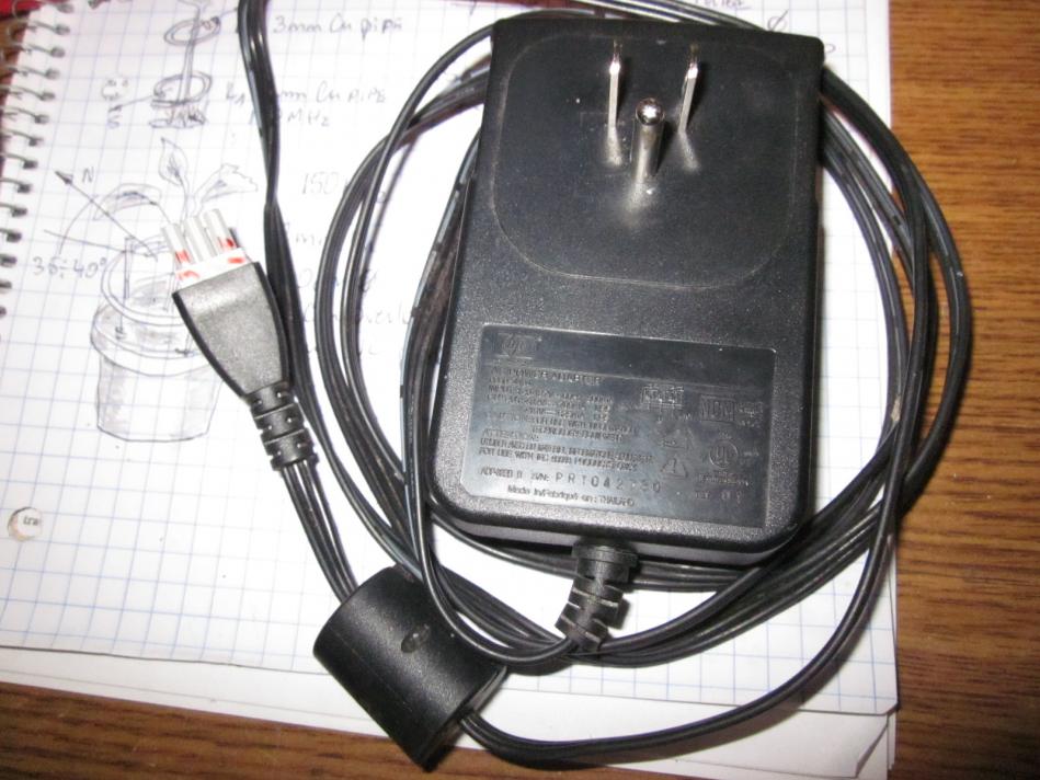

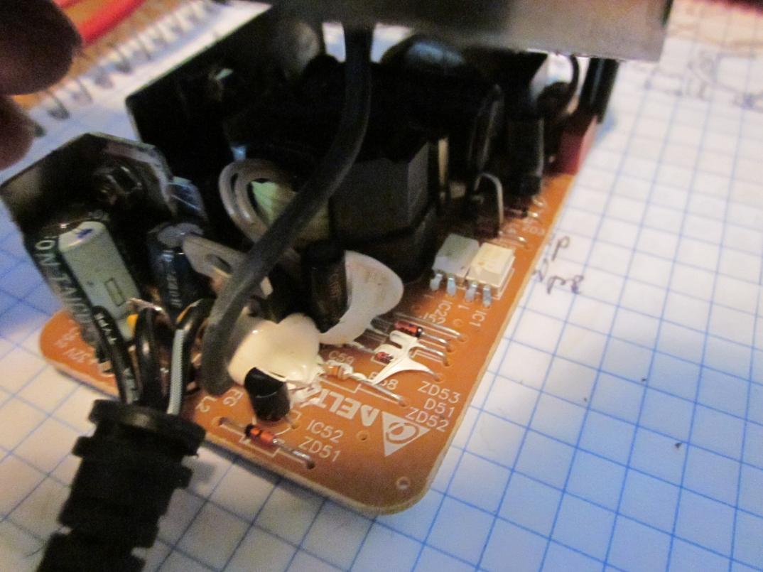

I thought to show how to make a simple, inexpensive and good Colloidal Silver unit. What we need is a power supply (wall adapter) which will deliver around 30VDC. Current rating isn't important since we'll be using less than 1mA. I found that cheapest one - free, can be salvaged from discarded printer. In worst case - not free, something like that - AC DC Printer Power Adapter HP 0957 2231 32V 16V 375mA 0 375A 500mA 0 5A | eBay

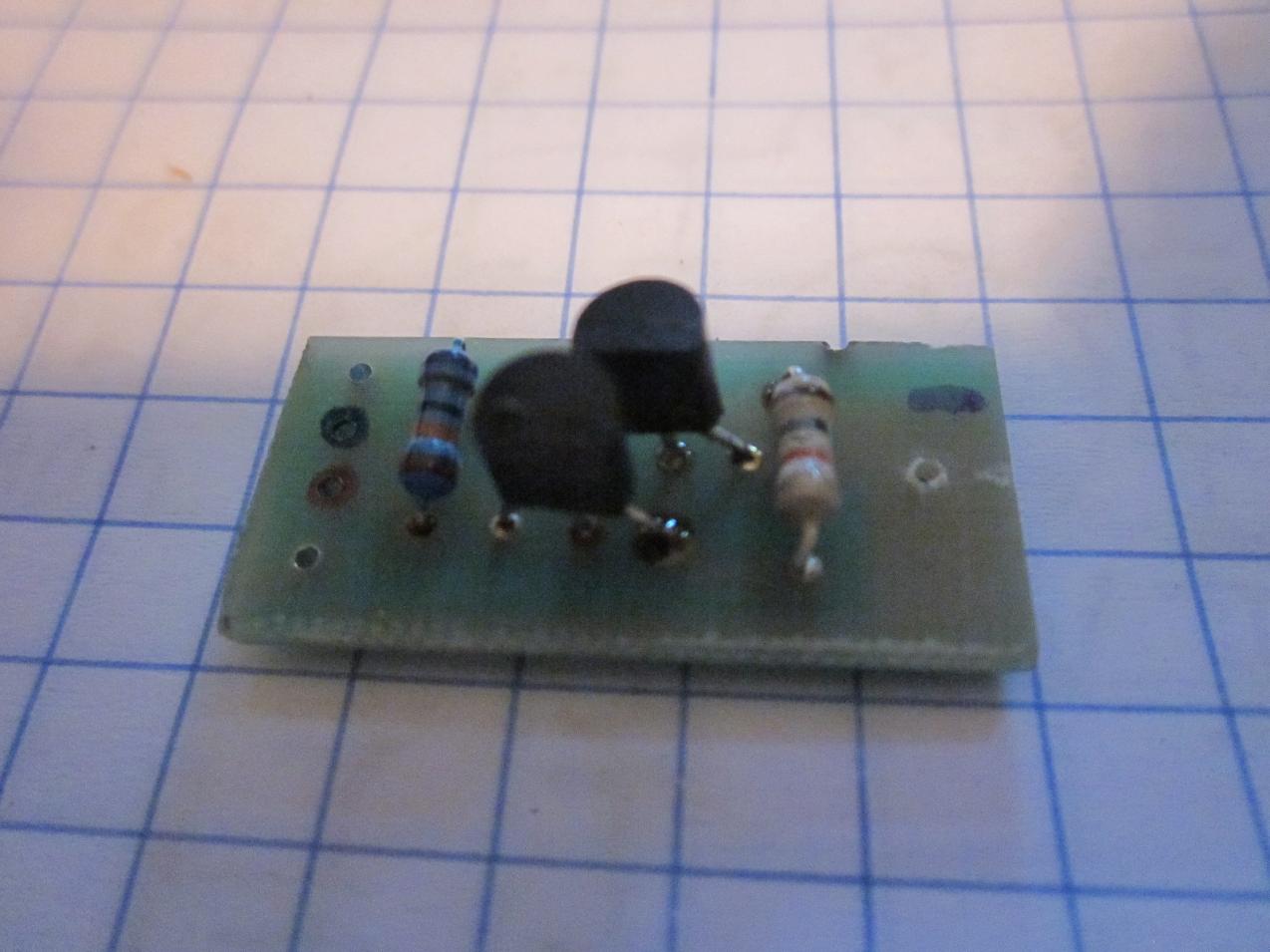

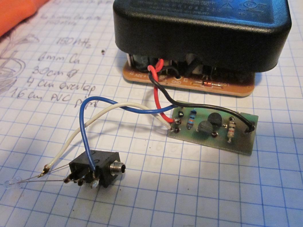

Most of them have triple socket where middle is neutral (-) and there is 16VDC and 32VDC on each side. Pcb inside is usually marked, so don't worry about the plug polarity. Once you open the case - I used a surgical blade but any sharp knife will do the job. Try not to insert blade too deep since you may damage components. There is usually enough space inside to fit constant current circuit soldered together. I put mine on piece of pcb but there is only 2 transistors, 2 resistors plus LED which will be placed beside the socket. You can unsolder output cord and solder positive and negative wires from CC circuit right there. From pcb you'll also need to run two short wires, one from positive to LED anode and second from the collector to the female socket collar. Another two terminals of this socket are connected to the cathode of LED.
Values of the resistors will limit output current to approx. 450uA when more silver particles will get suspended in water.
This prevents from bigger and bigger particles being generated once the conductivity of colloid increases.

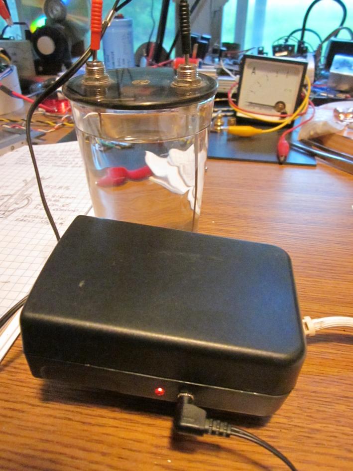

This is the same circuit which is included in my BE/CS unit and it works very well. Transistors are BC547 or 2N2222, not critical. Resistors 1.2k and 680k can be small, 0.125W. LED is low current red. I used 2.5mm female audio socket because my cables for CS are the same size but you can use 3.5mm on one end and alligator clips on the other. Polarity doesn't matter. I just assembled this for you guys to show how it can be done easy way. This is CS generator only.
With same 3.5" 14Ga silver electrodes as I use in my units and distilled water @ 85F it will take approx. 45min to make a glass of 5ppm colloid. Double time will yield about 8-9ppm. Increasing water temperature of 10 deg (don't use microwave but small pot with warmer water as a "water jacket" or coffee warmer plate) will speed up process and yield approx 5ppm within 25min.

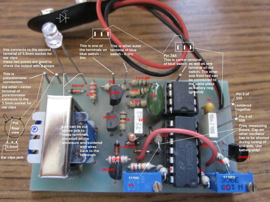

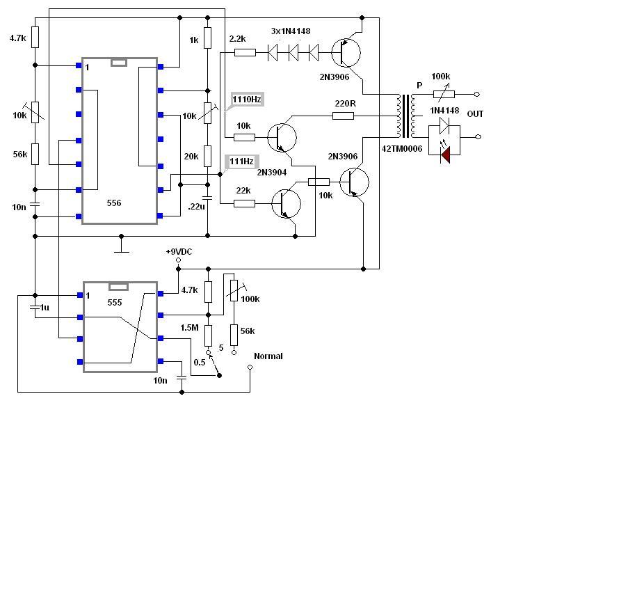

This is an updated assembly of Beck Brain Synchronizer for those who got from me either bare pcb or assembled kit. I hope it will help in putting everything together. If not, I'm often here to answer.

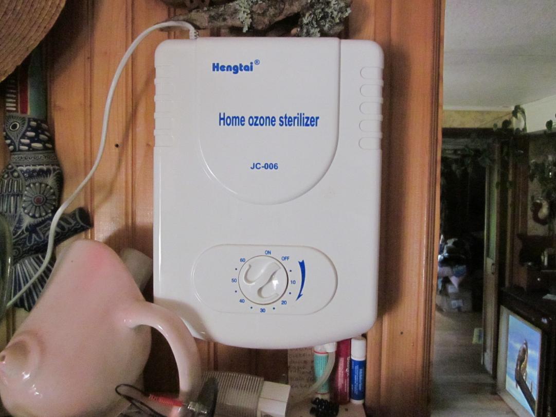

Couple months ago I acquired domestic ozone device and have been using since. So far I'm satisfied with. The pump is strong enough for treating a large volume - couple gallons of water and can be used with oil as well. The price was about $50 with shipping included. I attached picture below.

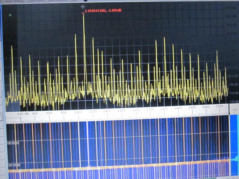

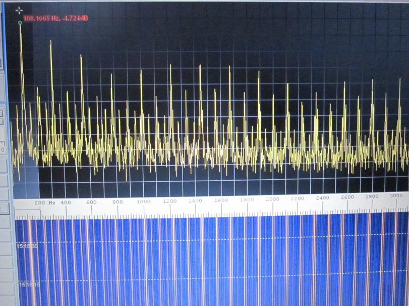

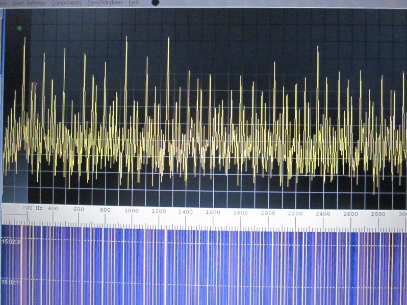

Couple shots from the output of BT on spectrum analyzer with one of oscillators running and full output. Hopefully, you can see various harmonics in low audio range -
