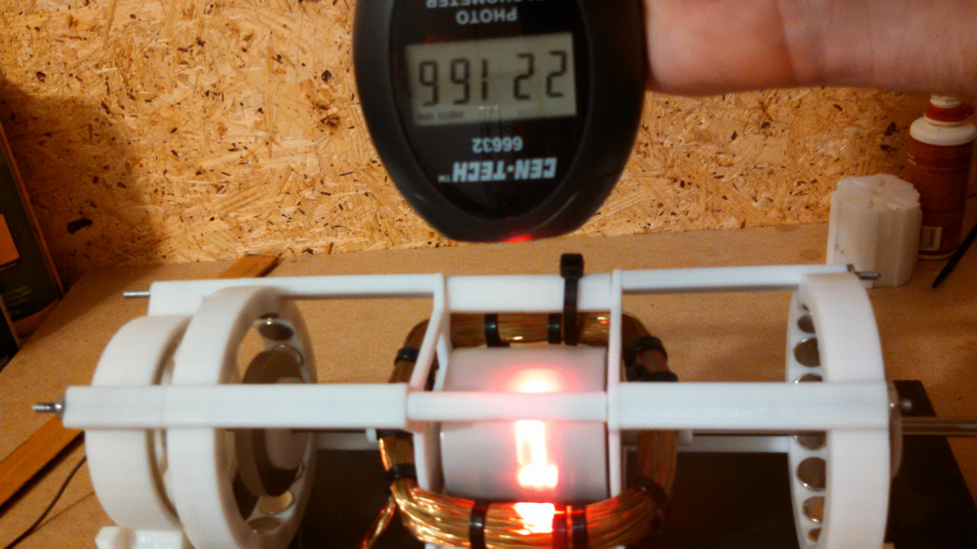

ID:	49320 Kablooey at 27k rpm's.. I was running on the Bedini/Cole Half Sequential Bipolar circuit at 32 volts with trigger coil. The magnets are only super glued. The rotor is printed at 20% infill in pla with 1mm thick walls. It started with one magnet ripping out of place, taking a chunk of rotor with it, from the centripetal force. The good news is everything else appears to be intact. Two of six rotor magnets survived. It is amazing the difference that it made between the two circuits. The SG circuit barely got the rotor to 4.5k rpm's on this setup at 32 volts.

      [ATTACH=CONFIG]6018[/ATTACH] Kablooey at 27k rpm's.. I was running on the Bedini/Cole Half Sequential Bipolar circuit at 32 volts with trigger coil. The magnets are only super glued. The rotor is printed at 20% infill in pla with 1mm thick walls. It started with one magnet ripping out of place, taking a chunk of rotor with it, from the centripetal force. The good news is everything else appears to be intact. Two of six rotor magnets survived. It is amazing the difference that it made between the two circuits. The SG circuit barely got the rotor to 4.5k rpm's on this setup at 32 volts.

      1mm holding in the magnets... that's crazy strong. I'm surprised you even made it to 5k. Yup, that Bedini/Cole ckt is pretty amazing, when you switch it "mechanically" it's even more efficient. Have you tried the ckt Dadhav used in one of his later videos that charges with current rather than the spike? JB and I had some possessive interactions on that one. You have to play with all the variables... problem is it is extremely difficult to tune (most have problems tuning the SSG), however, I mention it because it is much easier with the low resistance maglev.

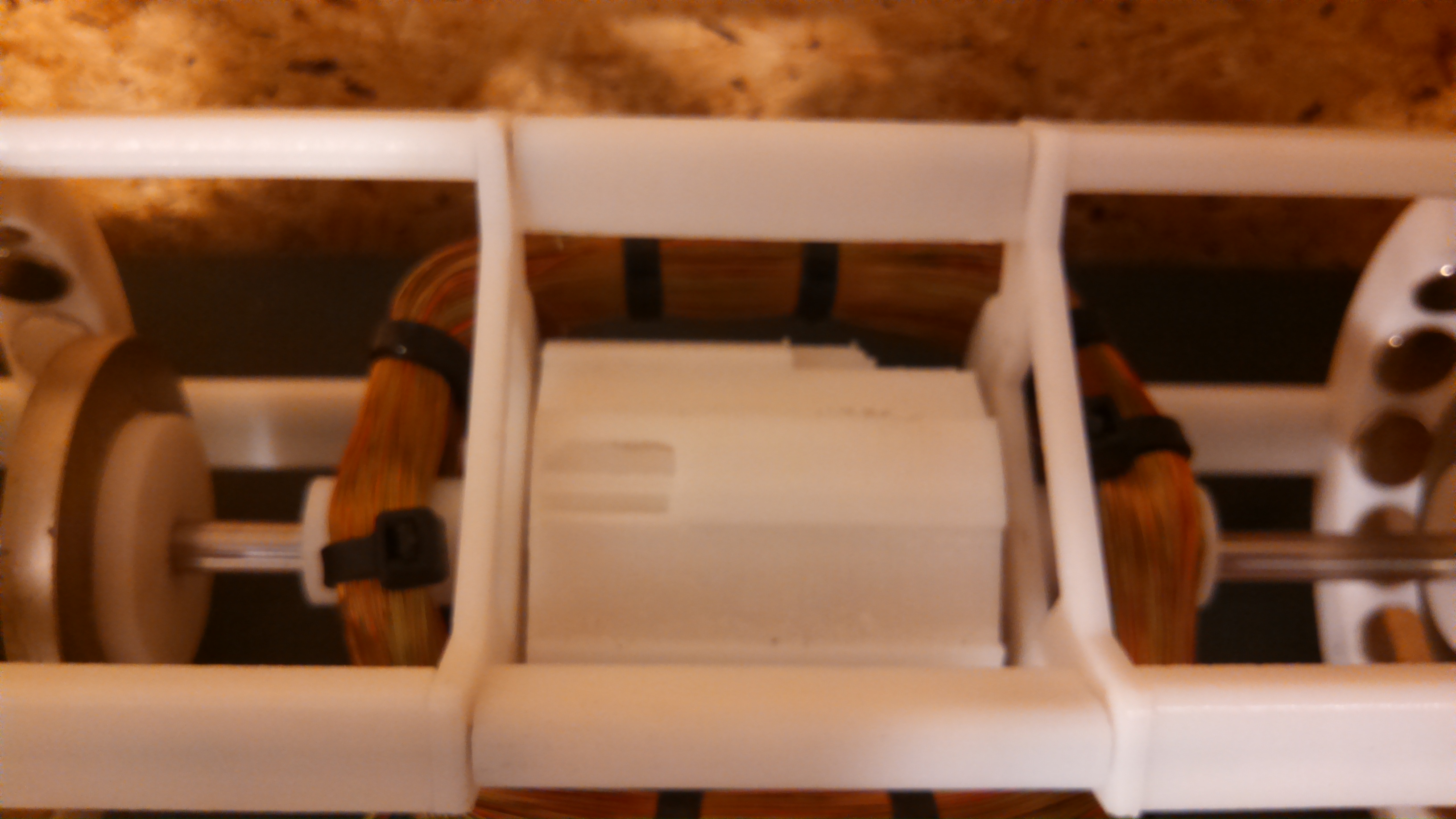

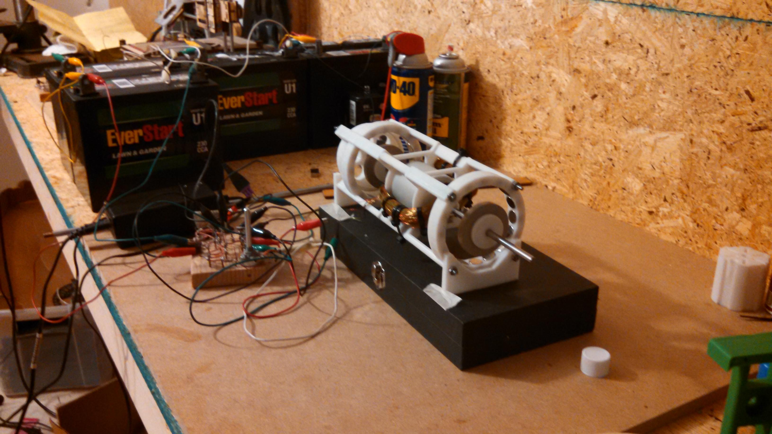

ID:	49365 I have it up and going again. This thing screams. I have it on an SSG circuit. I have four 12V lawn batteries in parallel on the back end. The primary is the same 32V power supply from the video. The rpm's increased from around 13.5k. As the batteries began to charge it gradually increased to over 20k. I beefed the rotor print up to 1.2mm from 1mm thick walls.

                  [ATTACH=CONFIG]6121[/ATTACH][ATTACH=CONFIG]6122[/ATTACH] I have it up and going again. This thing screams. I have it on an SSG circuit. I have four 12V lawn batteries in parallel on the back end. The primary is the same 32V power supply from the video. The rpm's increased from around 13.5k. As the batteries began to charge it gradually increased to over 20k. I beefed the rotor print up to 1.2mm from 1mm thick walls.
                  Mann

                    I have not hooked it back up to the B/C circuit yet. I'm probably going to have to build a blast box for that. The plastic surrounding the magnets is about double now. I have them completely encased in the new design. I hope some others build it and share their experiences. There is a lot of interaction of magnetic flux in this device.
                    20k+ on a single TIP41c NPN transistor is awesome. The only real heat is in the 1/2w 680 ohm resistor for the trigger. It does not get hot enough that you can't touch it. The variable 0-5k ohm resistor does not seem to heat up. The transistor only gets room temp. I have two 1N4007's in parallel for the output. I am using 4 - 120' lengths of #29 awg for the power wire and 2 - 120' lengths of #31 awg for the trigger. They all tie into the single transistor SSG circuit. You can see from the pics that there is plenty of room for more wire. Generator coils could also be added.
                    I can't imagine what could be achieved with a higher powered system or if someone decided to print a 200% scale model.
                    The glass cap can be placed on the other side if someone wanted to install another safety precaution. I left it open for possible add-ons in the future.

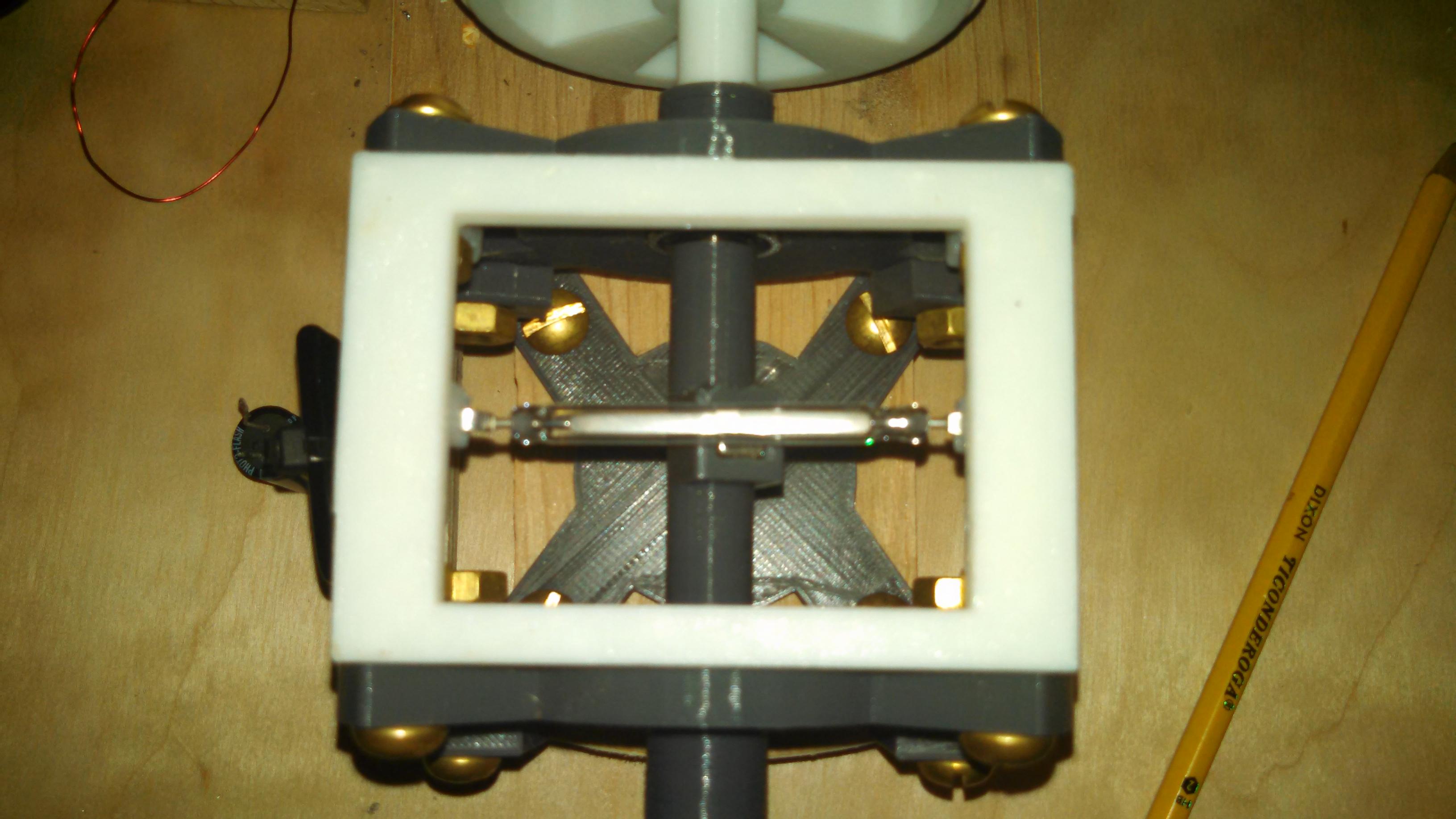

                        Reed Switch Holder added to http://www.thingiverse.com/thing:1676878 Click image for larger version

                            Reed Switch Holder added to http://www.thingiverse.com/thing:1676878 [ATTACH=CONFIG]6196[/ATTACH]
                            Nice work.
