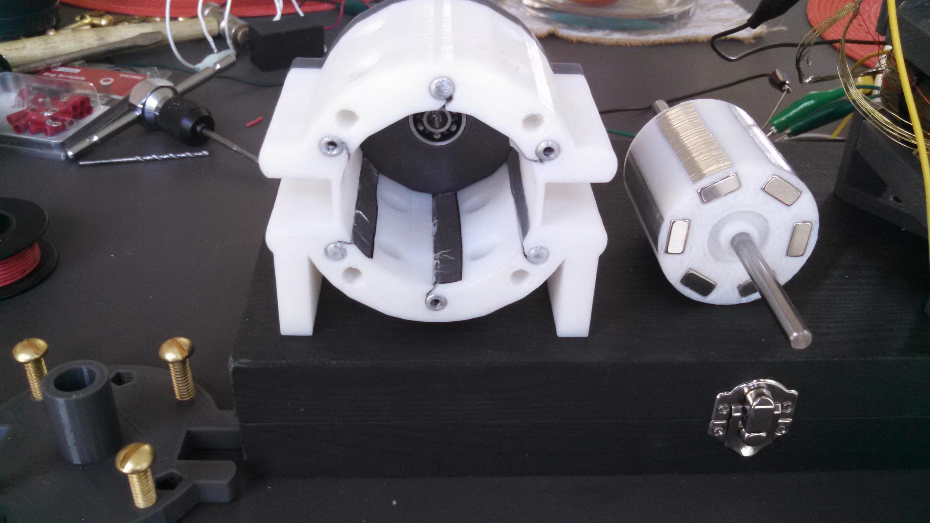

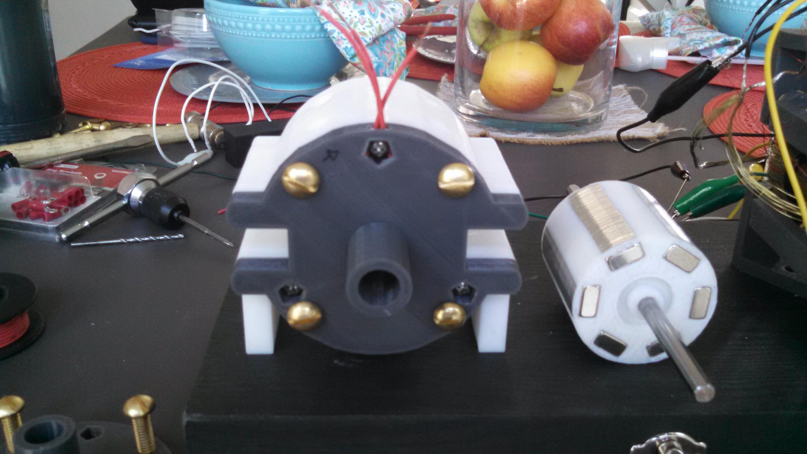

    Here are two update photos for the current Window Motor project. Click image for larger version
ID:	49017Click image for larger version
ID:	49018 You can see here that I have drilled and tapped the 1/4" aluminum stock to attach the leads for the high voltage. I am using 22 gauge stranded wire (red wire) for the leads. I have aluminum foil attached to the inside of the housing from the 1/4" aluminum round to emit the ions across the rotor. The rotor has the 6 strips of aluminum tape attached to it directly over the neodymium magnets. The rotor was attached to the shaft using Gorilla Glue after I slightly sanded the shaft. Only use a little of this glue because of the expansion. No glue was used for the magnets. You should not need it. I am going to use 26 gauge magnet wire for the power windings and 31 gauge for the trigger wires. I have not determined how many power windings I will be using. It will either be 2 or 4.

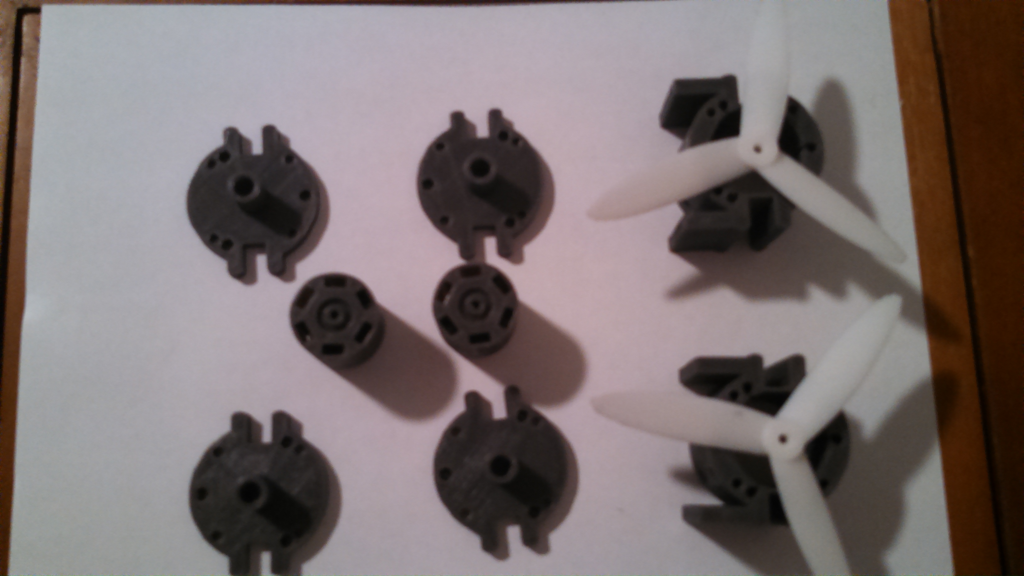

            Who can guess where I am going with this next picture? Click image for larger version
ID:	49022 These are 50% scaled models of the Window Motor. I have no experience with air displacement or aviation. This may be a start for a new topic. The propeller is a 70% scaled model of this Thingiverse file: https://www.thingiverse.com/thing:590502 It fits perfectly for my 1/8" brass shaft.
            Doug

              Half of a quad copter drone?
              • #52
                Yes John K, that is a project for the distant future for me.

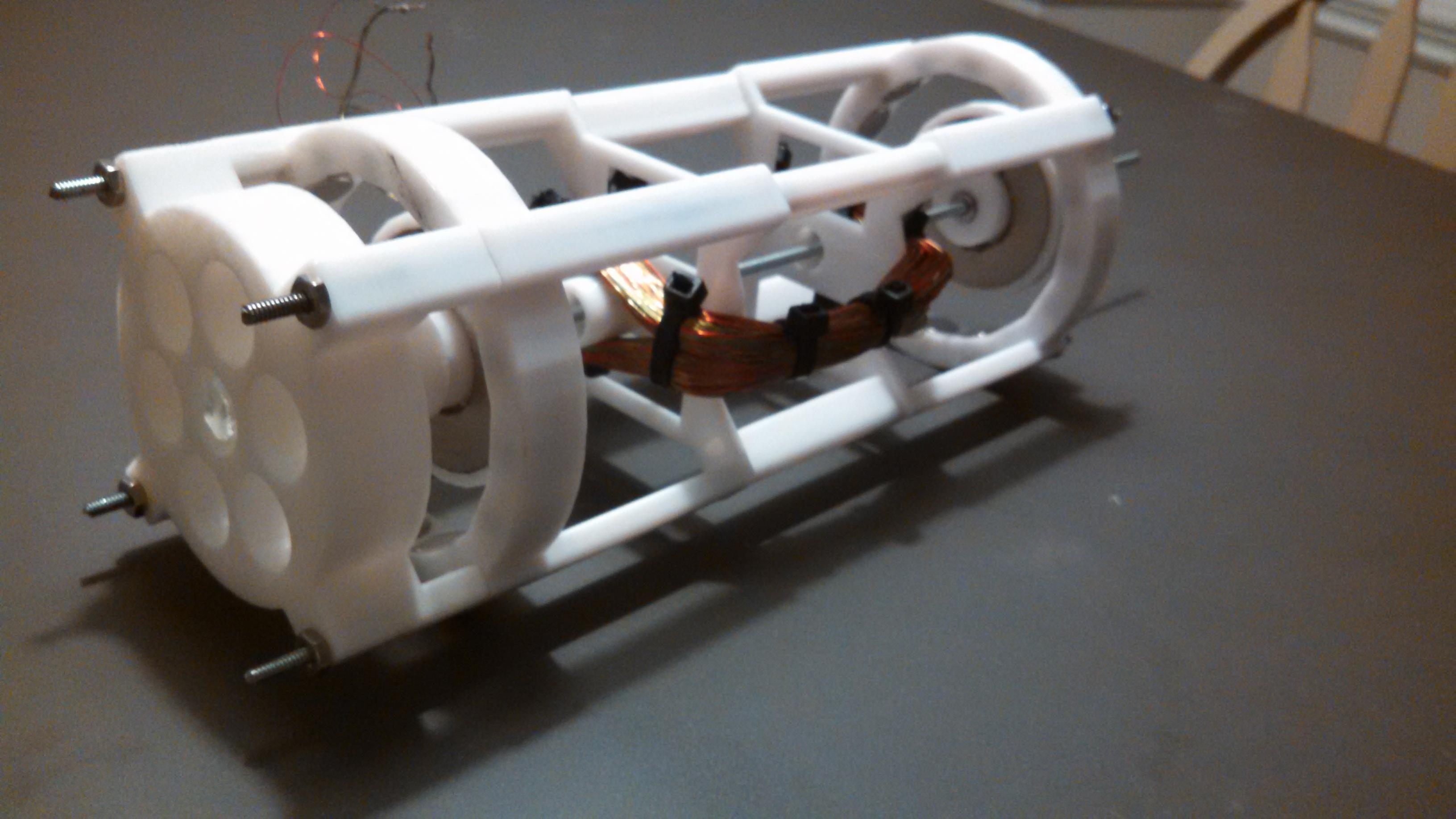

                    DadHav did one of these about five years ago. https://www.youtube.com/watch?v=VHJRWL42rCU I thought it was really neat and decided to do a 3D printed version. It still needs a good deal of refinement but it is about ready for preliminary test. You can see that it is a spinoff from the Hamel and B/C Window Motor File that I listed. It is about 10 inches long. The end magnets are powerful and provide a good deal of stability for a small gear or belt system. I'm going to put some legs on it and provide a place for the circuit.
                        [ATTACH=CONFIG]6005[/ATTACH]
                        DMann
                        Nice DMann,
                        What size/demension magnets are you using?
                        KR - Patrick

                          I mean for the suspension...
                          • #58
                            .5" X .25" neo disc (outer) qty 32 & 2" outer X 1" inner X .25" thick neo ring mag (inner) qty 2
                            • #59

                                That's very nice! I have to say, I did not picture the support magnets in that configuration - very cool.
                                KR - Patrick
