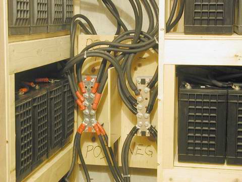

        This was the way I was going to setup my battery bank. With this Tesla Technology would it make the benefits of doing this obsolete?

          a bank of batteries is never obsolete. not sure what you are asking about that. as for an inverter, outback, zantrex, sunny boy and fronius all make excellent products. I have a 5kw fronius grid tied inverter. has wireless communications i can look at energy output from my phone or pc. if you are going off the gris you need a charge controller/inverter combo. outback is the way I would go...

            I'm talking about the way the batteries are each connected to a terminal block as illustrated in the picture. There are benefits in doing this with a conventional solar setup. What I was asking are those benefits not required with the tesla tracker technology.

              that way is still the best way. the important thing with terminal blocks and large wires is that everything is the same length. there is a lot of discussion on solar forums about battery cables routing. most of them have to do with where to put the positive and negatives from the panels so all batteries see the same thing.
