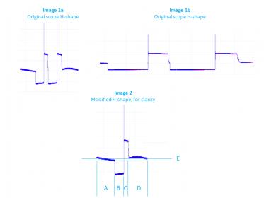

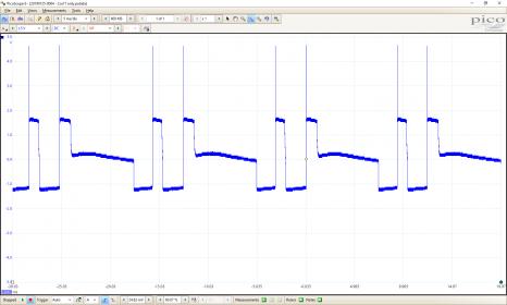

    3- Looking at the H-shape, measured with my scope (Picoscope 2206B) over just 1 coil, can someone please explain to me exactly what goes on at the positions indicated in attachment 2, image 2:
    3a-I assume section A and D represent the nominal secundary battery voltage level (indicated also by the vertical line E?
    3b-What is happening exactly at section B and C? (in Energy from the vacuum DVD 6 @ 57min John mentions that in this section B the “device” is trying to be a “negistor”, but with that explanation it still is clear as mud to me .

      #3 ....... 3a ............Section A, section D and line E are the nominal primary battery voltage. The transistor and coil scope shots only show what is happening in the primary circuit.
      3b ............ Section B is the period of time the transistor is "turned on" or conducting and the current is building up in the coil. The transistor turns "off" abruptly at the end of section B and section C begins. At this point, the coil voltage "radiant" spike occurs and is picked off by the high voltage diode and fed to the secondary battery. Section C is the remaining coil collapse voltage plus generated voltage from the passing magnet and also some coil ringing from the abrupt discharge. Section D is the nominal primary (run) battery voltage plus some voltage generated by the passing magnet. The transistor is turned "on" again at the end of section D to start the cycle of events over again.
      A "negisor" is any device that exhibits negative resistance or decreasing voltage drop with increasing current flow. The MJL21194 transistor is one of a handful of transistors that exhibit this characteristic at certain points in their operating curve. Such devices usually are cold to the touch when running in this condition. This behavior is often associated with radiant energy, plasma discharges, and also occurs with tunnel diodes. The SSG will still work, however, even without the "negistor" effect.

        #3a I’m I right in saying, that the term “nominal primary battery voltage” is incorrect for this sections A and D (and line E). For the following reason; there is no voltage across the coil in these sections, since the primary battery circuit in these sections is not connected. (If it would be, I would expect to see this voltage when I put a volt-meter across 1 coil when the wheel is not spinning, but it read 0V).
        #3b Thinking about the power consumption of the primary battery; if I understand you correctly this takes only place at section B, where the transistor is on, correct?

        #4a Reading your explanation I realize that I was mixing up two different things: the H-shape is a visualization what happens across 1 coil, not what is happening across the transistor. But now that we brought it up, reading your explanation:
        Theoretically speaking; you’re saying that if I would see a plot/graph of the voltage across the transistor I would see a voltage INCREASE at the section where the transistor is switched on? Would I be able to see this on my scope? Do you by any change have any operating curve of this transistor showing this effect?

            I'm not exactly sure about the double firing, but it has to do with the interaction between the permanent magnets, the power windings and the trigger winding of the coil. The factors that affect this are coil to magnet spacing, magnet strength, speed of rotation, and base resistance.
            The magnetic field is unsymmetrical, being stronger at the edges than in the middle and in the form of a vortex. But I don't think that's what causes multiple pulsing of the SSG.
            When the scope probe is on the transistor collector and the probe ground lead is attached to the emitter, the scope shows the voltage across the transistor. When the transistor is on this value is the forward voltage drop of the transistor (0 to .6 volts). When the transistor is off and the machine is not running the scope will show the primary battery voltage. ........... When the machine is running and the transistor is off, the scope will show the h wave that appears across the transistor. (When the wheel is not spinning a volt meter across the coil will show 0 volts and the same meter across the transistor will show the full primary battery voltage.)
            The only difference between the scope trace across the coil and the scope trace across the transistor is whether you hook the probe ground lead to the primary battery positive post or the primary battery negative post. The trace is the same except for the zero voltage point on the scope, which is the value of the primary battery voltage. (And a scope trace of the trigger winding voltage is very similar, except it is inverted.)

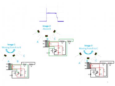

              Aaron / Gary,
              In the beginners manual, page 70 & 72 (see attachment 2) I read about the switching when the magnet is right above the coil, implying that the magnet field is strongest there. This in opposition to what I understand from Gary that it is strongest at the edges. Should I interpreted this as that the handbook talks about a simplified theoretical situation to understand the basics while Gary talks about the real/practical situation?

              “You mention the sequential mechanics of repulsion mode switch” I assume you’re referring to my first post (#196), attachment “2019-02-27 - Attachment 1”?
              If so, I just saw that the arrows were going in the wrong direction (text was correct), they might have caused confusion. Please see attachment 3 in this post where I removed the arrows. Just to double check we’re on the same page; I intended to speak here about the ATTRACTION mode, as mentioned in your first (Beginners) handbook, page 72 (version 1.13).
              Regarding your question what switches on the base to turn on the Main circuit in both modes:
              As you mentioned, in REPULSION mode it is the decrease in magnetic field strength when a magnet moves away from the core.
              In ATTRACTION mode it is the increase in magnetic field strength when the magnet moves towards the core.
                Don't worry about where the field is the strongest on the magnet face. The book is basically correct in it's explanation. I just know that mine pulses the charge battery just before the magnet reaches the edge of the metal core as shown by an automotive timing light.
                I can get my machine to 375 RPM single pulsing in radiant mode with two 13 amp hr batteries while lighting 82 LEDs from two genny coils, but it doesn't charge very fast this way! (You can see this thread at http://www.energyscienceforum.com/showthread.php?t=2041 ). I presently have it set up with three, 105 amp hr, 12 volt deep cycle batteries in a split the negative configuration. These batteries are too large for the machine and will not allow it to get above 220 rpm and into single pulsing. (My current setup can be seen here. http://www.energyscienceforum.com/showthread.php?t=4098
                And in answer to your question about the direction of the arrows in the book, they show the correct direction for "electron current flow" (negative to positive) and not the standardized "positive particle flow" (positive to negative).

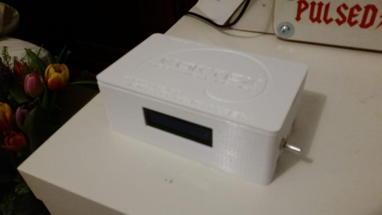

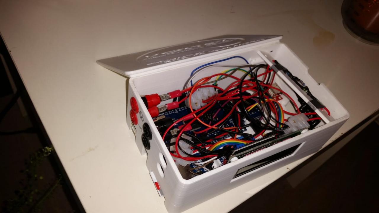

                • Thanks Gary for you replies. Just wanted to let you know that my SG project is going a bit slower at the moment because of some other projects that needed some attention. Will pick it up again soon I hope, and continue our conversation.
                  Last thing I did on the SG this weekend was making an "unload" circuit for the batteries with an arduino (see pictures). So in combination with the SG machine I can do load/unload cycles to compare the amount of energy I can get into (& out) batteries with a regular charger in comparison with a SG machine. Contacted battery suppliers to ask for discharge info/characteristics, but they are not very forth coming with information, although i received some.
                  This arduino also has the feature to measure the signals of my rpm sensor and give me an RPM/Frequency reading so that I can finaly start tuning my machine properly.
                  Best regards,
                  Rodolphe

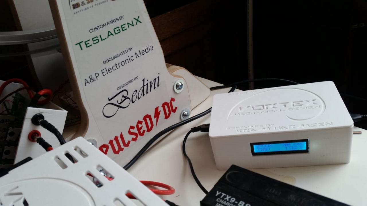

                      • Hi All,
                        Finally got my rpm measuring system installed and operational. Hereby i would like to share some of my measurements.
                        I hope you can give me some feedback regarding if my SG is running properly, so i know whether I can continue with the following steps/upgrades.

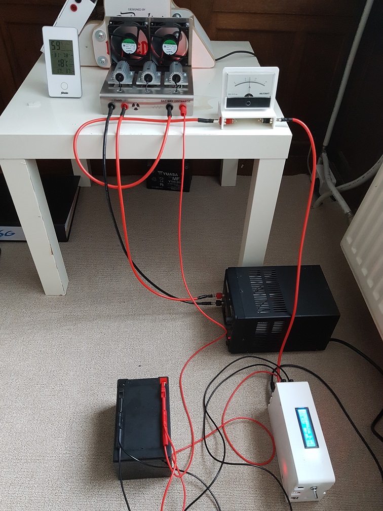

                        My SG is currently built up to and including chapter 1 of the intermediate manual. That means:
                        -matched resistors (100 ohm)
                        -matched transistors
                        -1k potmeter
                        -Input is NOT connected to a battery but a variable power supply, Eagle (Rapid) EP-613. Input voltage for my SG set @12.3V.
                        -Output is connected to a damaged* motor start battery: Yuasa YTX-BS
                        *when left alone for a while, voltage drops to and stays at 10.54V
                        Measurements, With a clearance between the coil and the magnets of +/-1/8":
                        Max rpm I can get out of it is 204rpm @ 12.3V input, 1.16A input.
                        If I (try to) optimize between amperage and rpm: 202RPM, 12.3V input, 0.84A, pot meter @ +/-92ohm
                        Measurements, With a clearance between the coil and the magnets of +/-1/4":
                        Max rpm I can get out of it is 194rpm
                        If I (try to) optimize between amperage and rpm: 187RPM, 12.3V input, 0.77A, pot meter @ +/-89.2ohm
                        What I find it that the potmeter is extremely sensitive in the area where I try to tune, and I'm in doubt whether my potmeter has the quality that is needed for proper tuning... The one I have now is this one:
                        https://nl.rs-online.com/web/p/potentiometers/6928513/
                        The battery I have in mind to start doing real tests with is this one:
                        12V, 12Ah, deep cycle, lead acid: https://nl.rs-online.com/web/p/lead-...eries/5377305/
                        The initial test I have in mind is comparing how much energy I can get out of the battery when it is charged with regular charger, compared to my SG.
                        I've built a discharge circuit that can log the Voltage of the battery over time.
                        Looking forward to your input,
                        regards,
                        Rodolphe

                        • Hi All,
                          I still have my SG built up to and including chapter 1 of the intermediate manual*. I wanted to do some testing with it before continuing with the rest of the manual/upgrades.
                          So I bought a deep cycle battery**, 12V 12Ah@20h, AGM. And I made a battery drain circuit/assembly***, so I can drain the battery and then charge it with my SG.
                          After draining the battery I tried to load the battery with my SG, but after about 13 hours of charging with my SG, I got the battery loaded till +/-13.46V (Voltage-reading while still being connected to the running SG). By that time it was midnight and I switched the SG off and disconnected the battery.
                          My question is: is it normal to take so long for the SG to charge a relative small battery?
                          Also; in Chapter 7 of the beginners manual page 78, I see that the battery loading graph goes up to 16V... This gives me the impression that the loading cycle wasn’t even done after 13 hours and I should have let it run for another eternity?
                          As a comparison, before I started to charge the battery with my SG, I did a couple of charge cycles with a regular battery charger****, and that one brought the battery up to +/-14.4V in +/-4.25 hours.

                          • Hi Rodolphe,
                            My question is:[/url]
                            The deeper you discharge the battery, the longer it will take to recharge it. Plus your conventional charger only took it to 14.4 volts to start with, which is not fully charged. Even though this is a new battery it has never been fully charged and has some lead sulfate left on the plates. It will take several charge/discharge cycles up to 15.3 volts to condition the battery and get full capacity out of it.
                            The power supply doesn't work nearly as well as a battery for the primary (run) source for several reasons. And running it at 12.3 volts is way too low of a voltage.
                            For best results with a vanilla SSG you need at least a 13AH battery on the primary side and two in parallel is even better. The higher the primary voltage and AH the faster it will charge the secondary.
                            Once you get the charge (secondary) battery fully charged (15.3 volts under charge) let it sit for an hour and then discharge it only 1 or 2 amp hours. Then let it sit for an hour before charging it back up. This allows the electrolyte and plates to normalize. Now you can put it back on the SSG and see how long it takes to bring it back to full charge (15.3 volts) using a fully charged primary battery and/or batteries.
                            You will slowly kill your new battery if you don't fully charge it each cycle. The charger you are using is charging with current instead of voltage spikes and won't ever get it to a full charge. The SSG is more about the battery than it is about anything magic. You need to get your new battery up to 15.3 volts either on the SSG or with a proper charger. This is one of the chargers I use and would recommend to you. http://www.teslagenx.com/chargers/tx...egory=chargers
                            Now for a guide, my SSG in radiant mode will replace 1 AH in that size battery in about 1.5 hours while drawing 1.2 amps from the primary. But if I run it in generator (common ground mode) it will replace that 1 AH in 30 minutes at 1.6 amp draw from the primary.
                            One other thing that greatly affects the charge rate is too much resistance anywhere in the circuit. You need at least AWG 12 wire size for all battery connections and AWG 10 is even better.
                            • Also, AGM battery's are not recommended for Bedini Charger circuits, You want Flooded Lead Acid battery's like garden tractor battery's....
