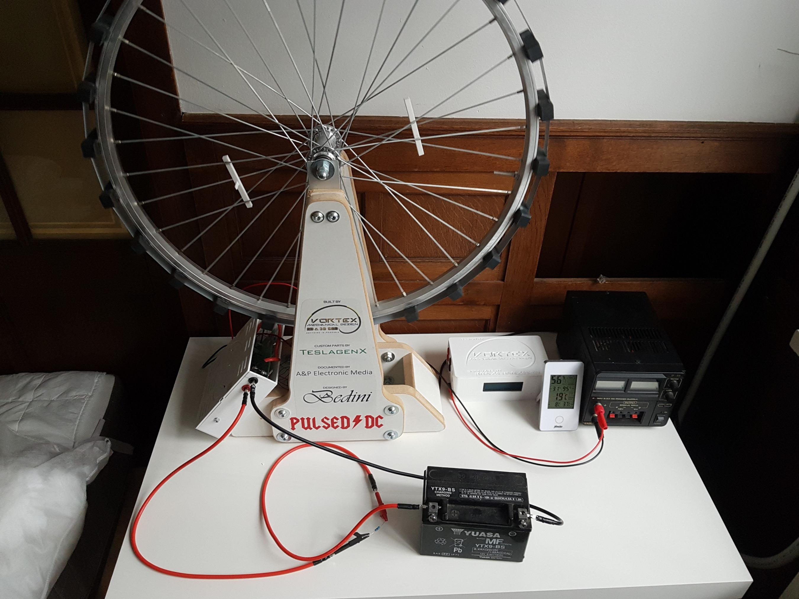

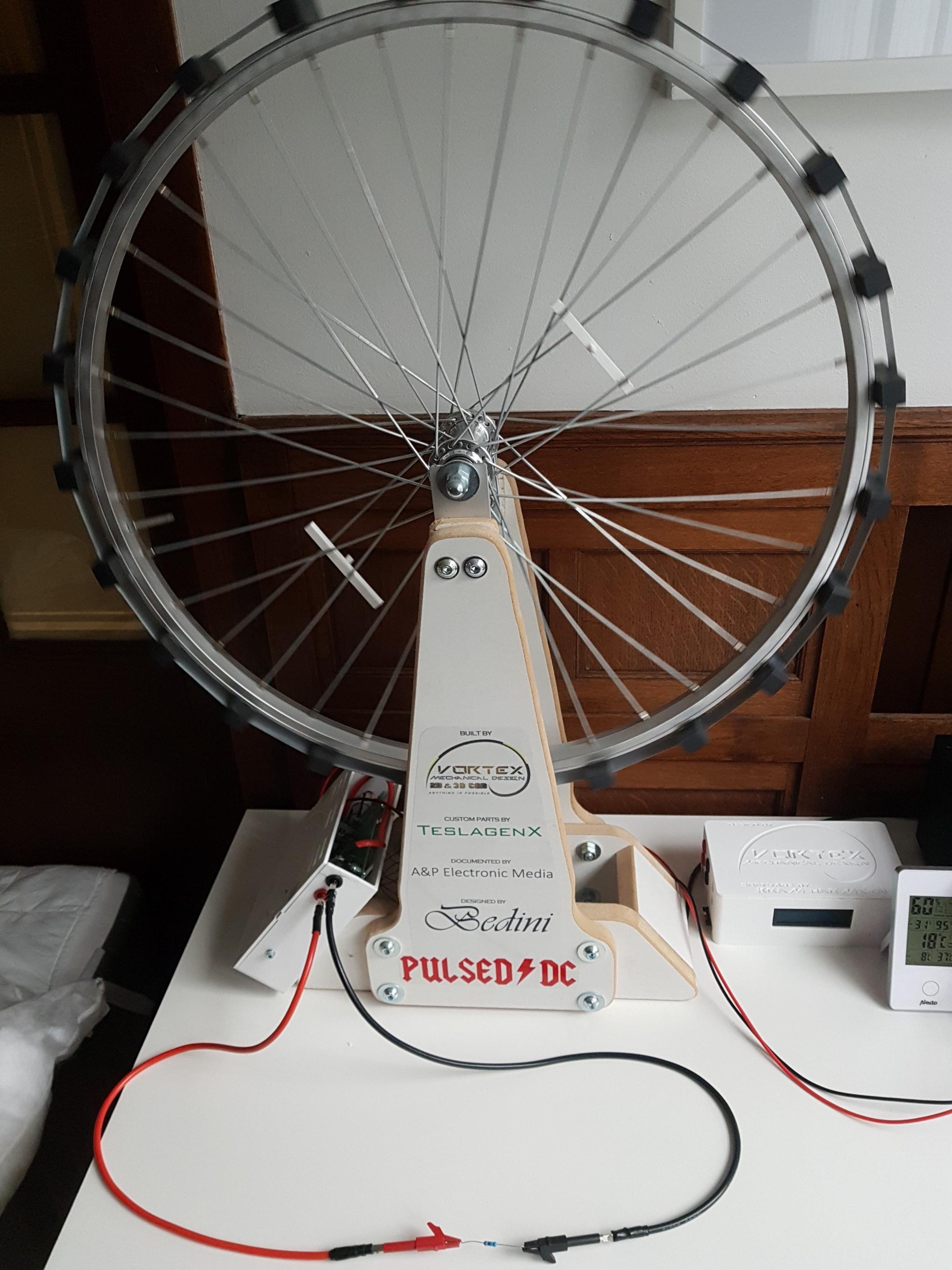

      At this moment I’ve followed the manuals up to page 13 of the second (intermediate) handbook. So for the resistances I have the 100Ohm (matched) resistors in and the 1k Ohm potentiometer (see attachment 1). The reason why I stopped here is that I wanted to build in a speed/rpm sensor, so I can tune it properly, rather than just by listening (sound of machine reving up/reving down). As soon as I have the speed sensor installed and operational I’ll tune it properly and report back here with what value I ended up with on my pot-meter and input amperage/voltage.
      Aaron/Gary
      Another question that came to mind; I guess the double firing would be a welcome phenomenon, getting two for the price of one. Or is this a misunderstanding of what’s happening? In other words, will the voltage peaks be half as high as well for example?

          When you talk about the AC signal, you’re talking about the signal/images as shown in the attachment of my post #196?
          At the moment I’m not familiar with the Window or ZFM motor. I’m just trying to build the SG according to the manuals of Peter Lindemann and Aaron Murakami. The coil/bobbin I use in my SG is a prefabbed and supplied by TeslaGenX: http://www.teslagenx.com/parts/tx-co...category=parts. 7x20AWG+1x23AWG 130' <- That is the one I have. The specs you gave are very different from the TeslaGenX Coil. I would be very keen to experiment with it, especially if you say you go from Amps as input to mAmps, but for now I think I should stick to the manual: My understanding of the machine is still limited / still have a lot of questions, if I deviate from the manuals at this point I will have even more questions / understand less of it that I do already��. I still need to finish the 2nd and 3rd manual.

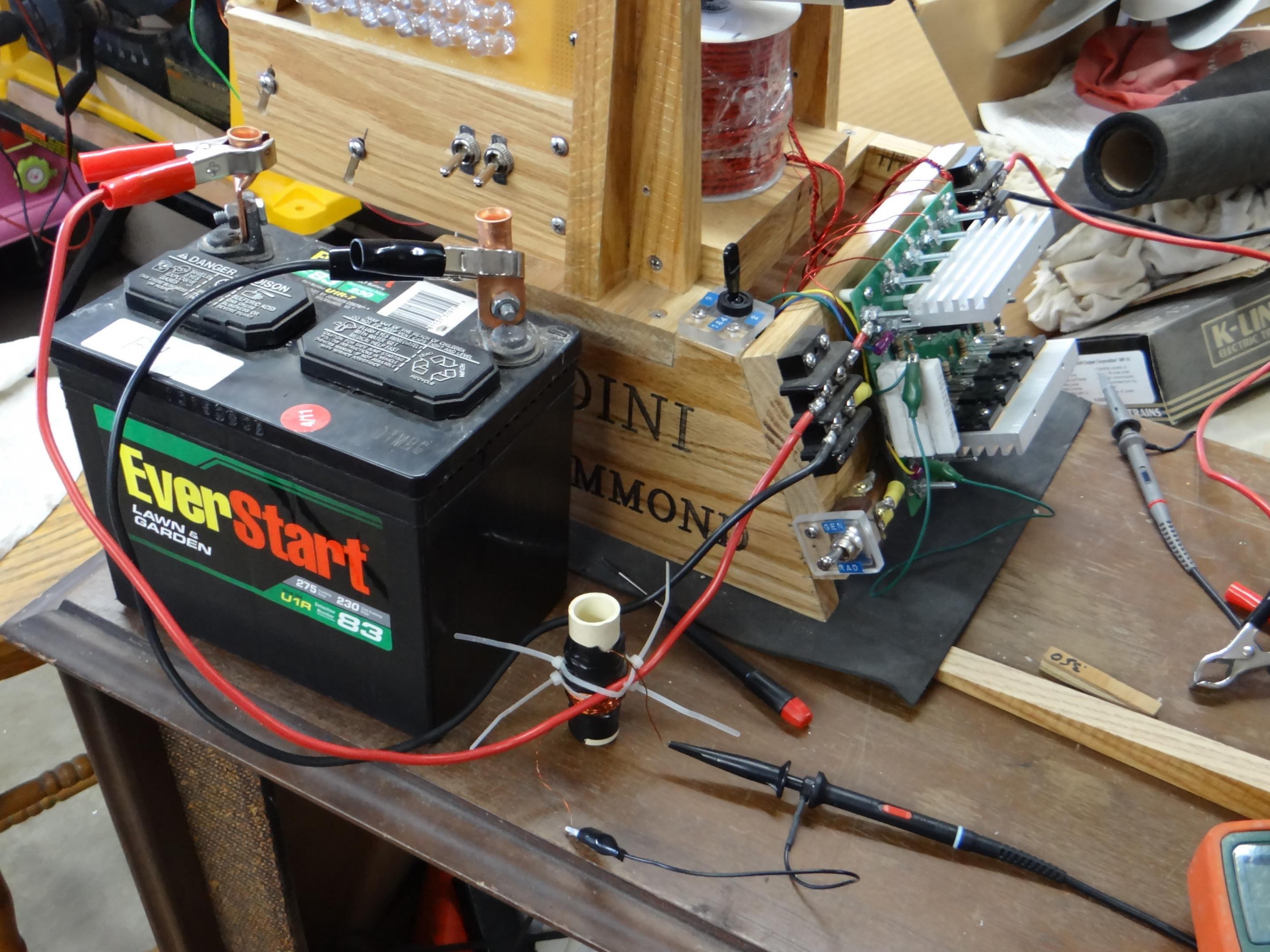

                  My sniffer coil is just a few (200 or 300?) turns of AWG 26 wire wrapped around a short piece of 3/4" pvc plastic pipe. The coil is placed at 90 degrees next to a battery lead and the ends of the coil are connected to the O-scope probe and it's grounding lead. It "sniffs" the electrical field surrounding the battery lead and displays the waveform on the scope. Here's a picture of it.
                  Click image for larger version  Name:	sniffer coil.jpg Views:	0 Size:	566.4 KB ID:	72542

                            In “DVD 24: Bedini Monopole masterclass I” John says that you can connect a 1-Ohm resistor between the output wires of the SG and if it heats up, the SG is not running correctly.
                            I just put that to the test by putting a 100-Ohms resistor between the output wires and held it between my fingers, but the resistor heated up quickly to the point that I could not hold it anymore, so I shut the machine down again. Neons were flashing as well during this exercise.
                            Can any of you test this as well? / Have feedback for me?
                            Thanks in advance,
                            Rodolphe
                            Update @ 1:40pm
                            Started to doubt whether John maybe meant the resistor in series with the battery rather then just swapping the resistor for the secondary battery. So I tried that as well, see picture, but with the same results: resistor heats up and the neons flash.
                            P.S.
                            Just had another quick look at the DVD 24; later in the DVD he connects some car lamps between the output of the SG with a resistance of 0.4-Ohm, see screenshots.
                            Click image for larger version  Name:	image_6261.jpg Views:	3 Size:	485.9 KB ID:	72566 Click image for larger version  Name:	2020-02-03 - Resistor experiment 2.jpeg Views:	0 Size:	486.7 KB ID:	72568
                            Click image for larger version  Name:	2020-02-03 - DVD 24 -44min 1.PNG Views:	0 Size:	37.1 KB ID:	72569 Click image for larger version  Name:	2020-02-03 - DVD 24 -44min 2.PNG Views:	0 Size:	38.2 KB ID:	72570

                              The transistors don't like the 300 volt spikes! If you really want to see these spikes on your scope, you can remove the coil leads from the transistor collectors and instead power the coils through a momentary contact push button switch. Because the switch is mechanical, it will survive a few rapid pulses of current flow into the coils. You can then measure across either the coils or the switch with your scope to see the high voltage produced when the switch opens. You will also see the ringing that takes place in the coils when they are switched off.
                              I haven't watched video #24 in a while, but I thought John showed using a 1 ohm resistor rather than a 10 ohm one? This will still heat up a little with a seven power winding coil from Teslagenx. It will also dimly light a single automotive type 12 volt bulb. You can also charge a capacitor on the output and place a 12 volt bulb across the cap to limit the voltage.
                              With my SSG (same coil and circuit board as yours) I can charge a 12 volt battery with a 500 ma load of LEDs while it is charging and the battery voltage will still climb. This shows that the machine can still charge a battery while it is carrying a load! And here's a link to a post where it was running in common ground mode and pulling a 1+ amp load while charging a 12 volt battery.
                              http://www.energyscienceforum.com/fo...7838#post27838

                                A 100 ohm resistor looks like an open circuit to the SSG output. That's way too much resistance and will cause the neons to light up. You need 1 ohm or less for this test! And yes John meant to attach it between the output terminals and not in series with either battery.
