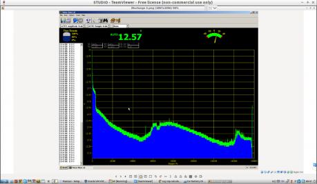

Hi Yaro-
For those last two discharges I didn't alter my charging config at all. I've posted a photo of the discharge curve right before those last two....it was very active. What I mean by that is that the voltage dropped as usual, and then started to gradually rise over the course of an entire day (while the load was still connected). Then this process repeated. Started to fall, and then rose back up. It wasn't a sudden rise in voltage either, it looked like it was discharging backwards haha.
Whatever was going on inside the battery during that discharge cycle resulted in a massive recovery of capacity.
Oh and for the runs you mentioned with a longer rest period...that wasn't intentional. It just ended up that way due to being busy or kids trying to get into my stuff.
