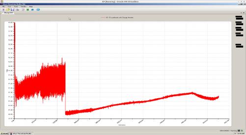

                              • Wanted to share with everyone a charge run on a battery that is responding very well to the desulphation abilities of the SG machine. This is running on 24V pulling slightly over 1A. Single coil.
                                You can see that the voltage shoots way up to 13V right from the start, indicating high impedance/a high level of sulphation. Then there is a drop down to around 11.5V and a gradual rise over the next 24 hours. Then another massive drop down to 10.85, and a gradual rise. Overnight the voltage fell again as more sulphation was cleared up, indicating more change in impedance. Now this morning it's on the rise again.
