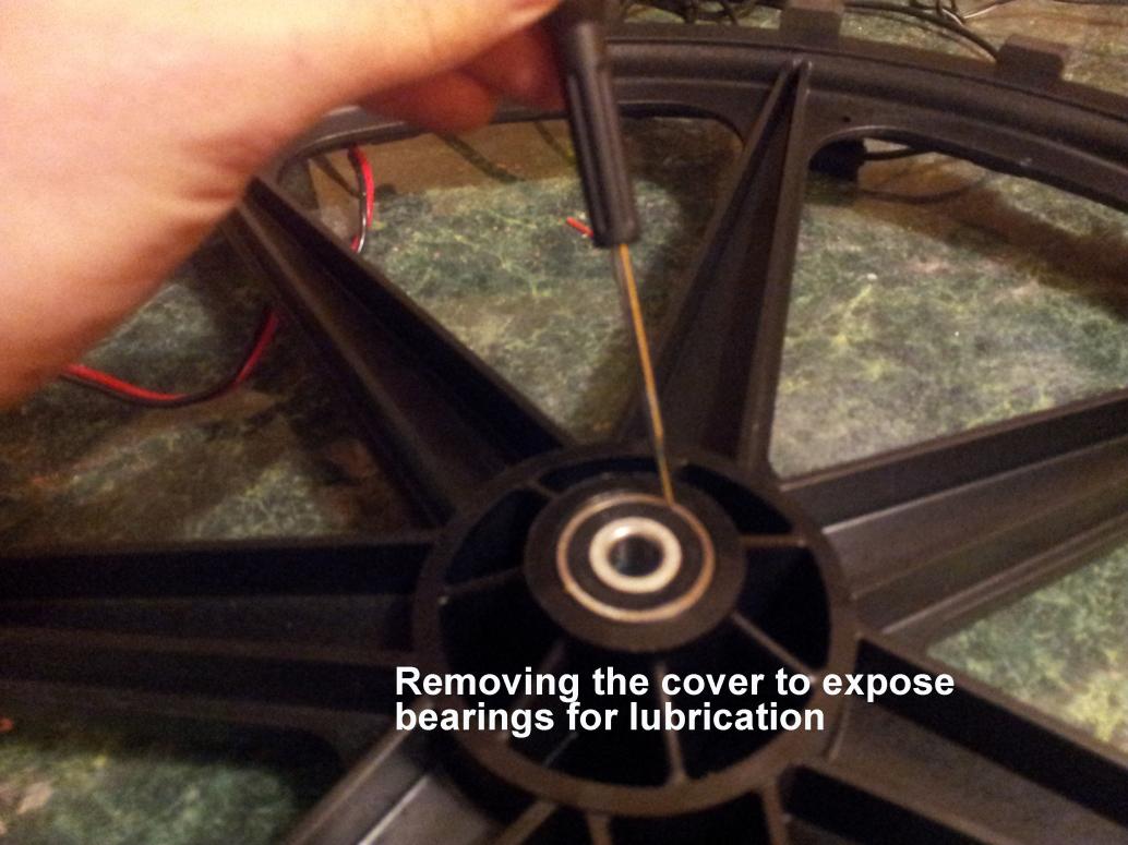

Thanks Tom! I looked up a vid on how to pop off the metal ring that keeps the bearings in. Hopefully it's the same process for mine. I'll be working on it tonight.
Originally posted by Tom C View PostYes tri flow is my preffered lubricant. I remove the dust seals and clean out the grease, then spray liberally. balance using pennies or a screw put in opposite the heavy spot.

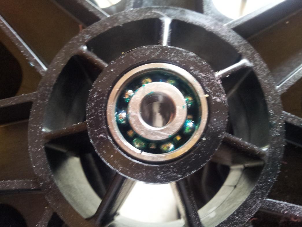

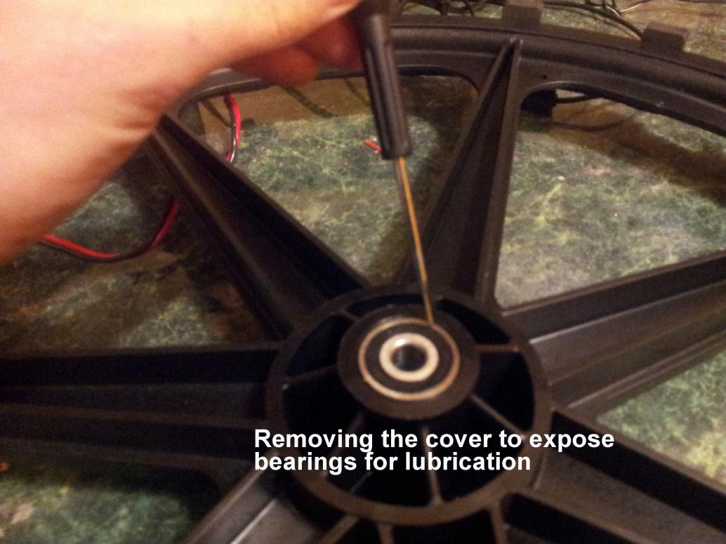

So I popped off the rubber cover to expose the bearings. They were protected by a thin plastic casing which had to be removed as well. It is not reusable....but I don't think it's essential.
However, there is no way that I can see to get these bearings out of here. The gap is too small. How did you degrease yours? I can probably shove a paper towel down in there and rotate it around...but I'm not sure it's going to be as effective as pulling them out.
Here's a photo of what I'm looking at.

Those are just like the ones in my SSG wheel (Previously a wheelchair wheel) just use a degreaser/cleaner, I used paint thinner and then dried them with a heat gun to be sure to get the thinner out. Put some light oil in them and you're good to go.
Brian
Originally posted by Branch Gordon View PostSo I popped off the rubber cover to expose the bearings. They were protected by a thin plastic casing which had to be removed as well. It is not reusable....but I don't think it's essential.

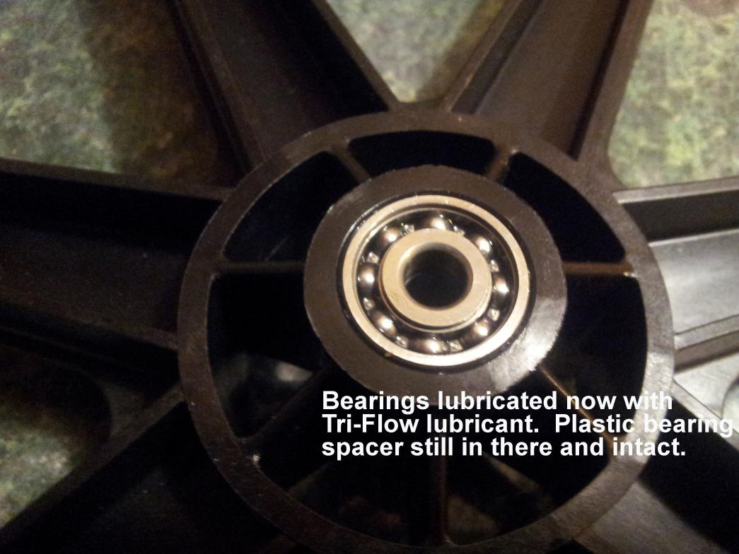

just to make sure you did NOT remove the plastic cage that spaces the bearings, correct? if you did you need to pull out the entire bearing races and all. the bearing will not function if the balls are not equidistant, so yes it is absolutely essential.
That sucks. Yeah I removed the plastic cage.
Discouraging....
Originally posted by Tom C View Postjust to make sure you did NOT remove the plastic cage that spaces the bearings, correct? if you did you need to pull out the entire bearing races and all. the bearing will not function if the balls are not equidistant, so yes it is absolutely essential.

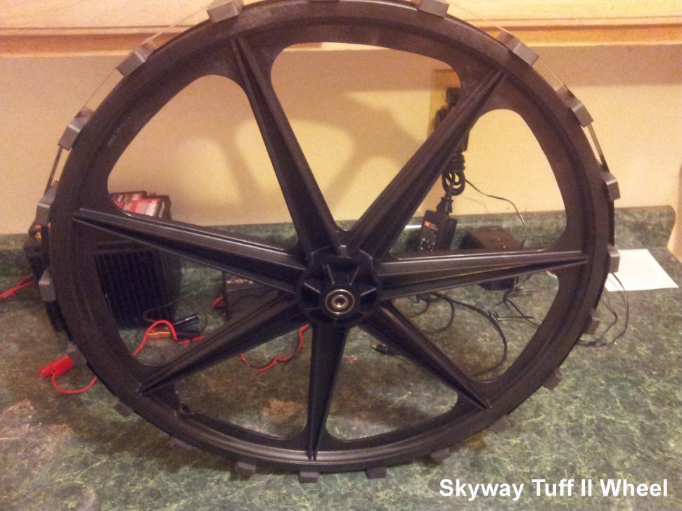

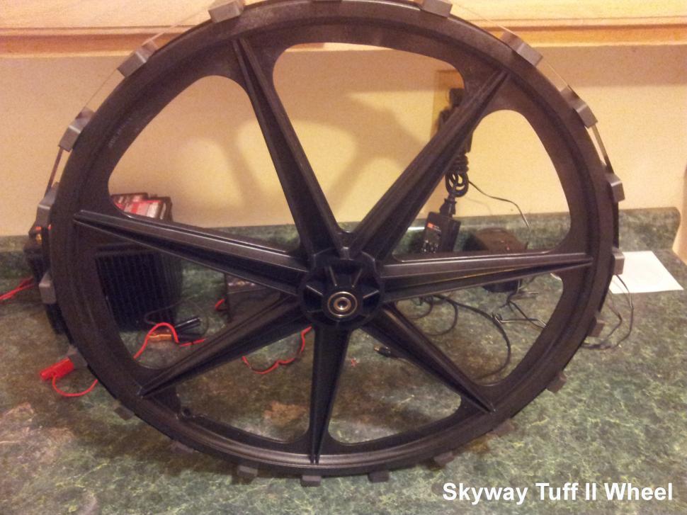

I've been away from the forum for awhile..but I bought the new book and am wanting to jump back into this.

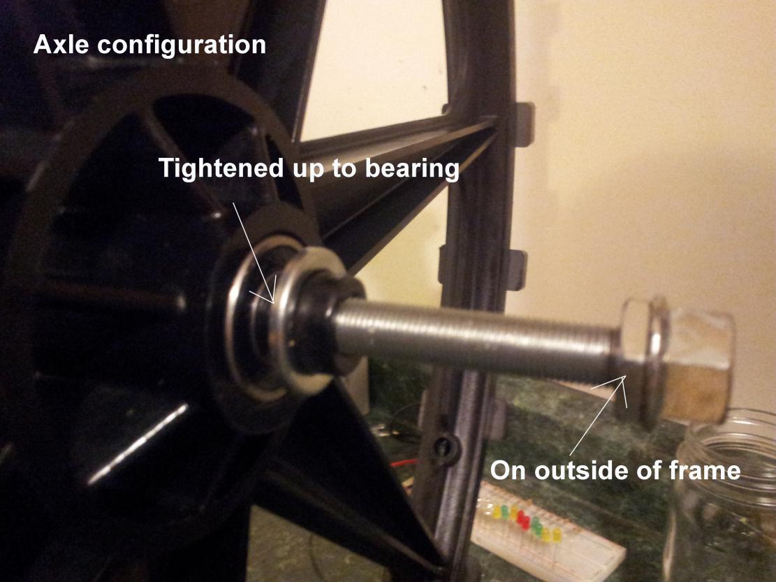

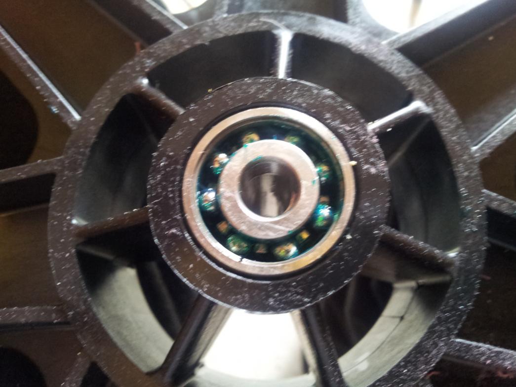

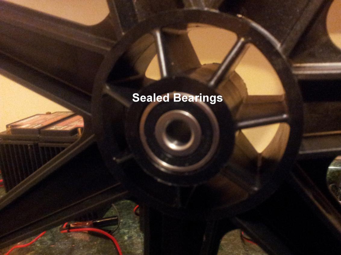

Last time I was on, I had messed up my bike wheel bearings by removing the plastic cage that separates the bearings. I took it to a bike shop, bought new bearings, and had them degrease them completely. So when I brought my bike wheel home, I had bearings that were bone dry...planning to lubricate with Tri-Flow.
I have done that, sealed the bearings back up, but they still have a lot of friction. I was getting around 3:30 minutes of free spin time before I switched over to these new bearings with different lube. Now I'm getting only 1:30 minutes of free spin. I can feel the friction if I spin the wheel and hold the axle in my hands...but I'm not sure where it's coming from or why.
Pictures attached. I'm hoping Tom C can chime in as he recommended the Skyway wheel and hopefully has experience with this configuration already.
Cheers!
Branch
what John K said. especially if there is no spacer on the axle in between the 2 bearings. overtightening the shaft will pull the inner races together and it wont run in the center of the race.Originally posted by John_Koorn View PostHi Branch,
Welcome back
I think you need to loosen the nuts that butt up against the bearings. You need to have about 1mm of slop so the bearings are not restricted in their movement and the balls can run freely in the races.
Hope this helps...

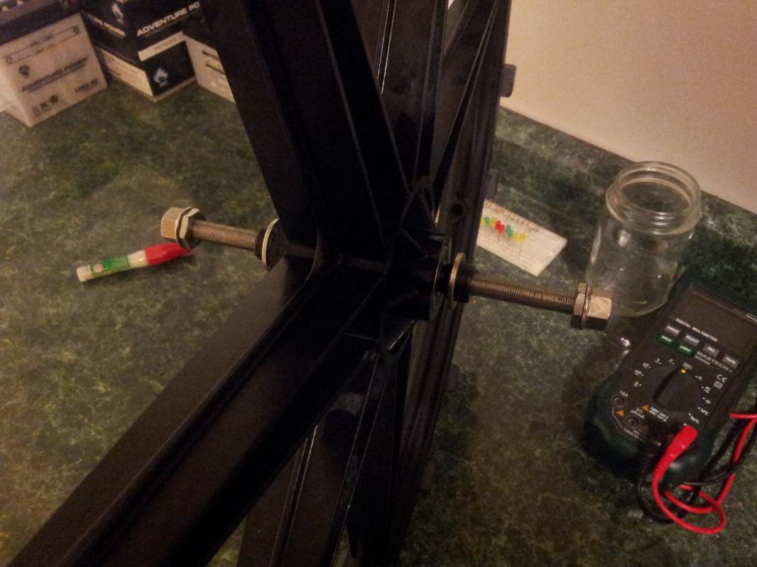

Thanks for the tips John and Tom. When I loosen those nuts, it appears as though the wheel is just spinning around on the axle, without
making the bearings turn. However when I have the nuts tightened, it forces the core of these bearings to be engaged and rotate.
If I am going to have the nuts loose, why have them on at all? Or am I wrong in my understanding of how the bearings work?
On my previous bike wheel I did what you are suggesting and it made a big difference, but that one had standard bearings, not sealed.
Originally posted by Tom C View Postwhat John K said. especially if there is no spacer on the axle in between the 2 bearings. overtightening the shaft will pull the inner races together and it wont run in the center of the race.
Thanks Bud! I am going to work on the loose coil for sure. Is the free spin time supposed to be measured with the coil under the wheel?
I have been measuring the spin with no coil close to the magnets.
