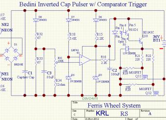

    • #77
      Thenuis,
      Here is JB's Comparator circuit the way he showed it at the 2011 conference (except for the 15V zener on the base of the Mosfets to protect the gates), this will run from a larger energizer like the Ferris Wheel, or the 7 strand SSG JB shows in the video in this thread, but pulls too much current to run from smaller energizers, so i modified it a bit, and use a micro power Comparator so that smaller energizers can power it, and still fill up a capture Cap to the target V in a short time
      add a 100uf cap from the 15V zener point to ground, as i missed that. R35 is a 100K pot
      i will re draw that Sch and include the missing cap
      JB,
      if what i have shown in this Schematic is not correct, than please tell me what to correct......

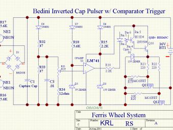

      • #78
        Ignore the above Sch, it is missing things
        Thenuis,
        JB,
        if what I have shown in this Schematic is not correct, than please tell me what to correct......
        • #79
          Thanks RS_
          Do you have a clearer schematic maybe, can barely make out the component values, it is cutting of on the left side over the neons.
          1. What components need to change to make this work on a 12v secondary battery system?
          2. If the secondary reaches it max volts, and JB's Comparator does not charge the secondary any more where does the Caps energy go?
          Really much appreciated.
          Theunis

          • #80
            That is a close up of a sch that includes the Bedini -Cole 1/2 H bridge Driver circuit that is not relevant here, so ignore the neon's on this Sch. Its showing the FWBR input to the Comparator Cap pulser circuit
            • #81
              Sorry missed your previous post
              Rs thanks again
              Sorry missed your previous post, re: clearer schematic will do with this then.
              (had to take my glasses off now everything look the same, FUZZY !)
              1. 15v zenner over the mosfets bases, 1 watt?
              2. what mosfets would you recommend?
              3. bases resistors 220 ohm?
              Theunis

                        I Really Really Like JB's comparator circuit, as it is self regulating, and self powered, and triggers when the cap gets to the target voltage. So that if the input to the cap changes for what ever reason, the pulsing ether gets faster or slower to compensate, and it always triggers at the target voltage
                        a 555 timer cant adjust to varying input to the cap, so that it pulses at different voltages above or below the target voltage, and has to have external power
                        Theunis,
                        I have created my board with PCBExpress and have tried to duplicate the comparator circuit that was shown at the 2011 conference. I posted my schematic back on post #39. After seeing the most recent video that JB has shown here with the comparator circuit, I decided to revisit the performance of my circuit.
                        Hope that helps!
