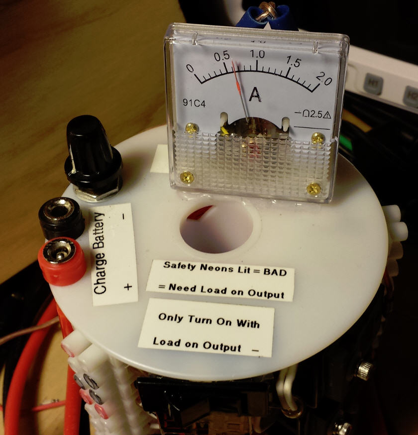

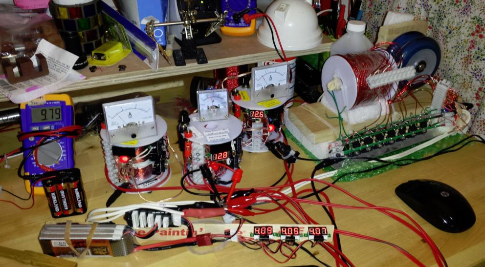

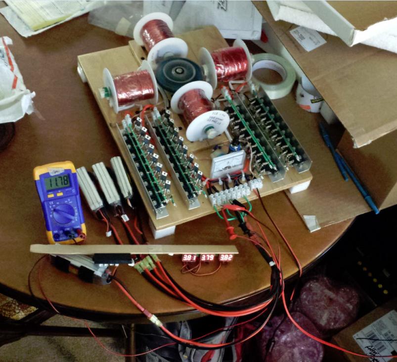

            Not only is paralleling more batteries more efficient, so is paralleling more coils. These are four 11.1V 2200mAh 25C LiPo's charging at once, from way low 11.3V TL to 12.7 overcharged a tad for ultra high speed operation :-) and taking 4.5 hours at draw of 12VDC and 2 Amps.
            When I charge one with one single Coiler same rotored SG, it takes >1.5 to maybe 1.75 hours each LiPo. In 4 Coiler charging 4 LiPos together, 4.5 hours / 4 = 1.125 hours each.

Name:	Rotor and Solid State Ganged - Wards Custom SS Spool Design.jpg
ID:	46710Click image for larger version
Name:	Wards SS SSG Spool Mounted Electronics Design-Top.jpg

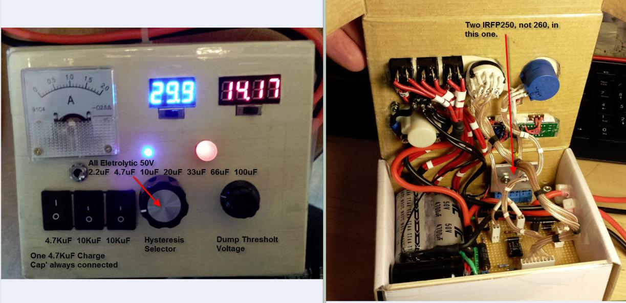

Name:	Wards Op-Amp Cap Dump Inside and Outside.jpg
            Since i found 23 AWG strands run cold at 12VDS, I am thinking next coils should have 16 strands 23 AWG to fill spool and have 16 Trani's. Advise about if 16 Trani spool worth it or not please Tom.

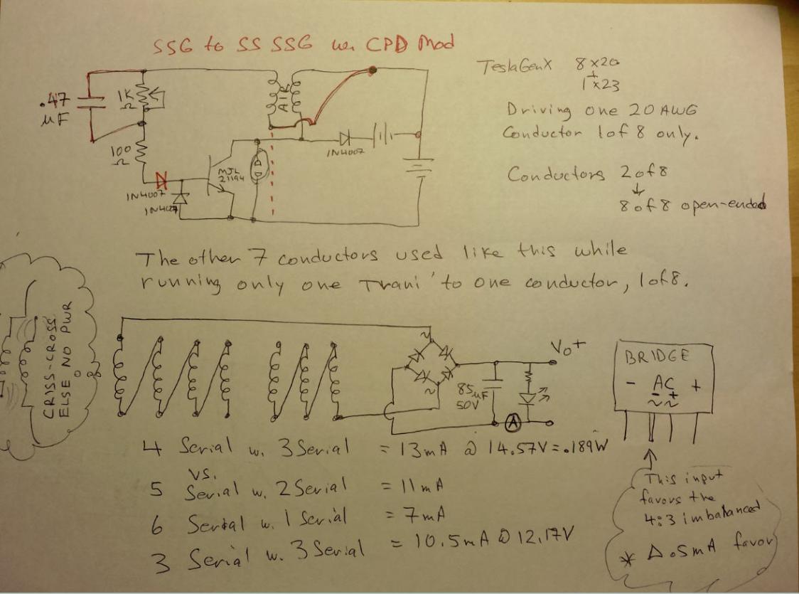

                            Alright you way Sr. guys here like Patrick, Tom and others, about AWG size to Number of Trani-Strands; i say both matter, one matters more, and i contend there is a quiescent point where more trani's/strands pays off, and so does being able to fit that many strands in the spool. The pay off point is limited by how many strands you can fit in the spool before smaller AWG makes heat result. I really like 23 AWG! 23 AWG is 1/2 diameter of the Official Rx of 20 AWG w. 23 AWG Trigger Wire. 23 AWG x 9 runs cold in rotored configuration. It will let 16 Tranis be used as well. Heat? We will see soon.
                            I am not seeing a measurable benefit from large diameter strands or from multiple Litzed strands, paralleled and connected together at ends for more surface area for Skin Effect. Litz Wire has blurb about how frequency Vs. Skin Effect matters; for AC sine waves... We are talking BEMF / electrostatic combo pulses here though, and they seem different rules to me.
                            My very first SG coil was purchased from TeslaGenX, a 20 AWG x8 + 23 AWG x1 Coil. At first, I only had one MJL21194 Trani, and Tom encouraged me to get spinning with it while working on 'perfect'. I discovered some really cool stuff like these notes show, using unused strands open-ended to harvest Amps from nowhere:
Name:	Radiant Harvesting from SG Coils via Open-Ended Criss-Cross to FWBR-lres.jpg
                            I also found that series connecting all the strands by jumpering back to other end of coil and running through it again did not improve wheel speed or speed of charging at all, it just sucked more Amps.
                            Then I explored Skin Effect and tried 8 in parallel Litz, connected together only at ends, with 1 Trani 1 Vs. 8 wire, then 2 Trani's w. 4 strands each, then 1 Trani each wire. etc. I cannot see faster charging of battery or of Cap Dumping rates, based on Skin Area. Not in a single spool with this many Tranis and wire to test with at least. Skin area is small on the Pareto Chart Vs. # Active Strands included. Why Litz'd is not as good as separated and each active-Trani-driven, idk, unless it is not really all about Skin Area.
                            However, I can see right away that adding active strands in parallel in same spool, harvests way larger than the cost of adding those active strands, "Because" the Trani's require less and less energy as they work together in the same spool, yet continue to reap more than they cost somehow.
                            -2 Strand 1 Trani SS SSG (one 26 AWG + 1 29 AWG) - Needs ~ 550mA @ 12VDC
                            -3 Strand 2 Trani SS SSG (two 26 & 1 29 AWG) - Needs 600mA @ 12VDC
                            -5 Strand 4 Trani SS SSG (four 26 & 1 29 AWG) - Needs 700mA @ 12VDC
                            Note SS SSG of 26 AWG run with some warmth, where my 4 Trani max unless bigger wire. Have not tried the 23 AWGx8 in SS SSG yet.
                            The 4 Trani unit is 'more efficient' charging than two 2 Trani units with Outputs ganged together, IF both had same Amp budget. If Amps don't matter, two 2 Trani units with outputs ganged together charge faster than the single 4 Trani unit. You cannot ignore this as it confronts you and you are deciding what to build next, more strands per spool or more spools.
                            You could describe the desire for 16 strands in spool, using 23 AWG so they fit, as a Q-Point thing like i tried to. The Cost Graph Slope for adding Tranis is shallower than the Gain Graph Slope for all those extra bounce backs. The real dynamic here is how much DC you push with the pulses, by using more Base Amps or less, and I call less than normal "Dry pulses", and refrain from using them at all.
                            You can say that the skin area matters, and 'I would not use 23 AWG because it is lesser', but i say that the Skin is not all that the radiant rides in on. I am really needing to try 16 Trani's with 16 strands 23 AWG to see even more!
                            In the DVD, Energy from the Vacuum, JB states "It comes in "As" reactive power". I contend that the radiant we desire rides around the energized wire paths containing Active Reactions involving the BEMF pulses, and not just on Skin Areas of the conductors.
                            So Seniors here, is the BIG AWG for HV / Heat or is it for Skin Area alone really being so significantly greater when >AWG's used and less Trani's then fit???
                            For Rotored Operation, I tried both official 26" bike wheel w. C8's and 4" Razor Scooter wheel and am convinced no difference, as long as these Neos: http://www.ebay.com/itm/141129615927...84.m1497.l2649 Round Counter-sunk Magnets (Double stack at 4 places around a 4" diameter scooter wheel, else won't work, using Brass screws).

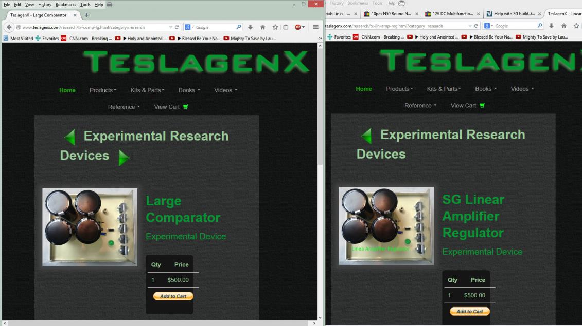

                            • #74
                              tesla chargers and teslagenx both have them, you can order here http://www.teslagenx.com/research/tx...egory=research or from teslachargers.com the linear regulator is like a cap dump comparator and a tracker all in one, takes the spike and turns it into pure DC to run loads or charge batteries.
                              Hey Tom, Check out this error at TeslaGenX site. Error isn't it? Wrong photo of Linear Current Amp?
Name:	New Linear Current Regulator Same Thing as Old Large Comparator - or typo.jpg
                              Which Nityesh shows how to build here:
                              • #75
                                yes thank you it is an Error we are aware of. the correct picture is actually in the website for some reason it is pulling the wrong pic reference from the table. we arer working on the error right now. you will get the right -part if you order v
