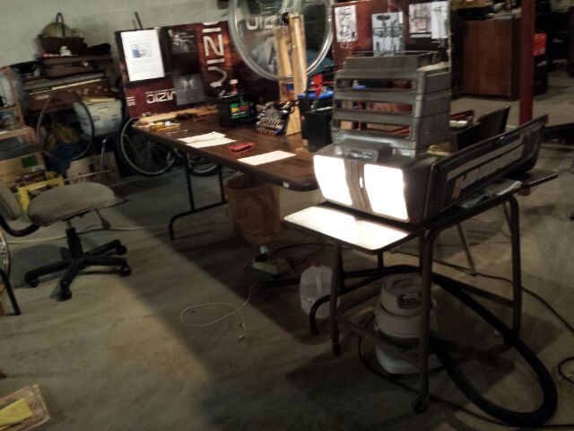

      watch your current draw with headlights, and your cutoff voltage. car batteries are not meant to really be run like a deep cell. that is why they die so fast when you leave a little dome light on overnight. pull enough out to get a voltage drop a bit, then go at it again. I have found just taking a few amps out is all you need.

              you should not have any problems getting those batteries above 15 if the ones in the picture are the ones you are referring to. a fuly charged battery RESTING voltage is 12.8 or so. however that is not what you need to charge to. a commercial battery charger will charge a battery to 14.5 that is considered full, an Energenx charger built by John will charge to 15.3
              a deep cycle battery needs a bigger spike than a lawn tractor battery you may need to retune.
