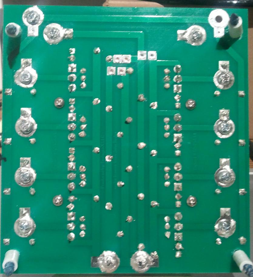

          While I am rebuilding using some ABS plastic and wood, I am posting a pic of the back of my circuit board as requested.
Name:	Back Board.jpg
          • #20
            another assumption is that your magnets are all north out... switching the coil trigger wire locations will tell you.....
            thanks for the picture, everything looks great.

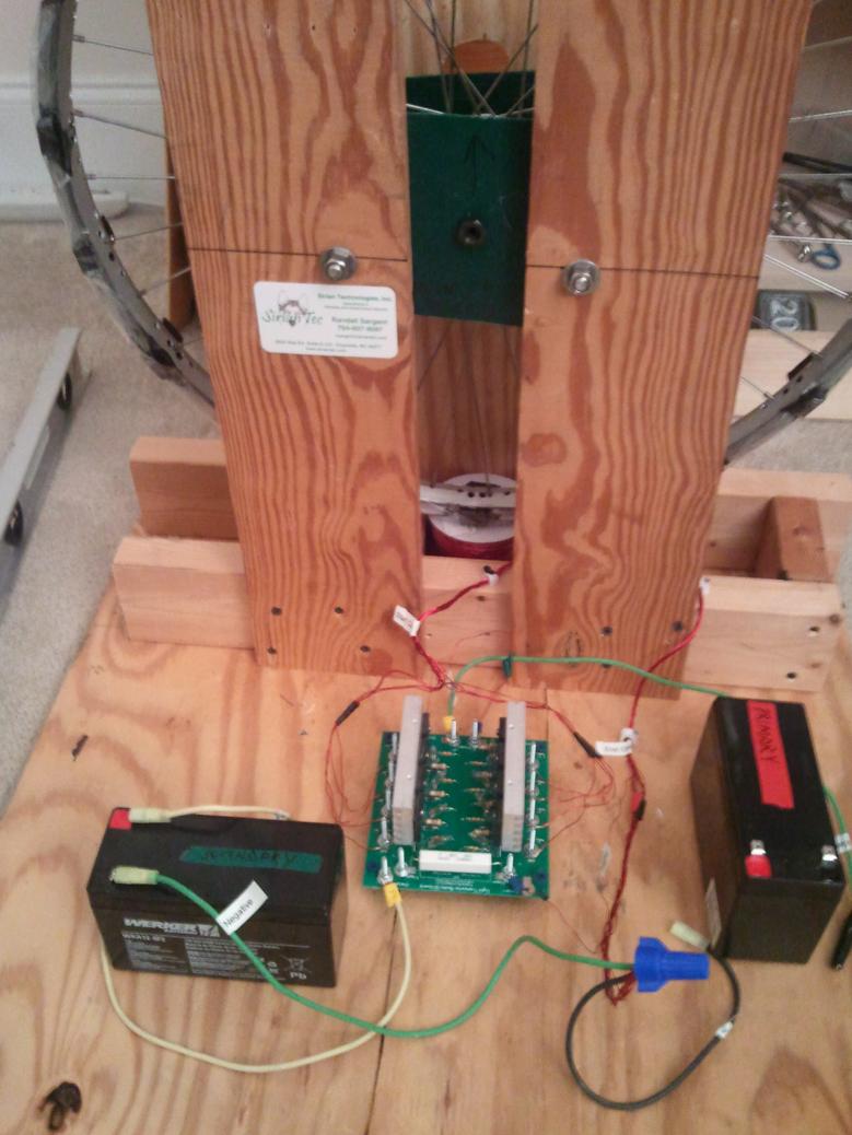

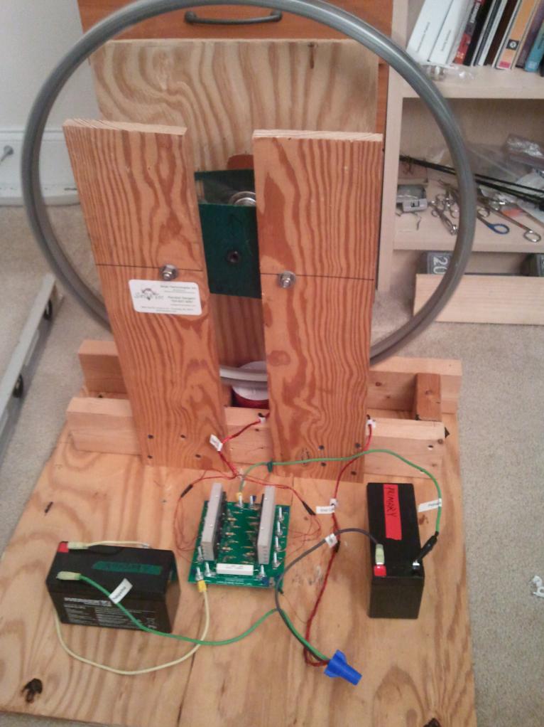

                It's Alive! Got it all rebuilt without the metal supports and some other enhancements and it is up and running.
                Gave the wheel a whirl and it spun up so fast I had to slow it down to keep the magnets secure. I did notice the LEDs did not fire up though.
                Here are my changes:
                1. Built upright supports out of wood instead of metal.
                2. Used ABS plastic to hold wheel to uprights - slotted to make it adjustable.
                3. Shortened rods to be about the same size as the coil mounted on solid wood with no hole under it.
                4. Also made sure the coil was mounted perfectly level.
                5. Cleaned up wiring a little.
                6. Cleaned up all the notches on my wheel where magnets mount to insure they are the same depth to keep gap from coil consistent.
                7. Lined all notches in wheel where magnets mount with Liquid Tape. I also put a couple pieces of black electrical tape on back side (south) of magnets. It is an aluminum wheel but I wanted to insure there was no electrical interference.
                Now I gotta play with it a little. Thanks for everybody's input.
                Here are a couple of pics:
Name:	Running First Time 2.jpg
                This is it running (above)
Name:	First Good Build2 1-21-14.jpg
                Here is is stationary
