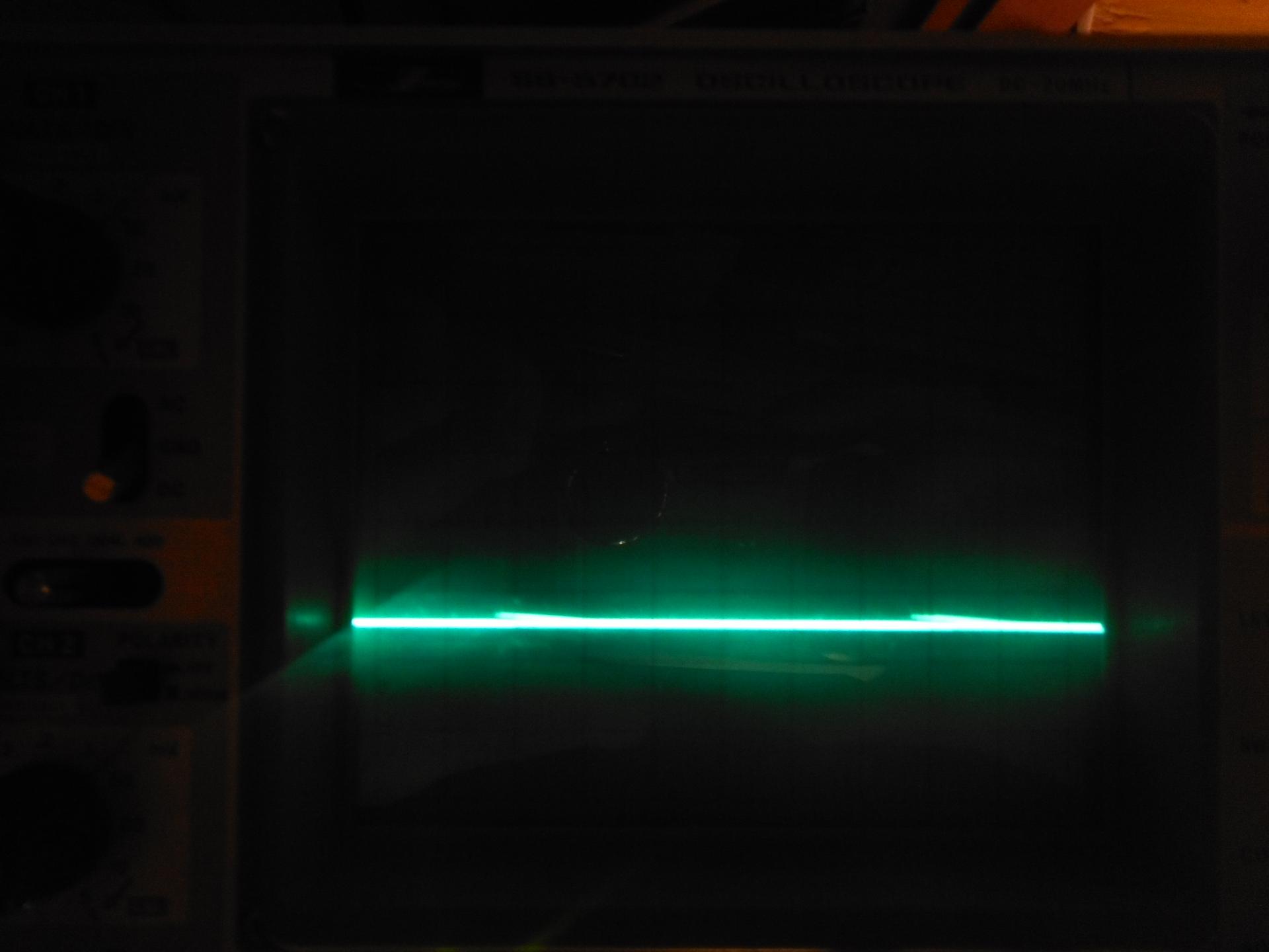

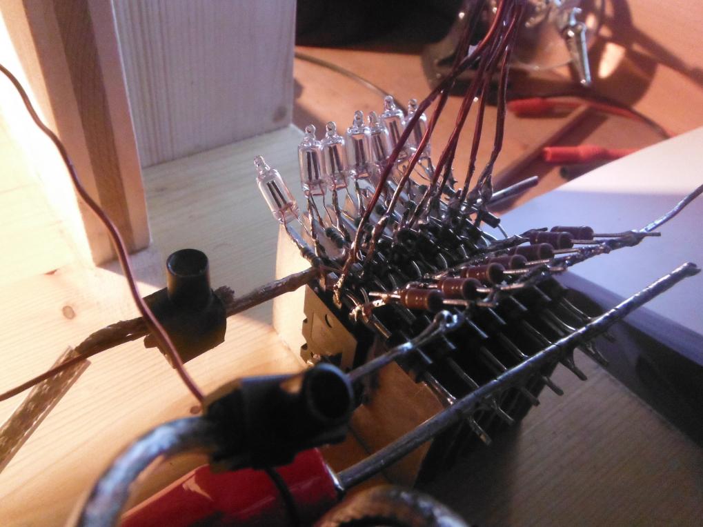

    Hi to all,
    here is my setup in superpol-configuration.
    Coil is 8 filiar 18 AWG 1.2 ohm each strand,18mm core
    7 MJL21194,7 1N5401,7 1N4007,7 470 ohm base,potentiometer adjusted to about 20 ohm,
    155 [email protected] amp attraction mode,
    My problem is that my h-wave is not correct and i dont know where the mistake is,i am not very familiar with electronics,but on the scope you can see that when the transistor switches on it goes to the wrong direction,it looks like AC.
    I hope somebody knows why this is.
    Thanks[ATTACH=CONFIG]1309[/ATTACH][ATTACH=CONFIG]1310[/ATTACH]
    There is a voltage spike where the Transistor switches of,of 50 volts(hardly to see)
    I forgot to mention,the rimm is 56 cm and has 16 magnets scalar north,the magnetsize is 60mm x 20 x 13.7 they are Y35 magnetized thats C8/C(nearly),the gap is 8mm,if i put them closer than the transistor switches twice.

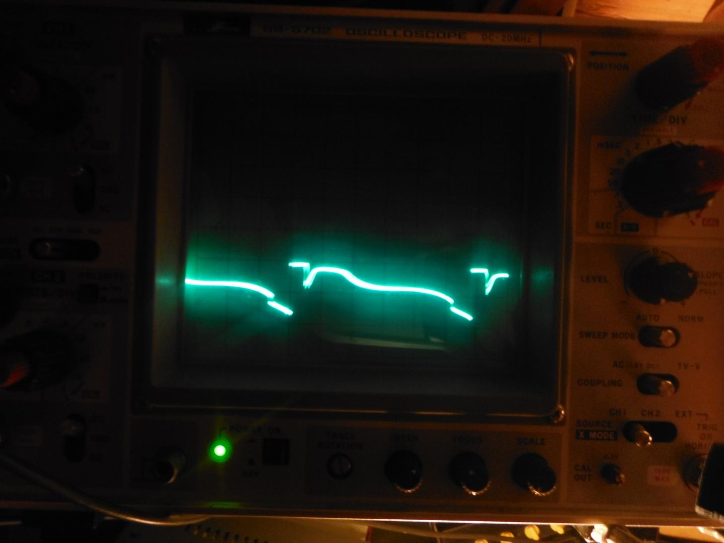

          I have insulators between transistors and heatsink(mica+the white mass),my probe was atached on C directly on the transistor and on E.
          When i attached it after the diode and on -CH i get only straight very small spikes you cant see them on a photo.
          I try to make a good picture.

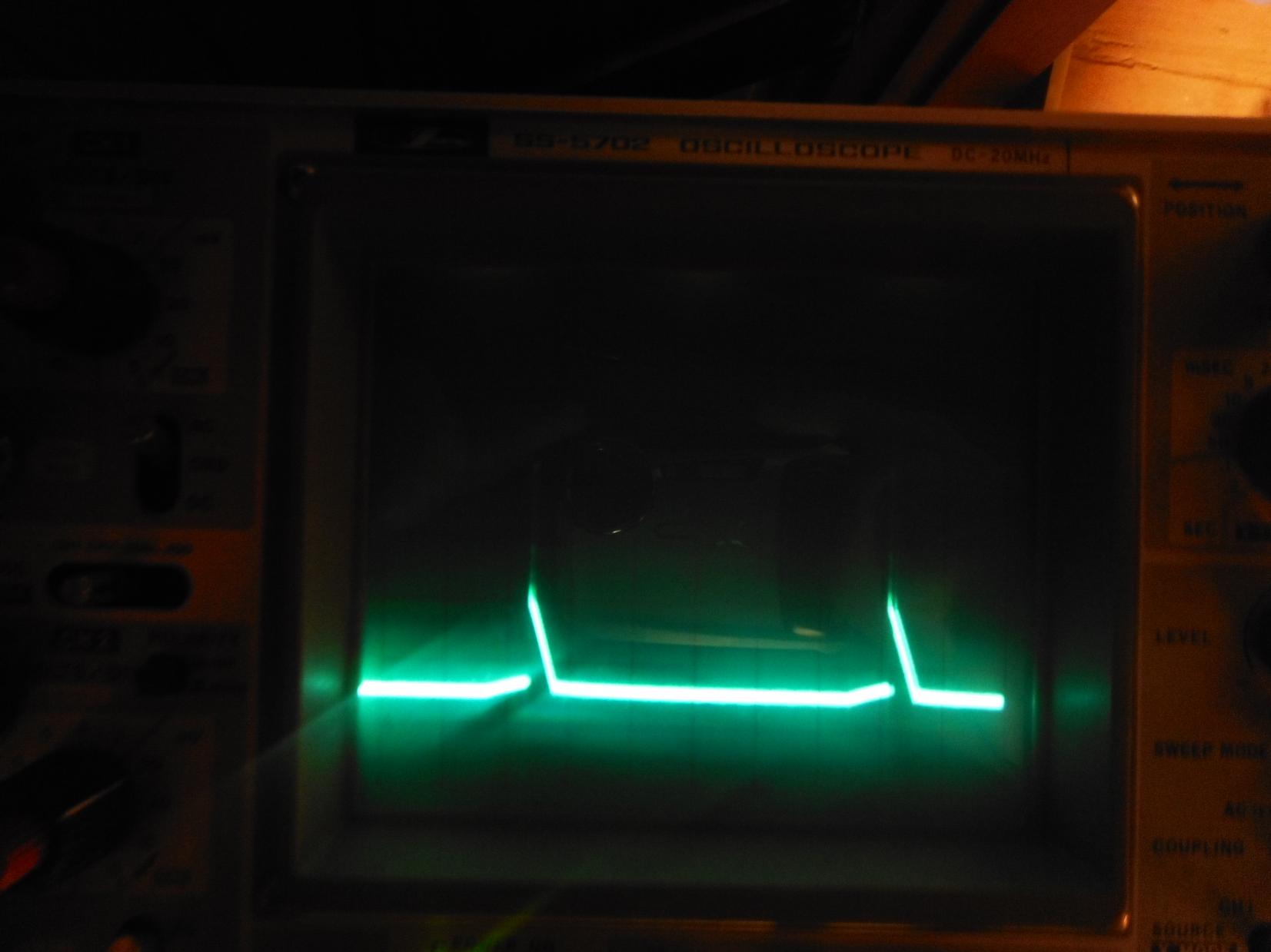

            Here are 2 pictures but the quality is not good i did my best,but there must be something wrong.When i hook up a cap on the charging side it charges up to 510 volt in 2 sec.I have measured the diodes and they look good.I have new batteries wich means not conditioned.Maybe i dont know how to adjust the scope right.I have tried with a coil with only 2 wires but the wave looks the same.Click image for larger version

                Maybe it has something to do because my circuit is not on a board,i have soldered it so short icould make it.Here is a picture,maybe somebody can see something what i have made wrong.
                ThanksClick image for larger version

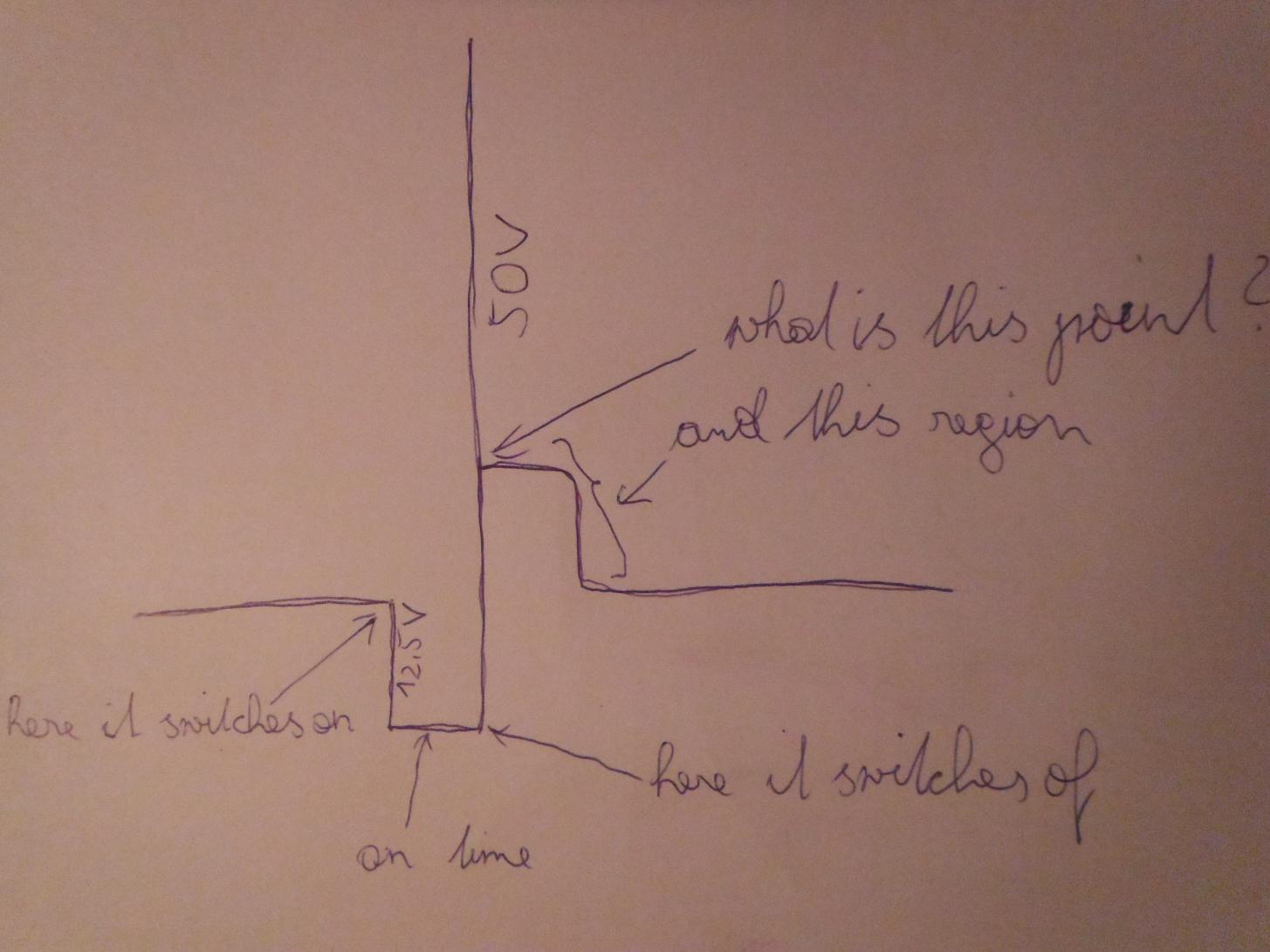

                      • Here is a drawing,maybe somebody can describe it.The problem is where the transistor switches on,where 12.5v stands,this should go up in the other direction.This wave form is from C and E direct on the transistor.

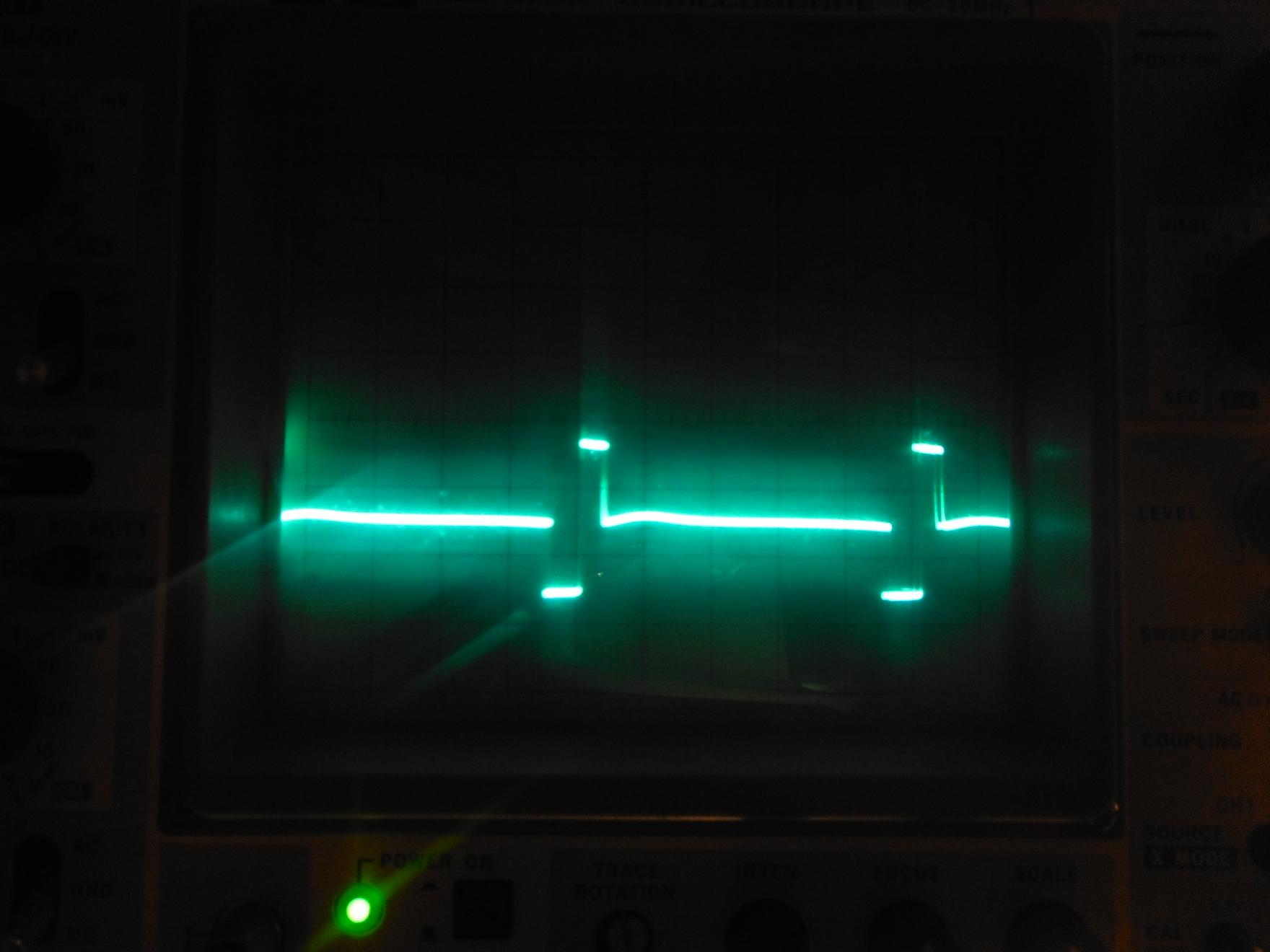

                        • Hi onesmore,
                          here are more pictures.Click image for larger version

                              There is no currentflow,i am not sure but the first picture above,C after diode and CH-,could be what im looking for,i hope John K.or Tom C. say the same.

                                Looking at your hand drawing I see the h wave etc. fine but your scope shot is different. Until they can get here and help you out better, I googled "Bedini H wave" and found this page. Darcy Klyne's Bedini Monopole Motor Replication
                                If you look at the blue wave shape you will see what your looking for. Hope this will be more clear for you....
