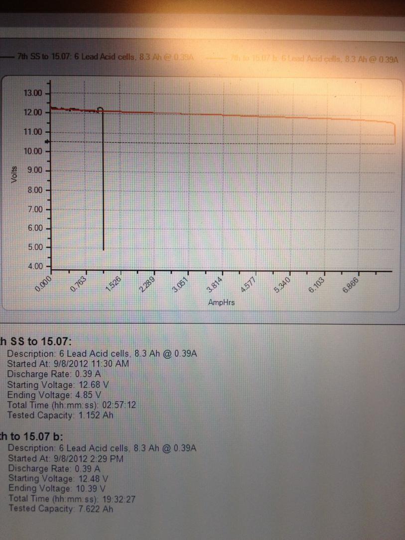

John,
I replaced the fuse and still seem to have gotten a lot out of this battery. I've been calculating that it's 8.25 AH because it's listed as 165 CCA. I had to do the load test in two parts because the leads were knocked lose and the CBA stopped the load test when that happened. But the two load tests were for 1.152AH and 7.622AH for a total of 8.774AH. It is a conditioned battery. It's the one I did my more than 30 runs on with the bike wheel. I've got a curve that falls rapidly and then levels off for a gradual decline and then falls again precipitously at the end. I've never take the battery down to 10.5v before, but thought I'd give it a try after watching your video. I had stopped all my previous testing at 12.v. Can't print the curve but I'm trying to find a way to get it to this machine. In the meantime, am I deluding myself? Is this too good and still probably a problem with the CBA?
thanks,
h
