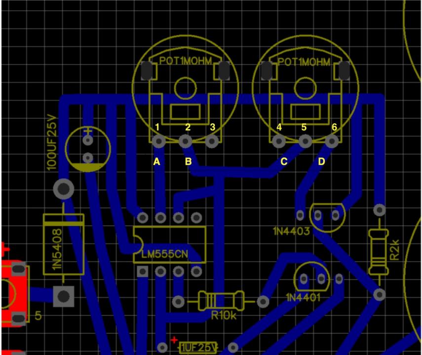

Hi,
Go back to your caps in a sq arrangement with all the
TOxxxx parts in a row so they fit on a single heat sink like you had it.
Make fat traces on the bottom on both sides of the Mosfets.
Arrange the voltage divider resistors to have that connection as close to the Gate as possible, that means using the resistor to jump over a Fat trace, or onto a Fat trace, and keeping all traces on the bottom side....
Spread out the mosfets, (1in centers) and make that connection trace between the mosfets in a straight line to the gate.
keep the resistors up off the PCB 1/8in or so when soldering them in
In general, arrange all components, to keep all traces as short as possible through out the circuit...
Make sure you have enough room for mounting holes in the corners.
