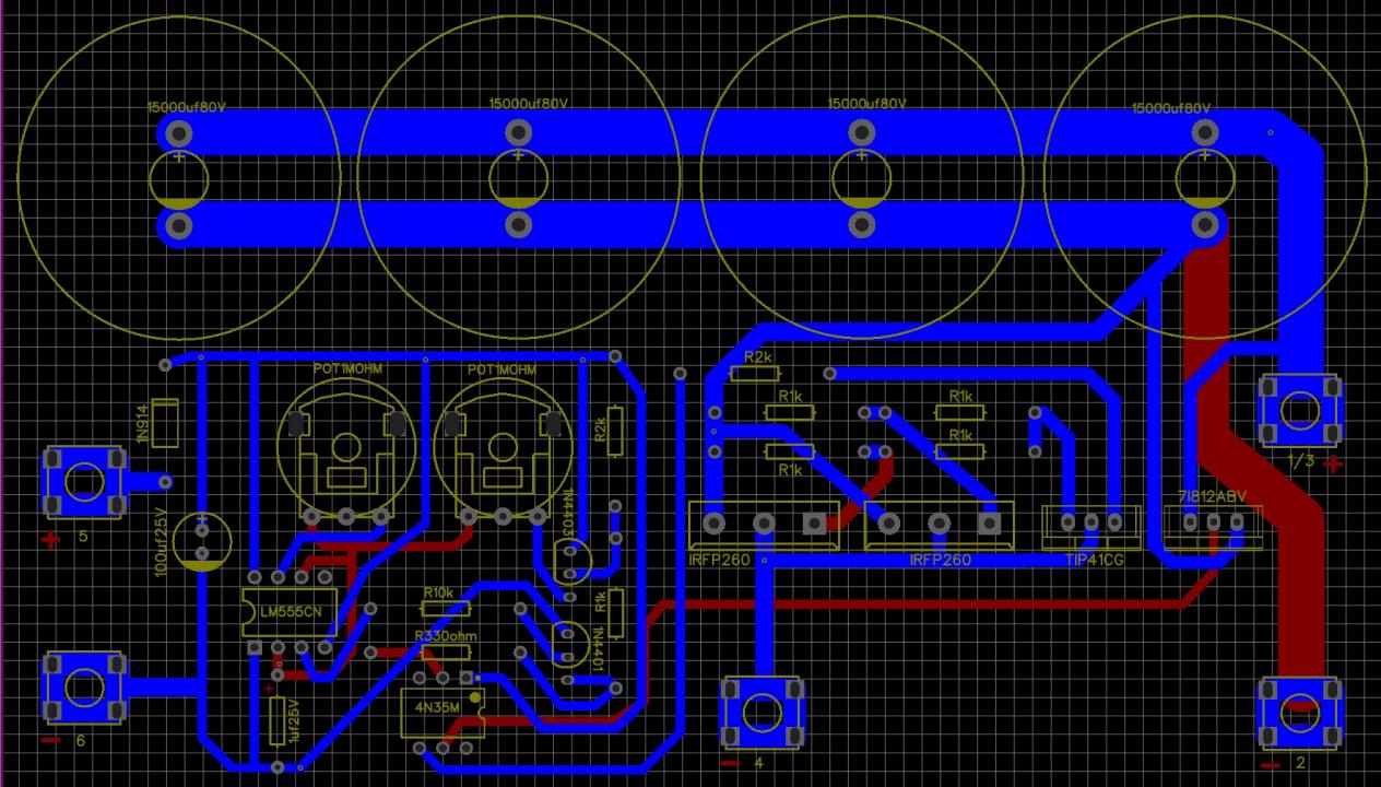

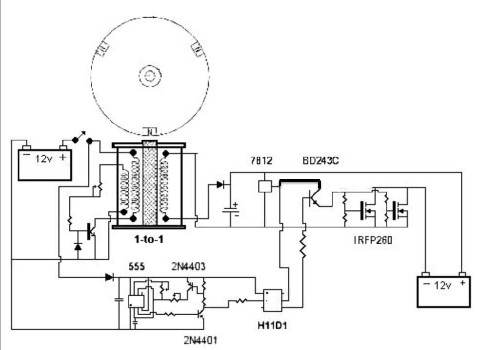

All I remember is that it didn't deliver a very high discharge voltage across the charge battery and with only two Mosfets it blew them both out after awhile. I tore it all apart after that so can't go back and look at it now.
