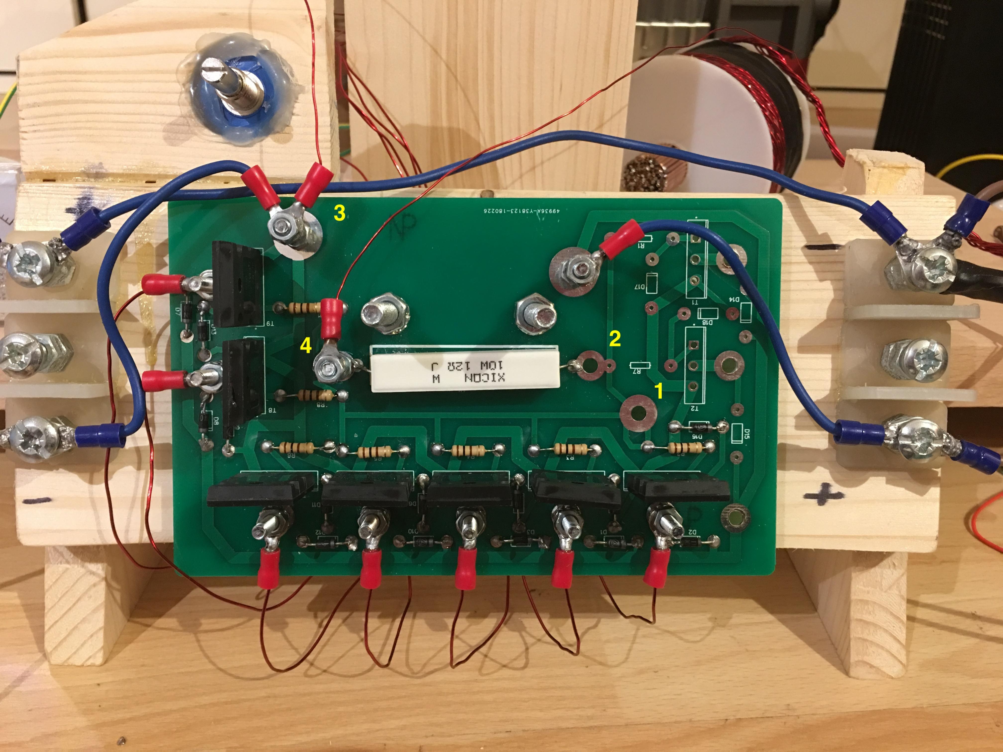

Hi,Originally posted by claudio View PostHi Yoe777 and Tom,
still not clear to me where to put the pot... here a pic of mine, could you explain where exactly put the pot ? From where to where...
I put numbers to make it easier to explain.
please help
thank you
[ATTACH=CONFIG]6848[/ATTACH]
Remove the 12 Ohm resistor and put the Potentiometer there...
Claudio - in your picture the adjustable pot goes between terminals 2 and 4 replacing the 12 ohm resistor.Originally posted by claudio View PostHi Yoe777 and Tom,
please help
thank you
[ATTACH=CONFIG]6848[/ATTACH]Yaro
Originally posted by claudio View PostThank you guys, will try and post the results !
I would leave the resistor - remove the trigger coil lead from 4 - place a pot between the trigger coil lead and terminal 4 of the 12 ohm resistor. make it a nice beefy POT. It's ok if you already did what they say worse case you burn the pot and run the circuit on the individual base resistors, I hope...

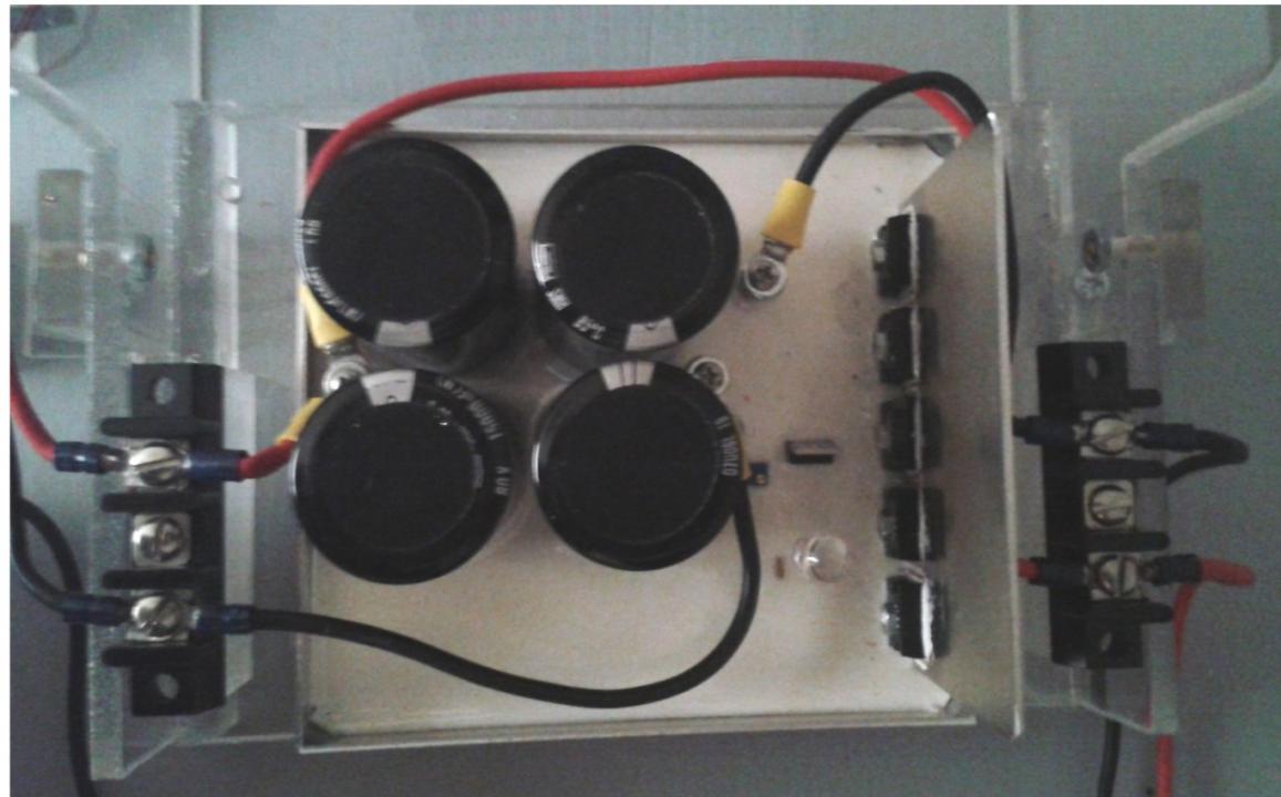

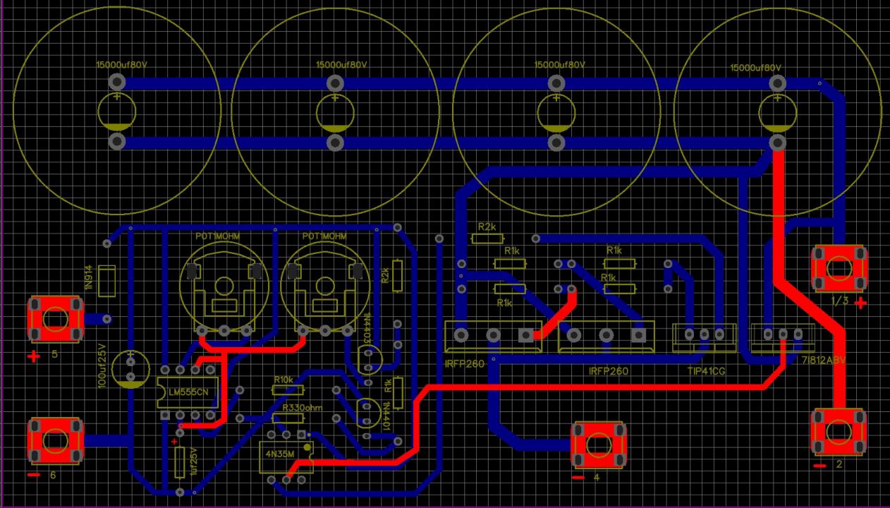

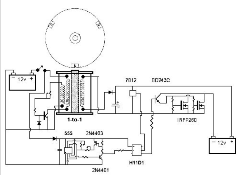

If you have time I would appreciate very much if you could take a look at my project of the capacitors PCB as showed on the second book, are there any mistakes or ways to improve it ?
regards
cla
Hi Cla,Originally posted by claudio View PostHi Faraday88,
my machine is a "Bike Wheel" Type with 21 magnets and about 63.5cm wheel diameter. One 7wire coil ordered from teslagenx site.
it is turning at 260 rpm and charging easily 45mha batteries, input is about 1,8amps (1 ammeter installed, waiting for the second one ordered).
I am still waiting ordered parts to improve the efficiency.
I am having so much fun building it !
regards
cla
[ATTACH=CONFIG]6864[/ATTACH]
[ATTACH=CONFIG]6863[/ATTACH]
Im more than happy to help you.. just some of my pointers:
Read all the three books up close..it talks about the various experiments the JB did and what he found from them! in the intermediate book it talks about ''exploring'' pulsing the Cap at both the terminals..how do you think that can be affected? the diagram shown is half baked to help you understand the process..watch the pat# 6,545,444 you will get it i guess.It is called the full patent.(ask why?) Tom C calls it 'Ringing the bell twice'' I call it ''Space Switching'' it is the same thing happening in JB's 1984 single battery Motor-Energiser.. hope you get it..
more as you learn and progress...
Best Regards,
Faraday88.Last edited by Faraday88; 05-01-2018, 11:35 AM.'Wisdom comes from living out of the knowledge.'
how is that pulsing at both terminals?Originally posted by Faraday88 View PostHi Cla,
Best Regards,
and
No, what you and Tom are talking about is not the same thing and surely not what JB meant by ringing the bell twice. However, if you think it is, please expand more descriptive rather than encrypted.

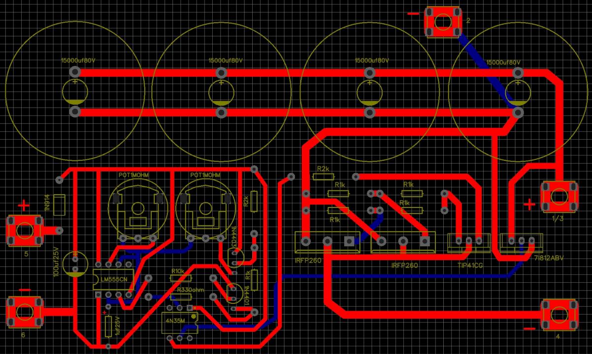

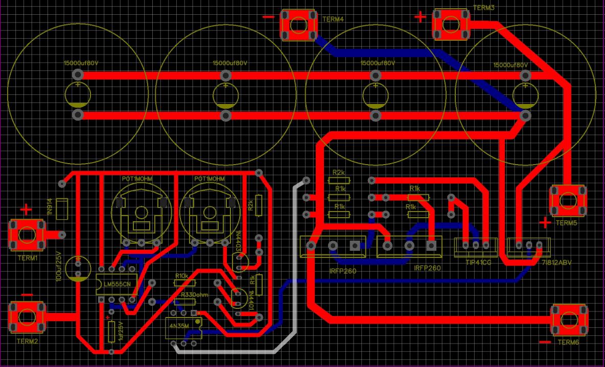

Hi guys,
My Bike wheel is up and running fine and I want to improve it.
I am just trying to make it as simple as possible.
I am trying to develop a working PCB to mount all the electronic parts for the capacitor module and continue to experiment, I am not a technician.
The PCB for the "basic" machine was pretty easy to do, this one is more tricky.
I have all the parts needed, now I just I need some help to avoid mistakes before sending the PCB to manufacturing..
min2oly
right! One pulsing terminal,corrected,do you see any other mistakes ?
There are so many terminals (the real module from JB has only 3 terminals) and i am not 100% sure the transistors, timer etc. are correctly connected..
thank you and best regards
updated PCB
