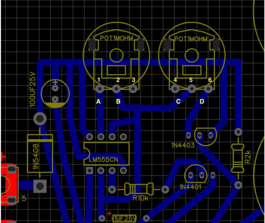

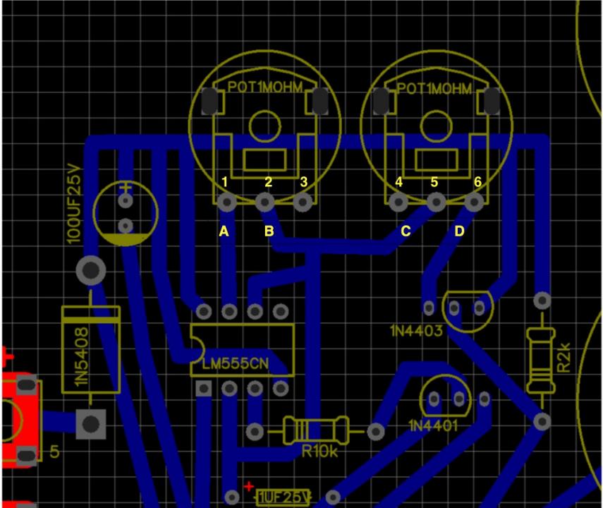

                      Hi RS_,
                      I hope I get your indications correctly...
                      please quickly check the connections, spacing rearrangement must be done...
                      1. can I connect to the CAPS N.1/3 pad and N.2 pad like this ?
                      2. pots connections are ok now? My drawing followed the EasyEda software indication...
                      3. routing around 555 ok ?
                      4. pad 6: do not see how to put it on the edge on the same PCB route side...
                      5. I found this 3A diode https://www.mouser.it/ProductDetail/...ZlhM6bLg%3d%3d
                      6. will adjust holes, pads and spacing after I am sure the connections are ok, just to save time...
                      If connections are ok then everything is on one side !
                      again... thanks for your patience
                      PCB_PCB4Mofinv4TRIS_20180517113236.pdf
                      • #56
                        That looks ok, I would move the 1/3 pad to in between the caps where the 2 pad is. Move the 2 pad over close to the 4 pad by the PCB hole, shift the whole thing up and move the PCB hole to the corner. Rotate the Caps and traces 90deg to the right for better shorter connections to the Screw pads, and to the Source fat trace.
                        The long trace from the 1/3 pad would be better coming from the lowest cap close to the 7812.

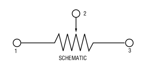

                        On the Pots, if you have the pot you are going to use, measure the resistance to see which of the 3 leads is the adjustable wiper, and then design the PCB to match that.....
                        Make sure the pot Component pads are in the correct spacing/location for the pot you are going to use.
                        I would move the 555 timer as close to the opto as you can, about where the 6 Screw pads is now, and then design all the other parts around that location with as short of traces as possible...
                        A rearrangement should allow you to have both pads along the edge
                        A size bigger Cap Component pads spacing will help too.
                        will work, but i would buy 1N5408 part number so you can also use them as SSG output diodes too....
                        OK

                          Hi RS_
                          2. Pots section..
                          the pots spacing/holes fit perfectly for the pots I got (mouser 652-PDB12-M4251105BF)
                          this is the scheme of the pots
                          please tell me how should I connect them, I put numbers and letters ...
                          rearranged PCB following indications... routing and spacing still to manage..
                          PCB_PCB4Mofinv4TRIS_20180519092849.pdf
                          ordering the 1N5408 Diodes.
                          regards
                          • #58
                            pot pins 1 and 2, and that looks like what you have now.....
                            your cap and trace rearrangement looks real good
                            • #59
                              Now I have 1A, 2B, 5C, 6D. Is that the correct one ?
                              Just to be sure...
                              PCB updated ...
                              will re-check connections and holes
                              will try the circuit on bread board first...
                              pots section ok ?
                              PCB_PCB4Mofinv4TRIS_20180520111403.pdf
                              • #60
                                If you hook the right pot up like that, it will operate backward from the other pot
