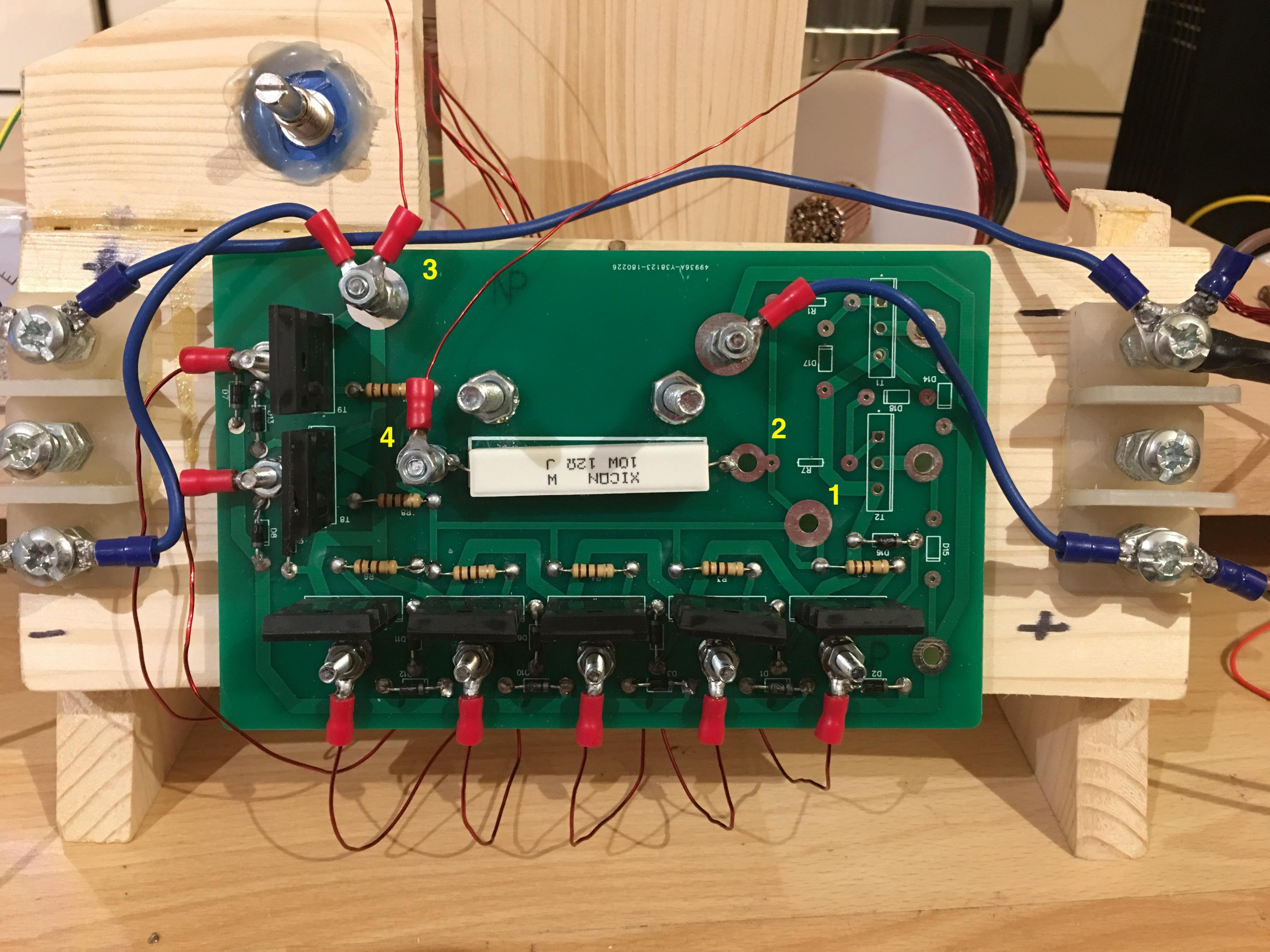

    I understand for to tune the SG8 that you need to replace the 470 ohm base resistors with 100 ohm base resistors. On what area would I place the pot on the SG8? Here is a pic of mine:

    place the potentiometer in the spot where the 12 ohm resistor is.

      still not clear to me where to put the pot... here a pic of mine, could you explain where exactly put the pot ? From where to where...
      I put numbers to make it easier to explain.
      please help
      thank you

        Remove the 12 Ohm resistor and put the Potentiometer there...

          Claudio - in your picture the adjustable pot goes between terminals 2 and 4 replacing the 12 ohm resistor.

              I would leave the resistor - remove the trigger coil lead from 4 - place a pot between the trigger coil lead and terminal 4 of the 12 ohm resistor. make it a nice beefy POT. It's ok if you already did what they say worse case you burn the pot and run the circuit on the individual base resistors, I hope...

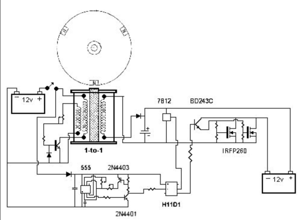

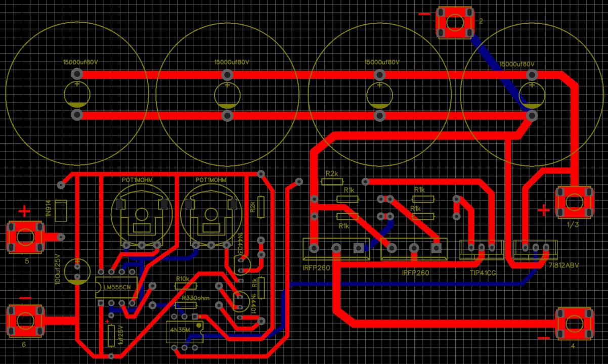

                        If you have time I would appreciate very much if you could take a look at my project of the capacitors PCB as showed on the second book, are there any mistakes or ways to improve it ?
                        regards

                          Hi Cla,
                          Im more than happy to help you.. just some of my pointers:
                          Read all the three books up close..it talks about the various experiments the JB did and what he found from them! in the intermediate book it talks about ''exploring'' pulsing the Cap at both the terminals..how do you think that can be affected? the diagram shown is half baked to help you understand the process..watch the pat# 6,545,444 you will get it i guess.It is called the full patent.(ask why?) Tom C calls it 'Ringing the bell twice'' I call it ''Space Switching'' it is the same thing happening in JB's 1984 single battery Motor-Energiser.. hope you get it..
                          more as you learn and progress...

                            how is that pulsing at both terminals?
                            and
                            No, what you and Tom are talking about is not the same thing and surely not what JB meant by ringing the bell twice. However, if you think it is, please expand more descriptive rather than encrypted.

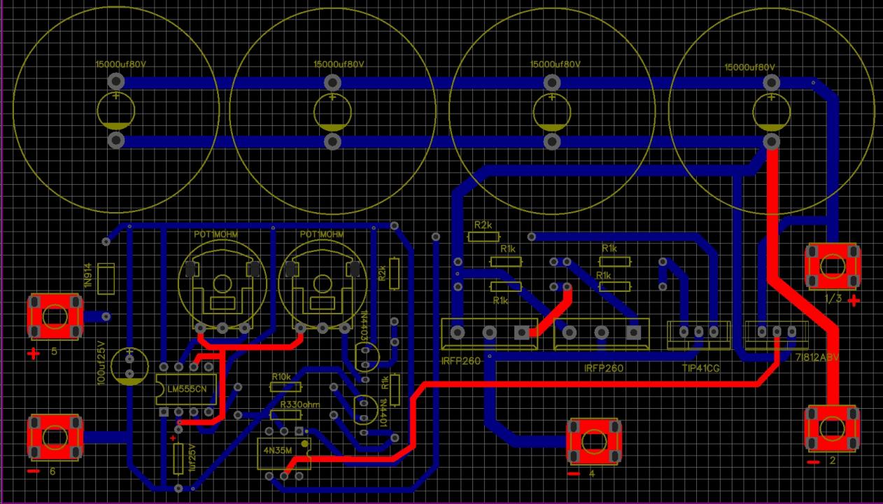

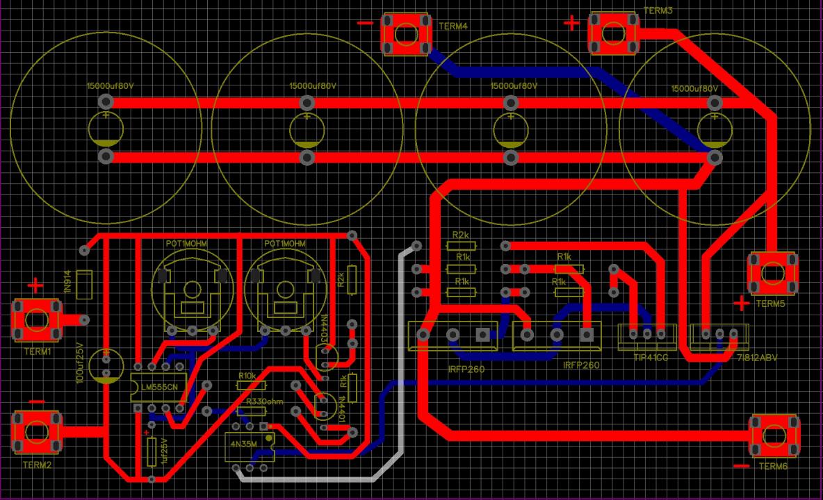

                              Hi guys,
                              My Bike wheel is up and running fine and I want to improve it.
                              I am just trying to make it as simple as possible.
                              I am trying to develop a working PCB to mount all the electronic parts for the capacitor module and continue to experiment, I am not a technician.
                              The PCB for the "basic" machine was pretty easy to do, this one is more tricky.
                              I have all the parts needed, now I just I need some help to avoid mistakes before sending the PCB to manufacturing..

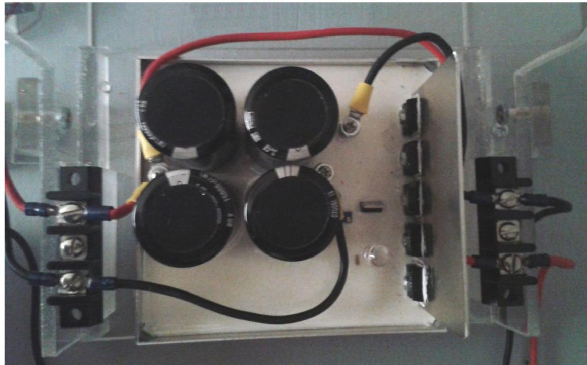

                              min2oly
                              right! One pulsing terminal,corrected,do you see any other mistakes ?
                              There are so many terminals (the real module from JB has only 3 terminals) and i am not 100% sure the transistors, timer etc. are correctly connected..
                              thank you and best regards
                              updated PCB
