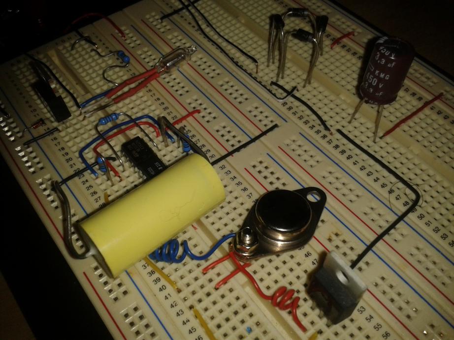

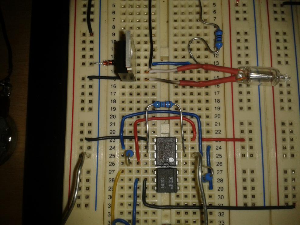

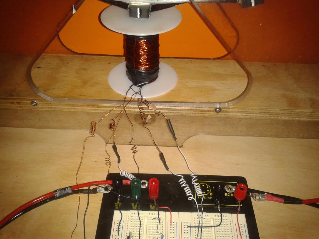

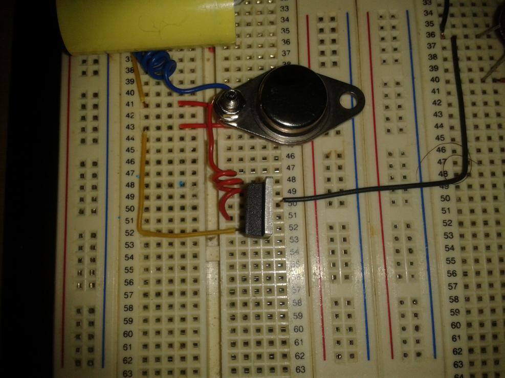

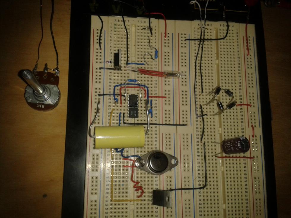

                            Did that and i still have my neon lighting up it's hooked up across the C&E I have loaded some photosClick image for larger version

                              Hi George,
                              Time to solder your circuit up methinks. Usually if the neon lights up there is a problem with the output path, i.e. there is no battery connected or in this case, no capacitor. You seem to have the cap and bridge on your prototype board but I would review the connections of that area. Happy to give you a hand to solder up something more permanent and get rid of all the excess lengths which dont help much. But basically, if your cap is filling nicely you should be alright.
                              What happens if you remove the capacitor and connect a battery straight to the terminals of the bridge? Does that stop the neon?
