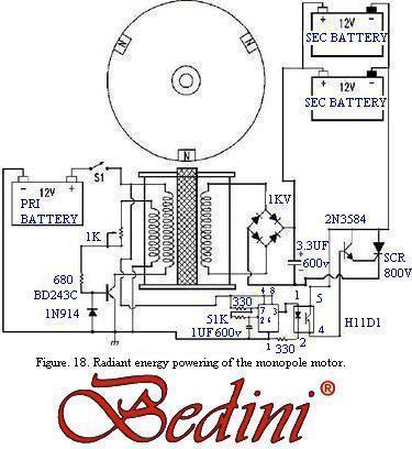

    Here is the circuit of the Bedini SSG Monopole with Capacitor Discharge.

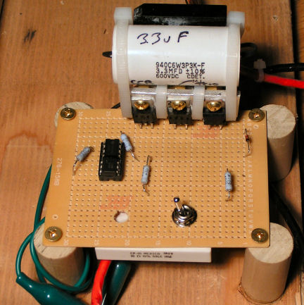

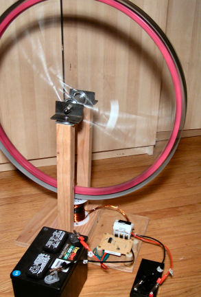

            I built one of the capacitive discharge monopoles according to the circuit posted on this thread. I tried to get everything as close as I could to the original specs. The exceptions were I couldn't find a 2N3584 transistor so substituted with an MJE15032. For the base resistor I had to remove the 680 ohm one and ended up at 20 ohms for best tuning.
            I used a 26" bike wheel for the rotor with 18 magnets in standard arrangement. The coils is a non-litzed 3 filar, all 18 gauge 130' long. Here are a couple of pics:
Name:	Cap discharge monopole.jpg

Name:	Board for cap discharge.jpg
            This hot pink girl runs at 254 rpms, is drawing 1.26 amps from the primary and is charging .253 into the charge battery. I charged up a 3.5 ah sla battery in about 6 hours just to see what it would do, and I'll next try a lawn and garden battery to see if it's close to the c20 rating, which I expect it should be given the results from the 3.5 ah battery.

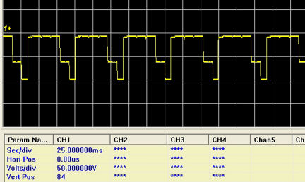

            I then took a 560uf cap and put it in parallel with the 3.3uf and then I started to see more what I expected:
Name:	Probe on cathode gr on ch neg with 560 cap.jpg

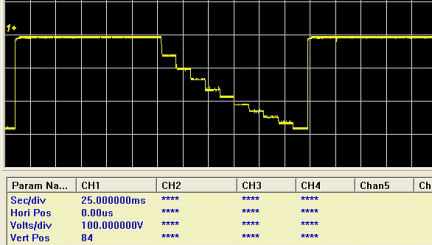

            I think at this point I started to see some fluctuations on the panel meter. Another difference between my rcharge kit and this build is that the resistor on this build that times the intervals between pulses is 51k, and on the rcharge kit it's a pot that goes up to 2M.
            The higher the resistance for that resistor means the longer it takes for the timer to fire the opto. This means the cap is charged for a longer amount of time, and charges to a higher voltage before discharging. You can see this in the next wave where I increased the timing resistor from 51k to 271k and had the 560uf cap in parallel:
Name:	271k resistor with 560 cap.jpg
            So what I've got now is stair step charging. Cool. What is happening in this wave is the coil is getting 10 magnet passes before the cap discharges, and you can see the 10 steps in the wave where the cap is being charged. Each pulse from the coil charges the cap a little higher. Really cool. At this point I'm also getting much larger and slower fluctuations in the panel meter and everything is looking ok.
            What I'd learned, and am passing on to anyone that is building this for the first time, is that the 3.3uf cap is small and the 51k resistor is fast, so you get a lot of quick, relatively low voltage discharges from the cap that won't show up on the panel meter or a digital meter, and yet the cap is discharging like it should. If you're not sure your build is discharging like it should, then you can increase the timing resistor and cap size like I did and see the cap discharging on a panel meter for visual verification.
            This is a fun little circuit to build and a good intro to the discharging the cap part of the technology. It's also a good basic system for experimenting with changing the timing resistor and size of the cap, so you can learn what the effects will be on the charging battery.
                [ATTACH=CONFIG]15[/ATTACH]
                I want to make a solid state version of this. One question though.
                Isn't there a spike on the primary coil? What protects the transistor on the primary coil?

                      Hi bluestix,
                      My knowledge of electronics is pretty minimal, but let me see what I can do. In an ssg circuit both sides are connected electrically, which is not the case with this circuit. That's the beauty of the opto; it can connect the 2 circuits so the one can affect the other, but it doesn't use an electrical connection between the 2 circuits. The danger with the ssg is that if the charging battery gets disconnected, then when the field collapses the spike can't get to the charging battery so the voltage builds up, and since there is a circuit to the primary battery through the transistor, the voltage will build up enough to punch through the transistor to get to the primary.
                      So with this circuit if the charging battery gets disconnected it doesn't really change anything on the primary side, at least as far as I can tell, since they are not electrically connected. I think if the secondary is disconnected the timer will continue to fire the opto like normal, but without a closed circuit to the charging battery nothing will happen on the charging side. And of course if a clip comes off the primary then the machine just stops, so no danger there.
                      Robert

                            I still don't see how the primary coil on the SG is any different then the primary coils on an SSG. If a spike forms in the primary coil of an SSG circuit then the spike has to be discharged to a battery to prevent damage to the neon and transistor.
                            What is different about the primary of the SG that it isn't at risk of damage from the spike? Is it dissipated through the secondary?

                              Originally posted by Robert Darrah View Post
                              Hi bluestix,
                              Robert
                              In the posted diagram I am not concerned with any of the secondary charging circuit. Only the primary coil and transistor connected to the primary battery. In an SSG circuit this would be the coil developing the spike and routing it to a secondary battery. I don't understand what is different about the primary coil of the SG circuit. Does it not develop a spike?
