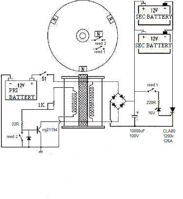

    I've had good success using a heavy duty SCR and one zener diode. The sch is below. All I do to adjust the voltage is swap out the zener for a different value. Right now I have a 16V zener on there. So 16V + about 2V that the SCR requires and that's roughly 18 volts over the battery voltage. I felt that this was better than using a 12 V zener because I wanted the battery to always have at a minimum of double the voltage hitting it. When the battery gets up to 15.5V, that's more than the 12V zener would produce on this circuit. I've never blown out one of either of the SCR's shown below either.
    Schematic:
    [ATTACH=CONFIG]1711[/ATTACH]
    A couple different SCR's I've used. The larger one is a 2N1913 and the smaller one says R16RIA60 on it. Found these at my local surplus store. Skycraft Parts & Surplus, Inc.
    [ATTACH=CONFIG]1712[/ATTACH]
    -Chris
    Chris, that nice. I'm glad it's working for your setup.
    I have that same SCR. The only thing I've added was an LED from cathode to zener to gate.
    Still... when I've moved to larger setups w/ large battery banks - this one is too small and heats up and/or locks up.
    Everyone should try it, it is very reliable w/ the right energizer and charge battery.
    The drawing in my vid is wrong, but the close up of the actual SCR is easy to see and connected and operating correctly.
    Chris has the correct drawing here.
    -KR

      I have been playing with a high current SCR to see what you can do with it.
      I was also using a zener over the scr and it nicely dumped around 23 V over my battery.
      As long as it completely discharges the cap it works fine but when there is a little higher
      voltage over the cap than the batt the SCR stays on. This means that you have to shutdown
      the input over the cap from the SSG completely. I think the easy way is to short the base of your
      SSG Transistors, or in fact the triger coil somehow at the moment the SCR fires.
      What I also found is that the cap is leaking over the SCR Gate so you don't want this on all the time
      so maybe you want to use a timer like 555 to sample the voltage every second or so and then dump
      when voltage is high enough.
      Just some thoughts,
      Karel

      • #18
        -KR
        Patrick
        Thanks Patrick. It works almost flawlessly for my actual setup. I did have an issue with too much capacitance one time when my battery got almost full. The SCR would not close again for a few seconds on each pulse. It was strange, it was like a delay before it would re-charge. Lowering the capacitance solved it.
        This is a small 3 filer machine. I am in the process of building a larger machine so it's good to know that I need to keep thinking about cap dumps then. I am really tempted to try the full 555 with mosfets circuit. However it is so complicated when compared to this SCR dump or some of the other simple ones. I also don't like how I would have to basically manually adjust it for each load.
        Still searching for that ultimate cap dump.....
        -Chris

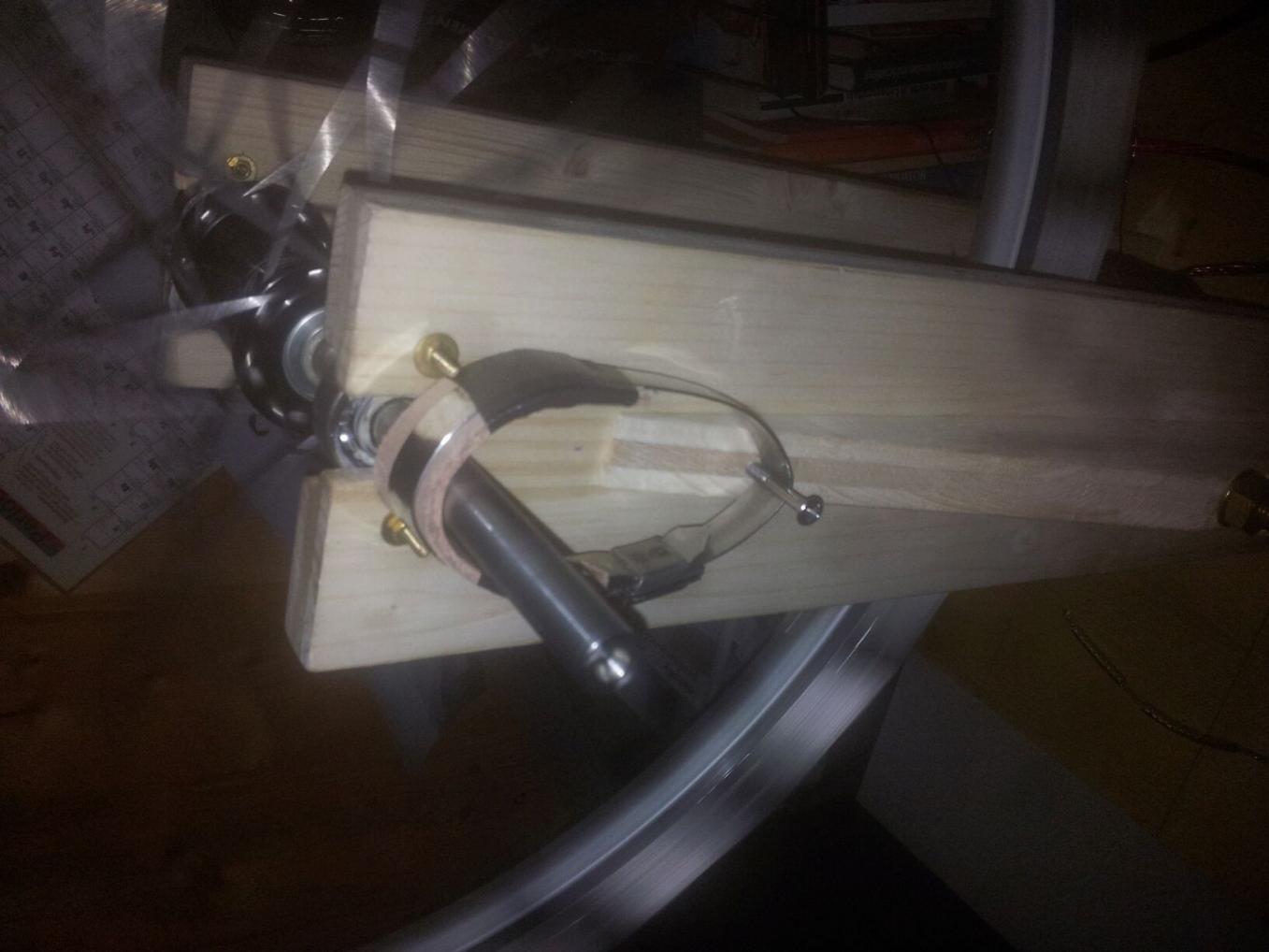

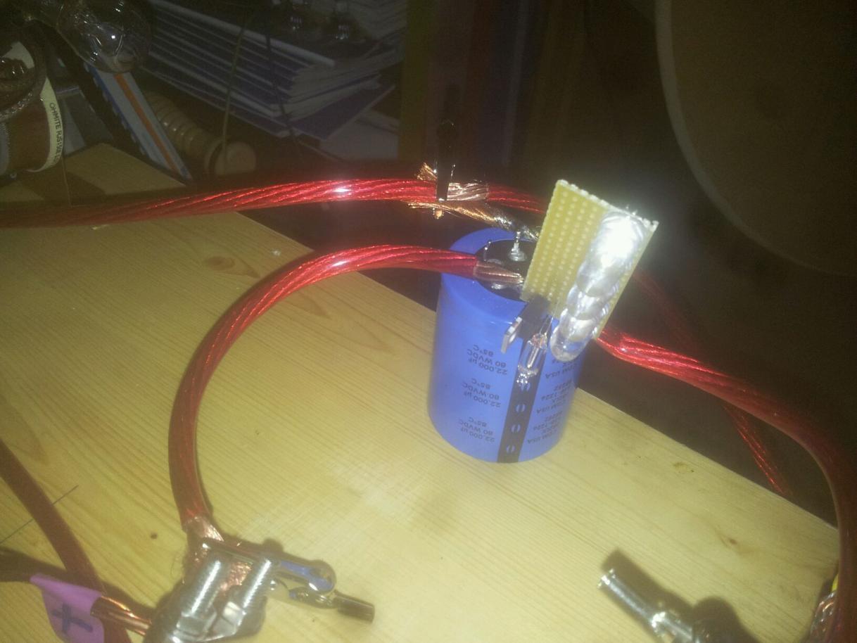

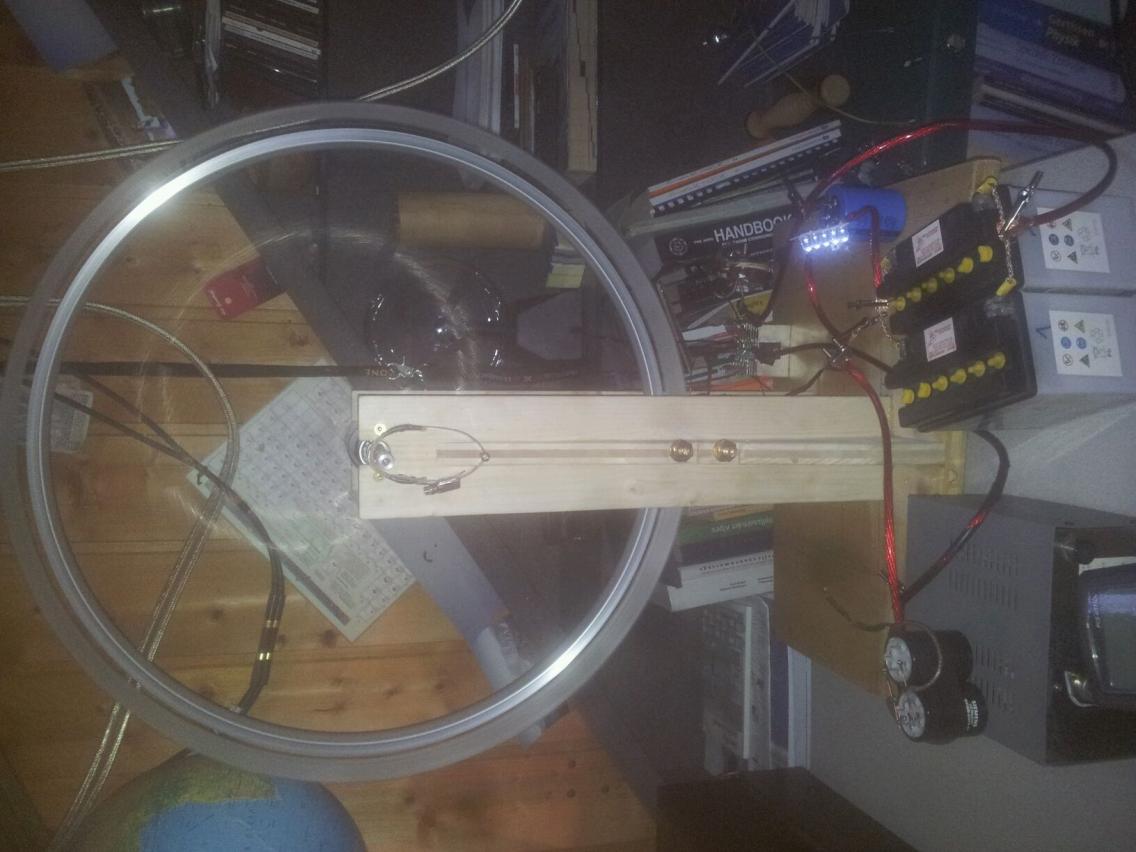

                        Hi Forelle,
                        that's an interesting use/positioning of the LED's. Nice job on the pulley system.
                        so what's going on different w/ the charging of the cap when you place a load on the wheel with your setup?
                        Thanks for sharing that, will give it a try...
                        • #27

                          Hi min2oly,
                          i am not sure what the difference is.Please can you tell me exactly what and how i should measure.The cap goes down from 25v to the batteryvoltage with and without the resistance but without resistance it doesn't switch off.Gatetriggercurent Bt152 is 3-32ma maybe a bigger one would work without resistance.If you want scopeshoots tell me from where.
                          Have a nice day.
                          Oliver

                            Hi Oliver,
                            That is very nice how you have it set up, simple and sweet. 3-32mA might be a bit much for a small build, but perhaps that current is not being used up???
                            sometimes these switches can pass the current on to the charge battery.
                            Slider also mentioned using a resistor there, this is how he controls, makes sure, the switch turns off and does not lock up. I would not change a thing as long as it's working efficiently, If you are just wanting to experiment, it's always fun to build another, pop it in and compare the two.
                            -KR
                            Patrick
