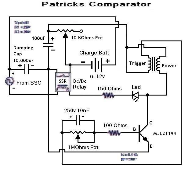

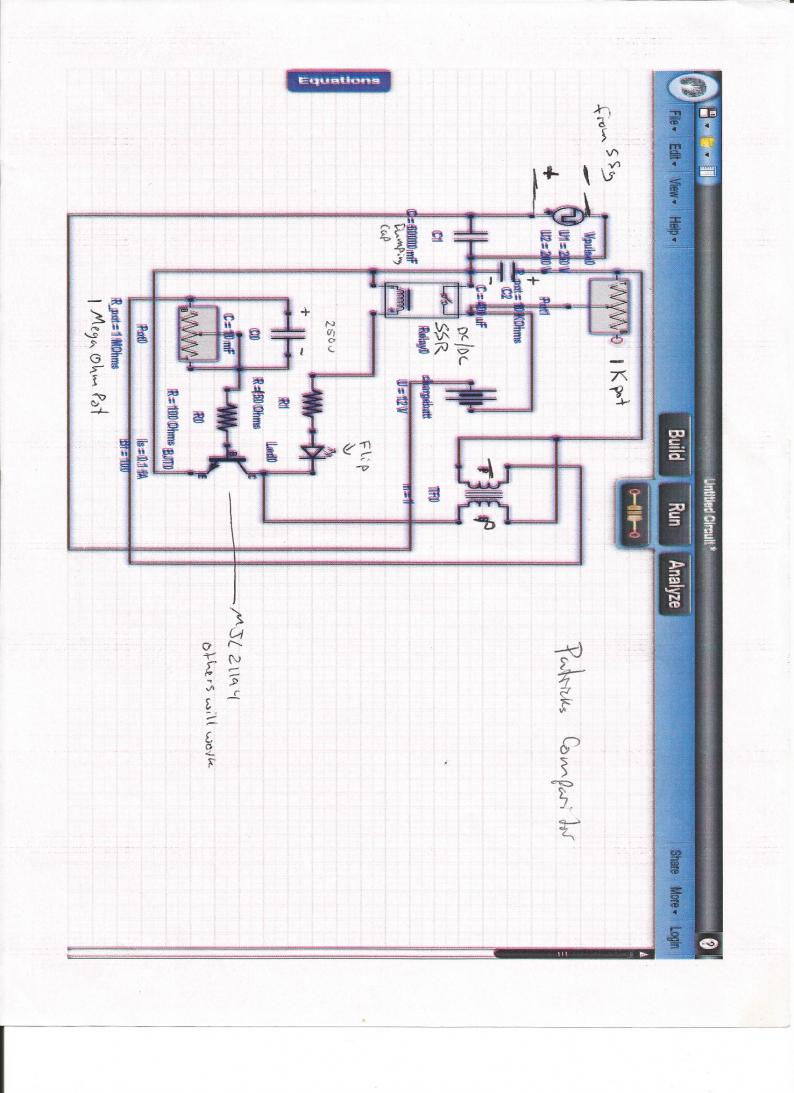

Ed,
You are close. I see I made a mistake too when I was looking at it. I use a 100K pot on the top instead of 10k. For the dumping cap I would have 10,000 uf as a minimum, depending on the size of your machine. For the cap across the mega ohm pot I have a 10 uf not a 10 nf. And last Connect the ssg negative to the emitter, top left of SSR and bottom left of SSR. You have no "dot" at that junction in your schematic. Fix those, post again and I can take mine down as yours will be better
Aln
Looks Good Ed. I think I had a 35v 220uf cap on the one where you have 100uf too, not that it matters much there. The voltage is low. Good work and good luck, look forward to your build.
Aln
P.S. Don't go too cheap on the SSR or you will have to buy another after you push the cap dump to do some hard work.Last edited by aln; 03-01-2014, 12:54 PM.

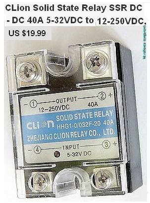

Read post #264, pat uses Douglas Randall K08A. Mine is only rated for 40v at 12A on top and 3-32v on bottom to trigger switch, but it is working good so far. I had a Chinese one rated for 110v at 25A on top, 3-32v on bottom and I killed it. Remember DC/DC. I have 2 AC/DC ones that work about the same as my dead DC/DC one
Looks like it will work, where is it made? ZHEJIANG looks Chinese to me. Not all Chinese is bad, I just haven't found the good stuff yet
. It looks better than the one I killed. And the one I bought was only $10 on amazon. I bought the Douglas Randall on ebay used for $15. Aln
