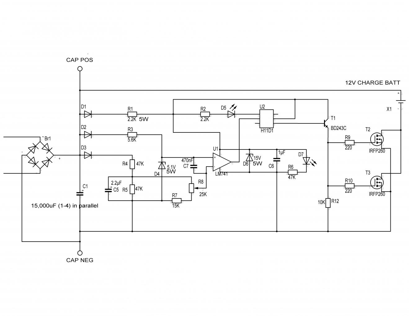

I've etched another version of the comparator and it is working well.
I've attached the cct.
I've got a new 16 bike rim with a shaft that rotates installed.
21 mags, alloy rim.
I'm surprised at the speed. almost double what my 16 inch plastic wheel was doing.
I'm running a 7 pwr strand SSG with 470ohm base resistors and matched components.
12ohm resistor in triiger circuit. 3/8 inch gap and the thing flies. 440rpm @ 12.5v input.
It needs at little more current to tune so I'll probobly widen the gap to bring it to 1 amp and no additional resistance.
I'm ready to hook up #6 AWG connections in and out, also between the ssg cct and the comparator cct (in and out of bridge)
be talkin',
bro d

Thank you for posting the circuit. I appreciate it.
Some time back, I experimented with cap pulsers on my big wheel and coil. (5' dia. wheel, 117 strand #22 ga wire)
I tried several values of caps and dumped via SCR into 3k to 10k AH of LABs.
The wave forms were nice, but I ended up burning holes in the magnets on the wheel. (Yup, a magnetic null zone the width of the iron core of the coil.)
After replacing the magnets, I ran the thing straight SG style.
After tripping and falling into the transistor board, which smoked all the base resistors, I've been using 55 transistors and have two strands connected to each. Running this setup solid state. (Can't afford to ruin any more magnets!)
Pulses come from a 555 timer driven PWM circuit. This biases a MJL21194 which passes voltage to the Base of the 55 load transistors. Current is hefty until the pulse width is narrowed way down. I'm working on a LM339 based PWM, (Bob French's), to replace the 555 circuit with and hope to have it next week.
I've been toying with the idea of rewinding the large coil as an air core and see how that plays. A lot of work, though.
JB's SG3524 based circuit has given me good results when driven by a small, 5 strand, SSG. The dump here is frequency based rather than voltage based though.
I will build the circuits posted on this thread and see how they act dumping into 12, 24, 36, and 48 volts.
Thanks again,
glen

Glsd you got the cct.
The comparator cct is neat in that you can set the pulse voltage and vary the input and still get the pulse at the same voltage.
If you increase the input it will pulse faster.
When you add capacitance it will take longer to fill the caps upto the set voltage but you will get mor amperage in the pulse.
I'm trying to get 1 to 1 charging with a bike wheel according to JB's specific instructions and then I will proceed to building multicoilers again.
You smoked mags? WILD!!! What did it smell like?
bro d

Thanks Patrick for your response.
I've got to have better understanding of the comparator cct before continuing with it.
The charge rate is poor.
The gen coil plan in addition to the comparator yielded even worse results.
Radiant charging a batt works well and I'll see what I can get by charging 2 @24v with one @12v.
I'm using the 2A12 to charge the run batt. I'll do 2 in parallel to stay in the C-20 range.
I need to understand the function of the different components in the Ron Chase comparator cct or maybe go with RS's. He has good understanding of his.
Thanks again,
bro d
