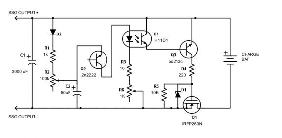

Hi Alvaro,
a 2n2222 would be the minimum size transistor... A BD243C would be better......
yes, a diode from the pos rail to R1 should help....
