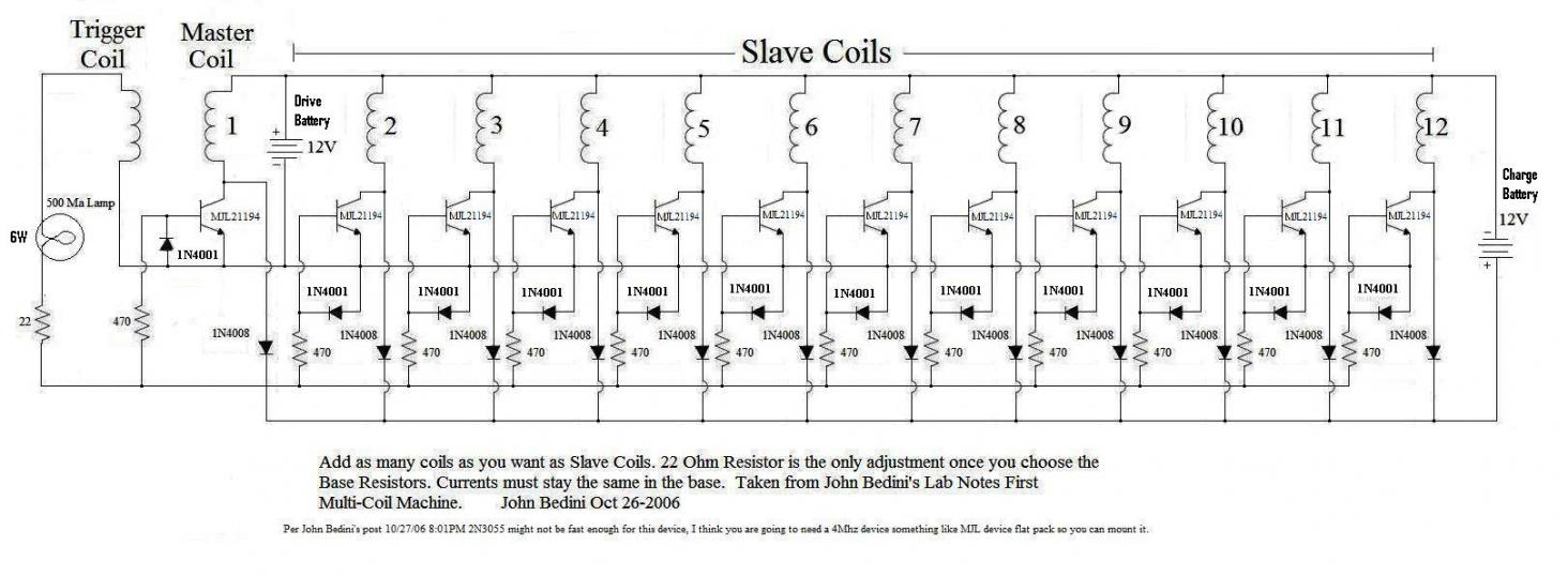

        hello tom and thanks for the replay i found this diagram and i think this is what you mean when you talk about the other rest of the coils sharing the same trigger winding.... but this coils are standing alone ?? i mean this slaves coils they can be winded separetly and made by one or more windings and only sharing the trigger on the master coil ?? thanks for youir patient Click image for larger version

              the coil is usually a multifilar coil, all the strands on one spool, and yes that is the multi filar coil diagram we are used to seeing.
