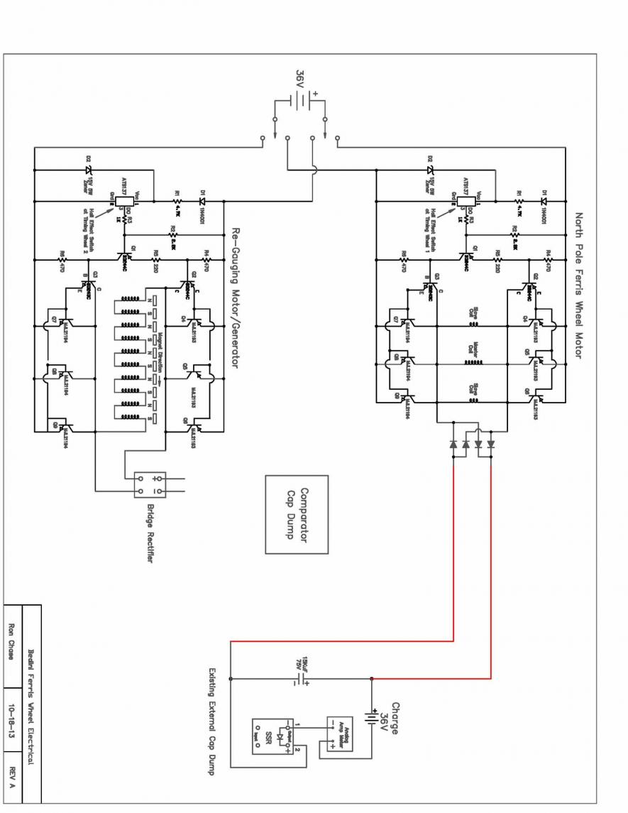

Name:	Ferris Wheel Electrical.jpg
                Here's an incomplete schematic that shows the Bedini/Cole switch as used on the Ferris Wheel. Its set up for 36V input.
                Ron
                Sorry this picture is not good when viewed on the forum. I have it in pdf if you need it.
                Ron
                • #83
                  Hi Ron,
                  I'd love the PDF.
                  I can resize and upload for everyone [email protected]
                  I think JB's post was for those (John K.) who might be having a go at sizing "down" to get started. I also think it was intended for 36 volts??? He did say at the time it will be difficult to size down and get the same effects, he also said he would have liked to make his BIGGER! ouch :-)
                  KR,
                  Patrick A.
                  Originally posted by Ron Chase View Post
                  [ATTACH=CONFIG]3706[/ATTACH]Patrick,
                  Ron
                  Ron

                              Hi Ron,
                              Thanks!
                              I think this is readable. LMK anyone, if you have problems.
                              Ron, might i add - That's some NICE work you've done there pulling it all together.
                              KR,
                              Patrick

                                Thank you and Ron Chase for the schematic. I find it readable.
