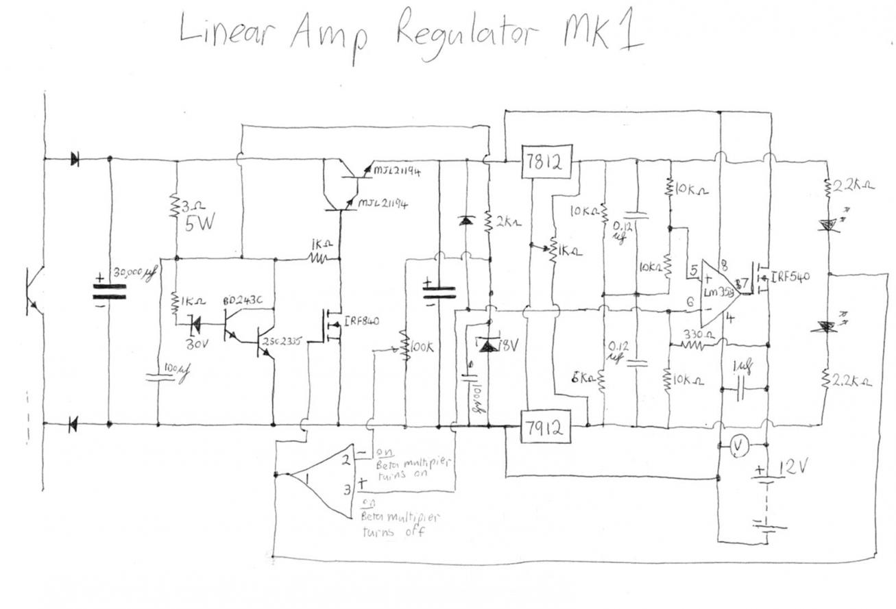

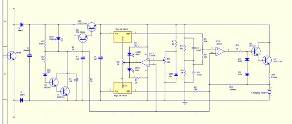

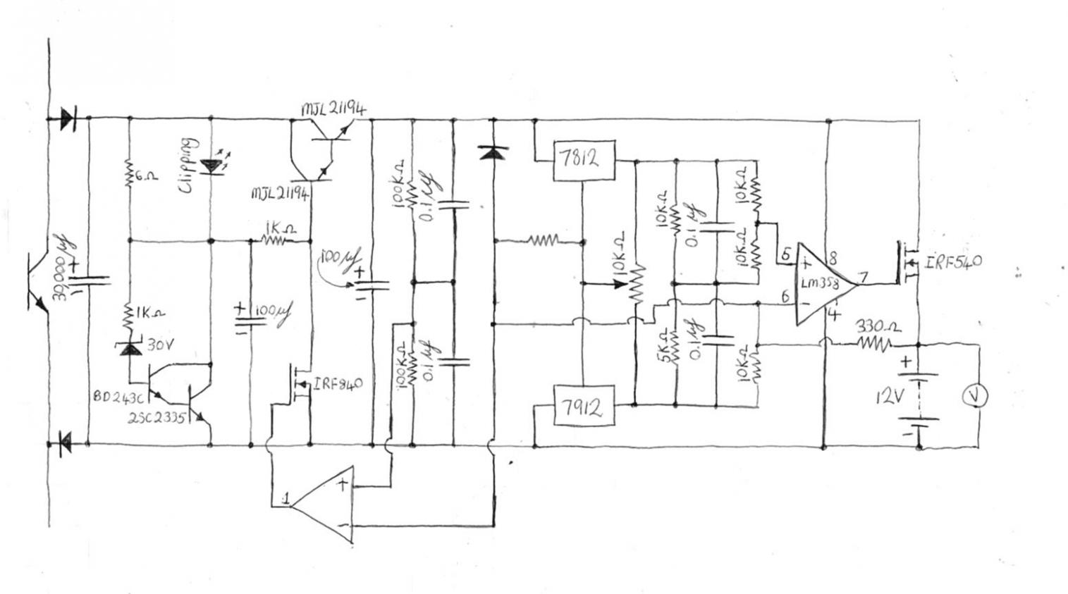

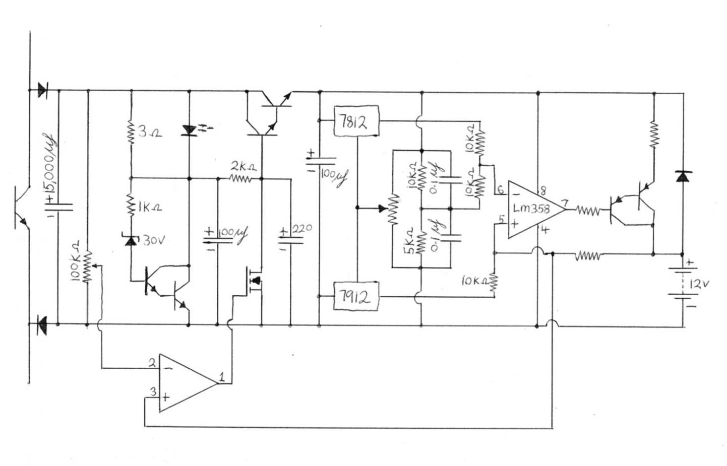

    The Previous Circuits, before I came here
    Someone requested if I could post my Previous circuit designs of the "linear Amp Regulator" That I designed before I came to this forum. It may help someone to get some circuit design ideas.
Name:	Linear Amp Reg4.jpg
ID:	46691Click image for larger version
Name:	Linear Amp Reg1.jpg
ID:	46692Click image for larger version
Name:	Linear Amp Reg2.jpg
ID:	46693Click image for larger version
Name:	Linear Amp Reg3.jpg
    But now I have a new circuit that I will post soon.

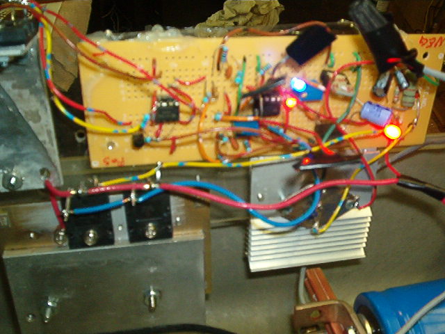

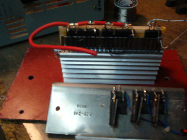

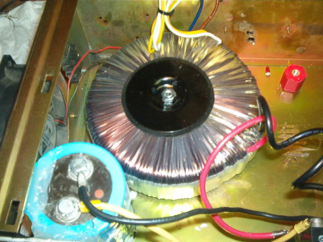

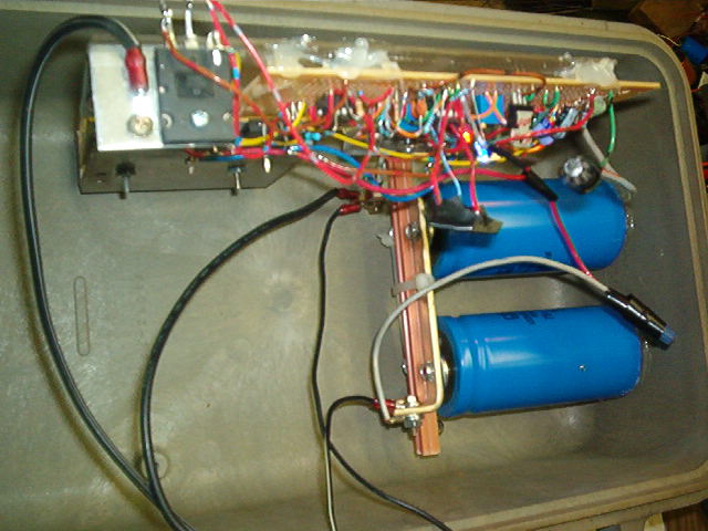

        Linear Amp build
        Greetings:

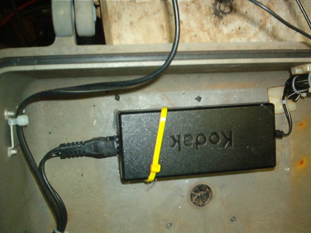

        I have an 'up and running' version of the Linear Current Amplifier.
        A 2n3055 was used to power it on and two MJL21194s were used as Q1 & Q2, while a NTE37 is on the output.
        The whole thing is powered by a Kodak printer power supply providing 36VDC @ 2100 mA.
        This thing is pretty neat!
        I appreciate you folks sharing this.
        Right now, I'm working on a scaled up build using a transformer from a UPS, 60 Amp bridge from somewhere, a 51000 mFd cap, and several MJLs of both flavors.
        Pics attached.
        glen

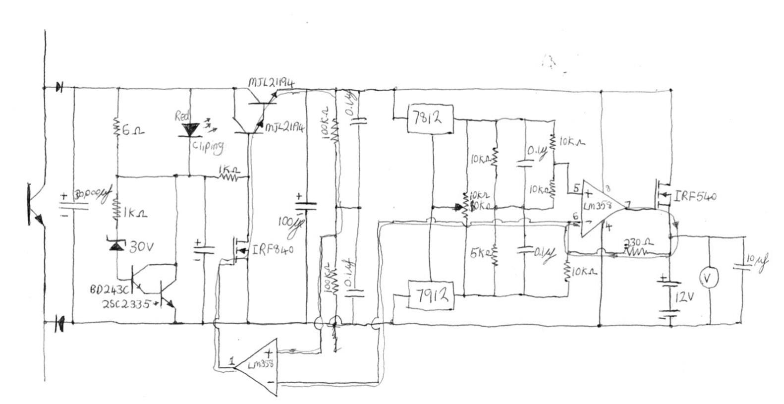

              Hello everyone,
              I wanted to ask a question,.
              I replicated Nitesh Schema,exactly this Click image for larger version
Name:	linear regulator.jpg
ID:	48821- as far I can see it seem's to work, i use a 30V 5A power supply, to test the circuit and tune/balance the voltages,but as I understand,LEDs should't both light up while the voltage on the battery does not reach (let's say 15v) that we determine with the RV1,but my two LEDs are constant light, independent of the battery voltage 12v or 16v,no matter how I adjust RV1, both two LEDs are always bright...
              My question is
              Perhaps I misunderstood something, maybe LEDs must light up simultaneously, or I miss something, please help me if you can
              THANKS
              excuse my bad English

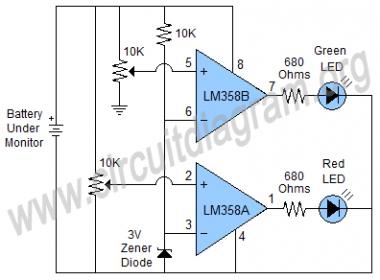

                the battery monitor part

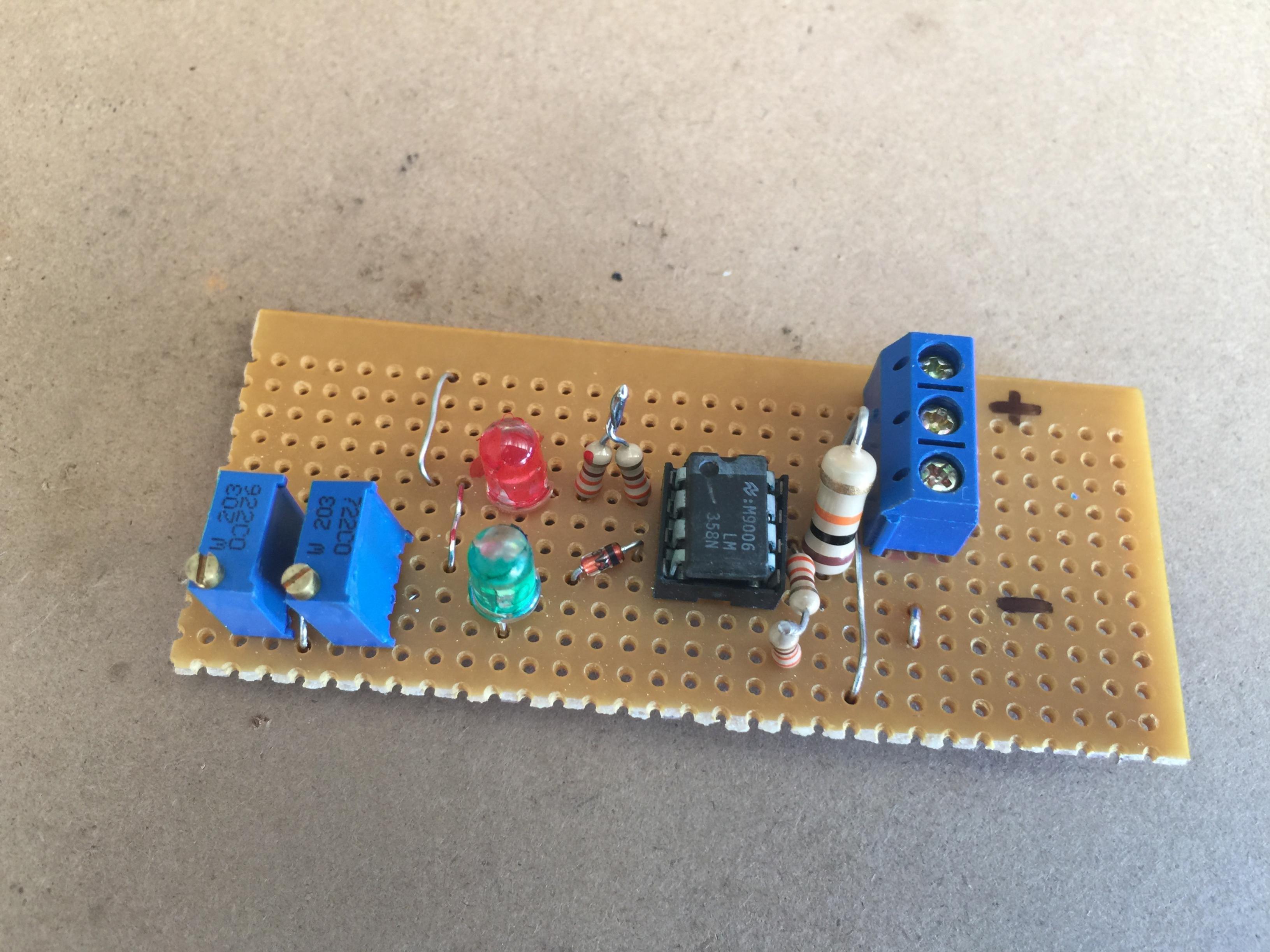

                hey everyone,
                i just built the battery monitor part of the linear reg amp, ignore the marked + and - on the board because i did, i connected it up and popped the ic on reverse polarity straight up lol luckily for me i had a ic holder in so i could easily change it out.
                the circuit isnt my own i found it on the net and works like the bedini video, i set the red led to be on by itself up until 14.7 ish and then the green to turn on at that same voltage and up, the red goes out and the green comes on and if the circuit is left on you can watch the led's swap back again as it goes back down and around 14.7v they swap back. i think in bedini's awesome dvd i bought there was only 1 pot to move to change this voltage changeover point but it does the same job and without watching the dvd i probably wouldnt have made the circuit so a shout out for bedini u are awesome and also the circuit online i posted because its not mine im sure that person should get credit for the circuit too.
                i tried another circuit with only one op amp and the 2x leds were against each other but i couldnt get the leds to swap over they were both on for some reason, looking back i probably should have had a 680ohm resistor in line with each of them and it might have worked, i have the board still ill find it and post it too with the circuit i made it from to see where i went wrong

                  if you watch Mr Bedini video he only used one op amp. what we were doing way back then was trying to come up with how John did it. Nitesh added some more bells and whistles but tried to follow how John did it.
                  I bread boarded the comparator part on the charge state of the battery.
                  It does have an issue in the Schematic as drawn.
                  it works fine if you don't connect it to the VR (adjusting the Regulators) but now what to do with the VR. Maybe a resistor to ground?
                  Or go with your idea and use 2 op amps

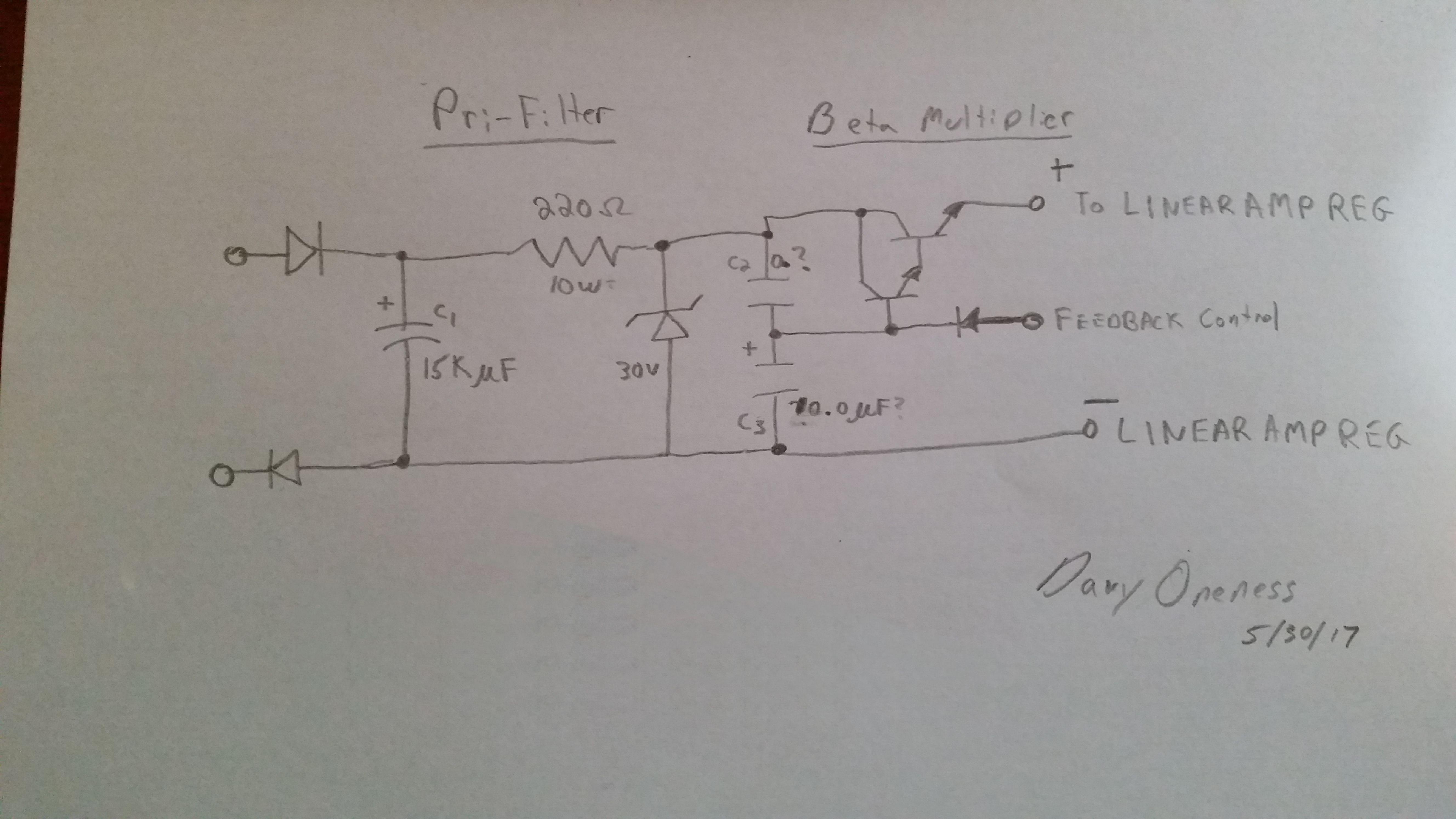

                    Thought I would share where I was at with this so far. Been studying the DVD video close, and what I came up for the beta multiplier stage so far is different than what I have been seeing everywhere else. This is what I am seeing over all on the board though, two linear reg packages, one controlling the amp and beta multiplier, and the other is just the power supply (probably 5v) for the comparator IC and LEDs which is powered off the charging battery. In my drawing, c2 is small and c3 is large, forming a voltage divider(but also it is another filter stage) to start the beta multiplier feeding the regulator when the SG is running. My thought is it just barely turns on the multiplier, and the linear regulator feedback punches it when needed. This isn't tested yet, as I haven't figured out all of the component values to start with yet :
Name:	bedini beta multiplier stage.jpg
                    Also, please note, the only way you will know if you have it all figured out, is if you test it with a radiant input and only see almost perfect dc on the output, with little to no ripple.
