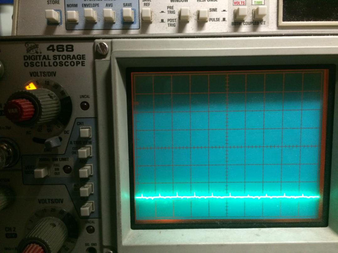

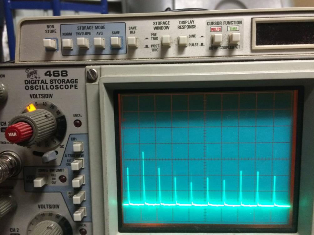

        SCHOTTKY DIODES
        I had a play with Schottky diodes in preference with regular 1n4007's. Looking at the waveforms. The regular diodes let through some residual ripple voltage which surprised me. When I switched in the Schottky diodes the resulting waveform was far more crisp in its cut off an preserved more of the fine radiant spikes and at a greater magnitude. I would love to see these fitted to all the outputs on my sg. The downside is a slip up that caused the neons to go on would likely burn up the diodes as well. They tend to not have a high voltage tolerance. The item of interest is that faster diodes have something to contribute to improving outcomes. I think Bro Mikey mentioned this in another thread!
ID:	45952Click image for larger version

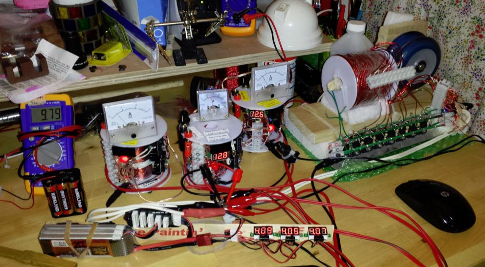

                  See my babies. Click image for larger version
Name:	Rotor and Solid State Ganged - Wards Custom SS Spool Design.jpg
