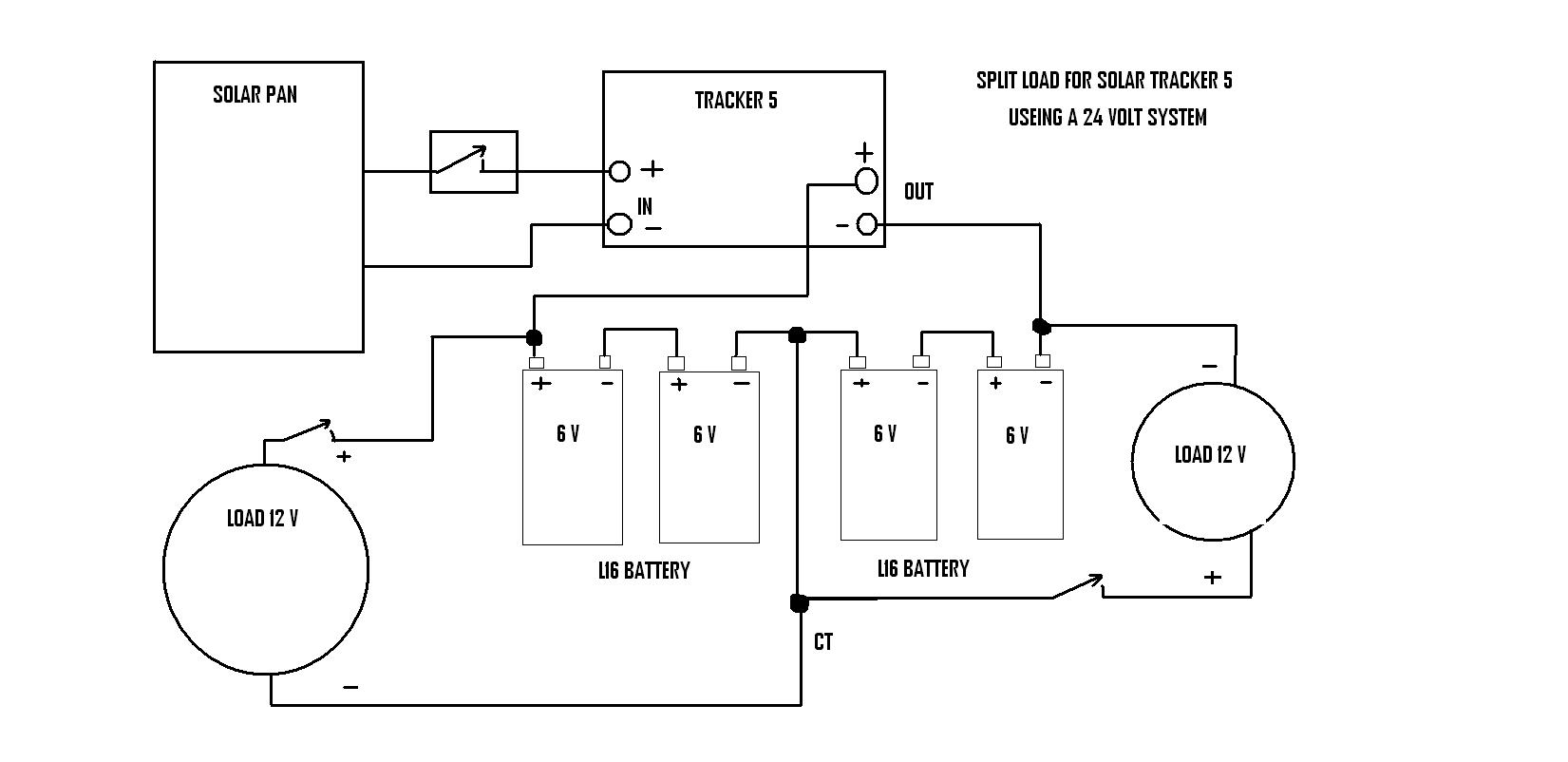

Branch,
its a tracker 5, that is all they are building now. its a linear regulated amp so as your inverter or whatever device pulls a load the current is diverted from the battery. when the load exceeds the batteries charge needs the battery begins to supply what the tracker cannot. the charging is not paused because of anything in the tracker, its just a matter of the load. you put your loads right on the trackers output posts.
