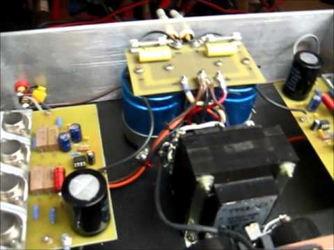

          Those asking questions on the Linear Amplifier for Audio must wait as they use a special linear device which is in a special TO 3 case and some things about it when mounting it is critical along with the layout. Feedback is very important along with the Nobel networks for speaker protection. The cost to make this device is very high because of the heat sinks I will see if I can get a video up tonight, I must clean up the bench as I have been just crammed with work on the new 3 amp charger, but I'm trying to reduce it in size even more, I'm even thinking about making a Hybrid Module, resistors are the limitations along with the heat generated if not mounted correctly, this would be a discreet device. My etching machines can only go down so small. I would like to get it in a two by two square.
          The Video of the amplifier will not do it justice because of the sound on my camera, But will give it a try. You will find this type of Class A Amplifier is amplified in current and therefore has no bandwidth limitations all the way to 1Mhz flat. The limitation being in the voltage divider networks as you can not exceed the regulator voltage input. Two of us manufactures in the 60's built the amplifiers one being Electro Research, John Iverson and Bedini Electronics Inc. They were used with Klipschorn speaker systems and Electro-voice systems and would out do the tube single ended triode class A's. The front end or voltage gain of the amp was using a wide band integrated circuit similar to the LF 411. RCA had wide band video amps in metal cans then. The power level was not important as it was found that Amplifiers were running at just one third of the power level. so haveing 4 to 5 watts was very loud with the speakers used.
          Today we have plastic chips that if you can take the heat away work real good. In the video look at the size of the heat sinks, this amp heat wise runs at 85c so it is very warm to the touch and must be well ventilated. It is a heat fin design. The solar tracker 5 uses much more current so it is necessary to forced air cooled as it uses more devices, resistors are important as they must be wire wound 1 per-cent.

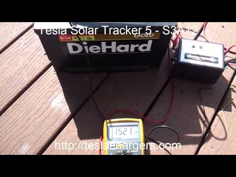

            John asked me to post this in this thread so you can see the S3A12 push big car batteries to the top:
            The first battery, I didn't show the charging just the end, but the voltage jumped up, then dropped, and repeated and finally went straight up...the drops show the sulphation going back into solution repairing itself.
            The second battery, I showed putting the charger straight to the battery and it did NOT jump up to a higher voltage. That shows there are no sulphation issues and it starts to take the amp hours right off the bat.

              linear current amplifier
              The Linear Amplifiers used in this device are no longer in production as we had to do them discreetly in the beginning. The Solar Tracker 5 is just one of the many offshoots of the technology in amplifiers.
              Technology has advanced in how current feedback works in this type of device works
              The Video shows that with the correct arrangement with linear current amplifiers many things are possible as the circuits may be used for a verity of different applications. Using this for solar charging was an idea I had for a very long time. I applied this technology with variations in the Solar Tracker 5 because of the stability in a single ended mode. The feedback of the circuit looks at the impedance of the batteries and then regulates to the proper voltage. In the amplifier the feedback is used to control the gain of the current being modulated. Meter indications in VU are showing the current being modulated within the regulator circuits and that current indicates how loud the amplifier is playing. Clipping level is far above the red indication of the meters that being 3 dB above full power. If the Linear current amplifier exceeds heat levels automatic shutdown will occur and current levels fall automatically to protect the device (thermal shutdown).

                  Fascinating video John.
                  Would it be fair to say that the Tracker 5 is a "Class A" solar charge controller because it is using the same Linear Regulator circuit?
                  If so, would it be possible to make a "stereo" Tracker 5 using one solar panel array and two battery banks as the outputs? (Not sure why anyone would want to do that, just curious if it's possible)
                  • #69
                    factory select parts
                    Faraday88 and John K,
                    First of all let me explain Patents and how they offer no protection. You must be able to enforce the patent and the cost to do this is enormous with federal lawyers in court. People love to steal trade secretes especially the Chinese. This has all occurred since the outsourcing of US products, what you get back is another story. It is much better to keep it in house trade secrets and pot things. You will always find people who think they know how to do it better and understand what you did with the item. I have found to pick devices that are very hard to get so when I see them I buy them all out at thousands at a time. I have seen some of the early devices going for 75 dollars each who would spend that kind of money to try and go into production. As I have said before and has been stated I alter things by building my own networks inside things especially TO 3 devices. The point being made here is I select what I want and use it in many different ways. I have no fear that things will be copied by some, but do they want to go into production with it. If people think that you can just start a business today they have another guess coming in the USA today. You will find that a home work shops will not cut the mustard, and yes you find people who make a living on building things others will not do so home workshops work for small runs. The Tracker 5 circuit looks easy to do but it's not as everything must be calculated and tested and re-tested. at any moment in time I can change anything and I have done that. It just so happens that I have in my early days built many circuits like this and we learn by doing, sometimes calculations do not work so things must be changed to work around the problem. The best solution is to build it like I say in the beginning and then once you understand what I did move on with your ideas and see if it works better, if so you have a winner. With old time analog circuits you could have real problems since it is not really taught anymore. An example would be a old DYNACO solid state amplifier, factory select parts people, good luck. This is the reason manufactures put a factory number on the parts. The engineers are smart when it comes to doing little things so factory secrets work the best. Investors demand patents but when things get rough the rough get going and they wont help you defend it. Also when patents are issued it's at the company's expense, if you say the wrong thing you wont own it and the Government will and you wont talk about it. So maybe you understand why I will keep doing it this way.
                    John K,
                    Yes it is possible to do what your talking about but what makes the two Amplifiers different is the way the feedback works in the circuits, also the devices are much different since bandwidth is important in the Amplifier, now people have made Amplifiers but not at the power level or current I have shown in the video. Not very many could do that with split supply's as balancing is very critical. The front end of the Amplifier using a BI-FET differential that must be adjusted not to oscillate and the Nobel network must be correct for the bandwidth on the output. Normally the Regulator circuit is working with voltage dividers to achieve a ratio, and can not be exceeded with the audio input. The current is fixed and modulations applied to the current through a diff amp, so what your hearing is an amplifier in DC current mode. Two hooked in an arrangement with emitter followers so both regulators are at constant current along with the emitter followers. Audio is swinging between plus and minus to ground. The input signal is determined by the voltage divider, so it's 1/2 the DC level. Doing it that way Bandwidth can be all the way from 0 Hz to 1 Mhz, since you are limited to the voltage dividers maxim output RMS, is only 5 to 6 watts at 8 ohms and almost 12 watts at 4 ohms. In class A it is louder then the normal class AB amp, so it's 1.4 times louder. I would not make a kit out of this as it is to critical to let people do it and adjust it, but a module could be made if wattage was not important as most critical listening is done at low levels. The devices you see in the video are no longer manufactured anywhere so I would move to plastic select devices. Resistors are wire wound for heat as over 1 amp of current is constant across the devices. About 4 amps per channel so heat sinks are large. I made several of these early on for car audio people but it was limited to 5 watts so 2 ohm speakers were used heat sinks again very large and current was constant from the charging system at about 14 volts at 10 amps and protected by output capacitor.
